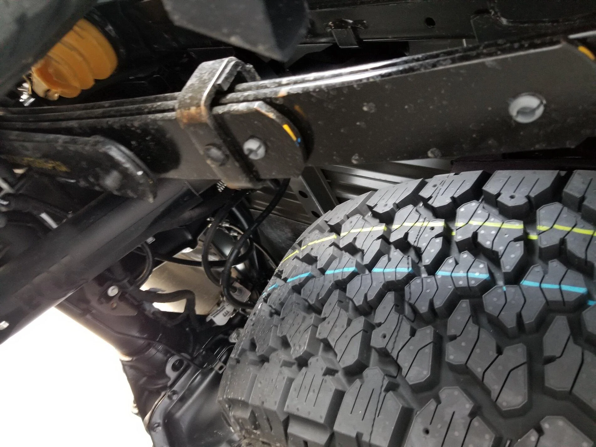

Unlike all other models, Tremor rear springs are a standard multi-leaf design.

That will explain why they have a slight lift over other Rangers. With that said unless you are trying to lift I say keep the factory leafs. After changing shocks huge improvements are made.
