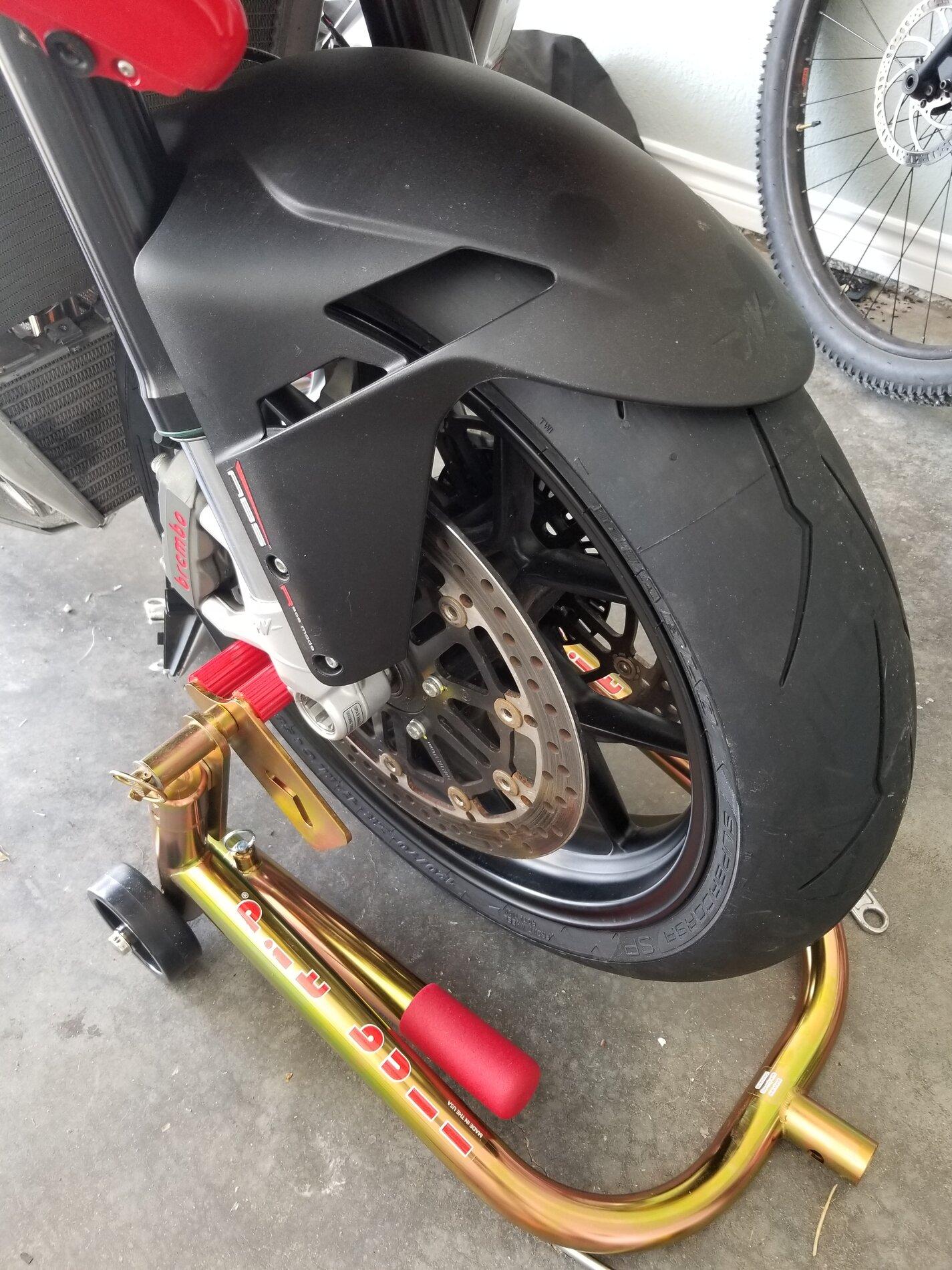

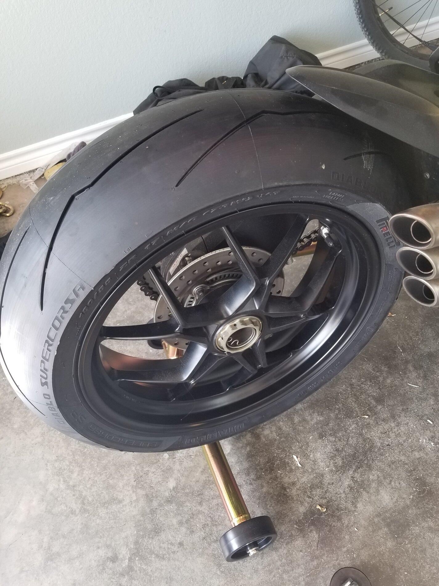

A new pair of tires is one of the most pleasurable ways in life to spend $600...
I almost bought a dragster rr last year ?. Instead I bought another jetski and sunk some money into my z900. Some cartridge upgrades, rear shock/spring but what really set it off were the tires. Same set up your running ?. Much grip= big smile
