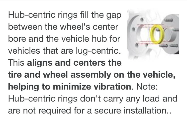

As an older mechanical engineer and amateur machinist (worked thru college in a shop), there is NOTHING better to center your rims than SIX tapered lug nuts torqued into six tapered holes. And if you toleranced the the wheel ID to the hub OD to a tight fit getting the wheel on and off would be a pain.
And I like the note that Discount tire states: Don’t carry any load and not required….

And I like the note that Dscount tire states: Don’t carry any load and not required….
Whatever makes you happy.
That's what I've been saying...77,000+ miles with zero issues...

just remember, even though some rings are plastic....the only purpose is to hold the wheel until the studs are torqued.
they dont need to offer any structural integrity. alignment purpose only.
could form them out of rock candy if you wanted and they melt away first time you wash it
the whole point is to get that wheel centered and true
Correct...6 lugs will provide necessary lug centricity...provided that it is torqued down correctly...off the ground, sequentially a little at a time...it has worked for me in the last 20+ times I've removed/rotated my wheels...
