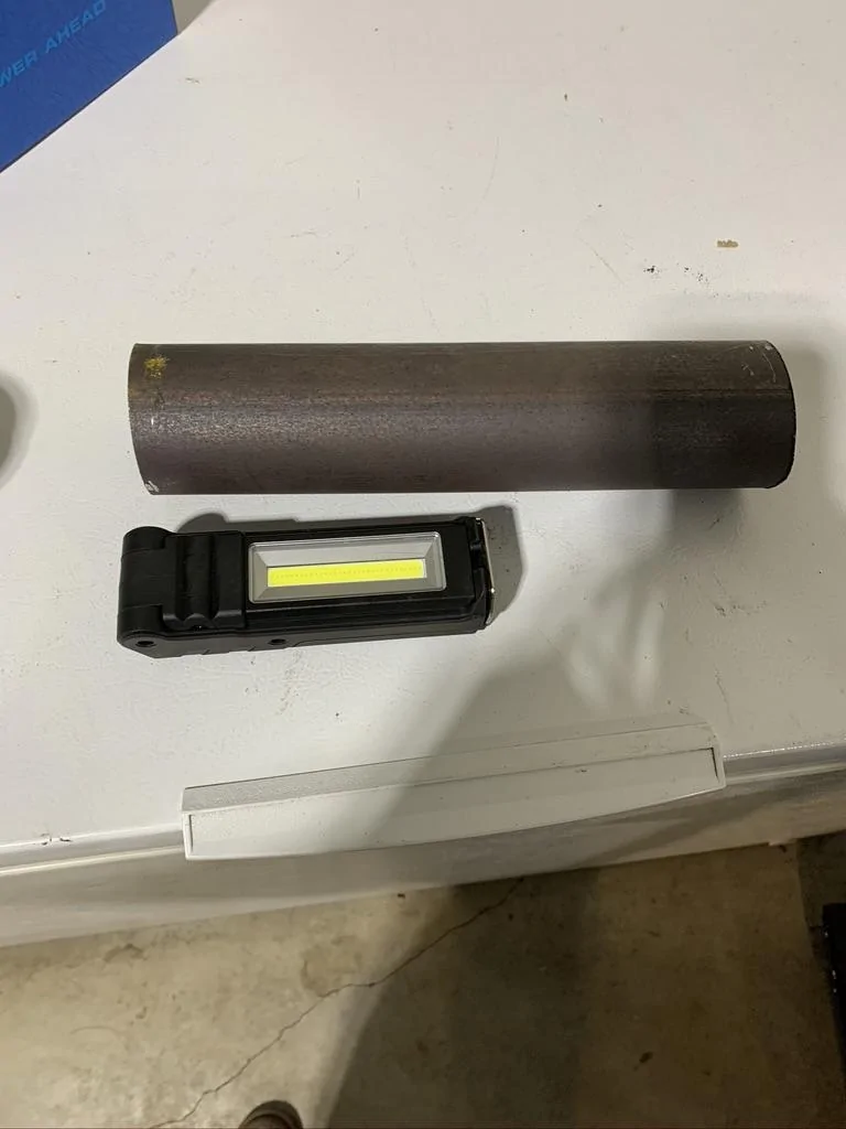

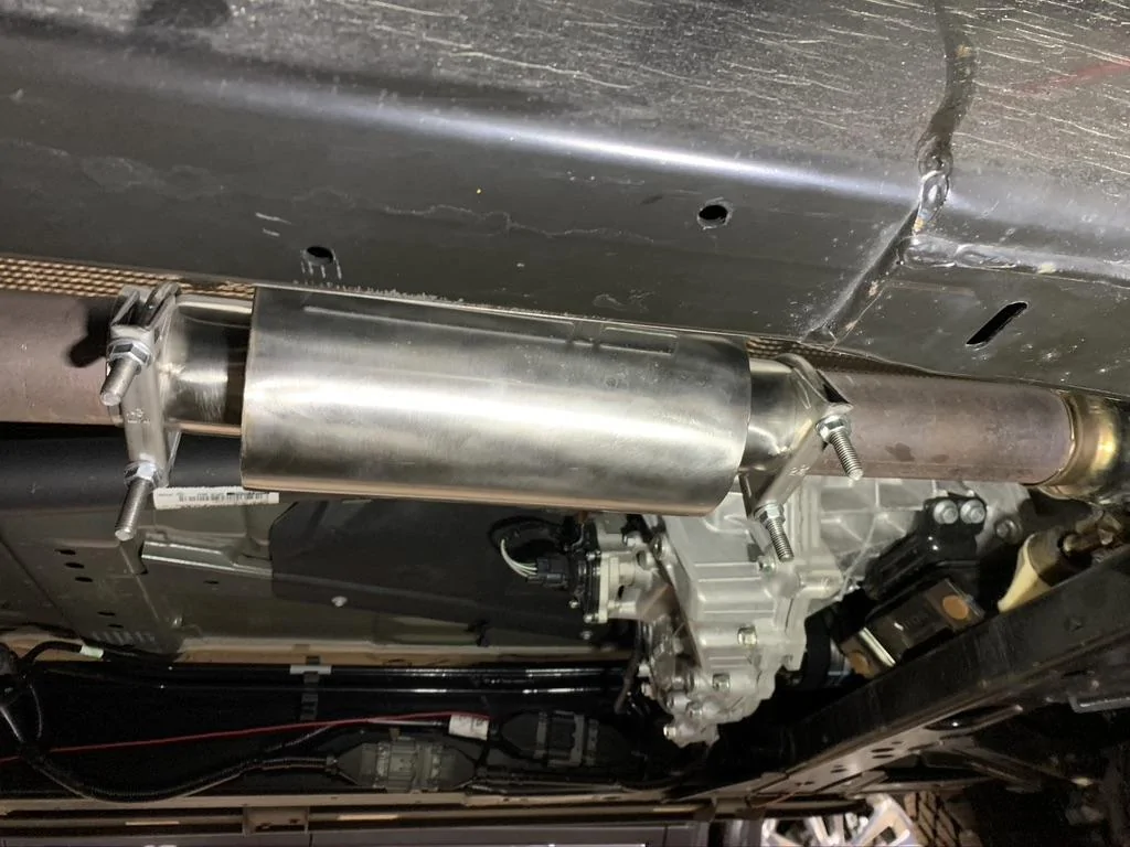

OK, pay attention if you order. I meant to order the one I could clamp on and accidentally ordered the one that is for welding. Knucklehead move there. Anyway, I still clamped it, but had to cut notches into the pipe-ends of the resonator to allow it to compress with the clamps. See https://www.borla.com/products/universal-resonators/ Then you want part # 401338 to weld on or part number 401342 to clamp on. Put it on the pipe between the downpipe and the catback.
The second picture shows how much of the pipe I cut out. I can't remember what the measurement was, but it should be at least the length of the larger resonator section but less than the total length of the whole unit. You need some of the pipe left to clamp on or weld to.
It is a pretty quick job. It just cuts the edge off the sound a bit without sacrificing the power. I called Borla before I put this on and they said it would not affect the power and that you can put as many of those on as you want.
I started with one and it has worked for me. However, I did just install the CR Performance turbo upgrade and it is a bit louder again now. Maybe I will get another. But I'll wait a bit. Note that you want the 2.75 inch to work with the factory pipe. If you want to go with 3 inch, you will need to change the connection to the downpipe.
Let me know if you have any more questions or want a better picture.

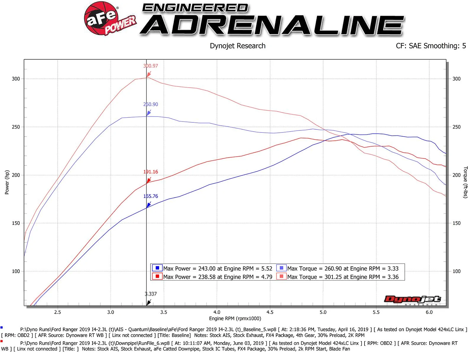

If I am reading this right, the red line is with the aFe DP. I'm seeing a drop in peak hp although it ramps up earlier in the RPM curve, but wow that torque gain is crazy. I suppose with other mods both could arc up a lot.
Clearly a tune would be mandated.
The 'problem' with this mod is that it begs for more extensive/expensive ones - freer flowing exhaust, turbo+intercooler system upgrade... which would mean a bigger throttle body, upgraded injectors and perhaps ignition changes (colder plugs, coil packs). 3 inch diameter from the upgraded turbo to the exhaust tip would be noisy. The saving grace is the under-900 RPM idle, otherwise it's rice.
From what I read from those with the Focus RS build ups, hp in the mid 400's is possible, and the all-important torque could be a real seatback compressor.
You can enjoy a very nice “middle ground” with my set up:
-Livernois tune 93
-Catted SPD downpipe
-aFe charge pipes
-Roush CAI
-Gibson cat back exhaust
The only thing I’d add to my setup is an upgraded Intercooler.
I was talking with another member on here named DevilDog1775 - who sold me his turbo after he had a donor one sent to CRP to become a higher flowing stage 3 turbo. He’s got everything I do, plus the upgraded turbo, plus an upgraded Intercooler and a 5 star tune running an E50 tune.
In his words he feels the truck Is basically a race engine now and pretty much is maxed out in that setup without the changing fuel/ air delivery systems, with his OBD reader is saying he’s making 475hp at the crank (only semi accurate of course, but still).
Doing all that he’s done and then adding a better fuel pump and throttle body is entering a realm where you’d be playing with fire pushing your block into such high boost and HP numbers.
So I’d aim for that middle ground I mentioned if you want to have a bit of fun AND peace of mind you’re not asking the engine to do anything it’s not able to.
