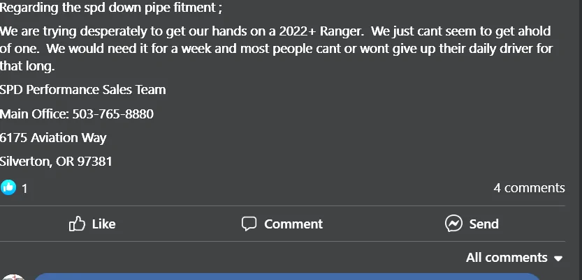

Had this come across in one of the Ranger Facebook Groups today.
I can't verify authenticity so a phone call would be necessary, but for anyone with a 2022+ in the PNW that is able to give up their truck for a week and wants a downpipe, y'all would be doing the rest of us a favor.
As tempted as I am, shipping from CO on my end isn't worth it, and I don't think it would be cost effective for SPD to ship my truck in either.

I'm curious to what is different on the 22. Is the turbo mounted different or what is it?

It's my understanding there was a change in the transmission mount for the 10R80 that conflicts with the routing of the downpipe. That said, I can't confirm or deny if that is true case.
Supposedly something also changed with the flange between the turbo and downpipe as well, but without a side by side comparison, I can't confirm or deny that either
