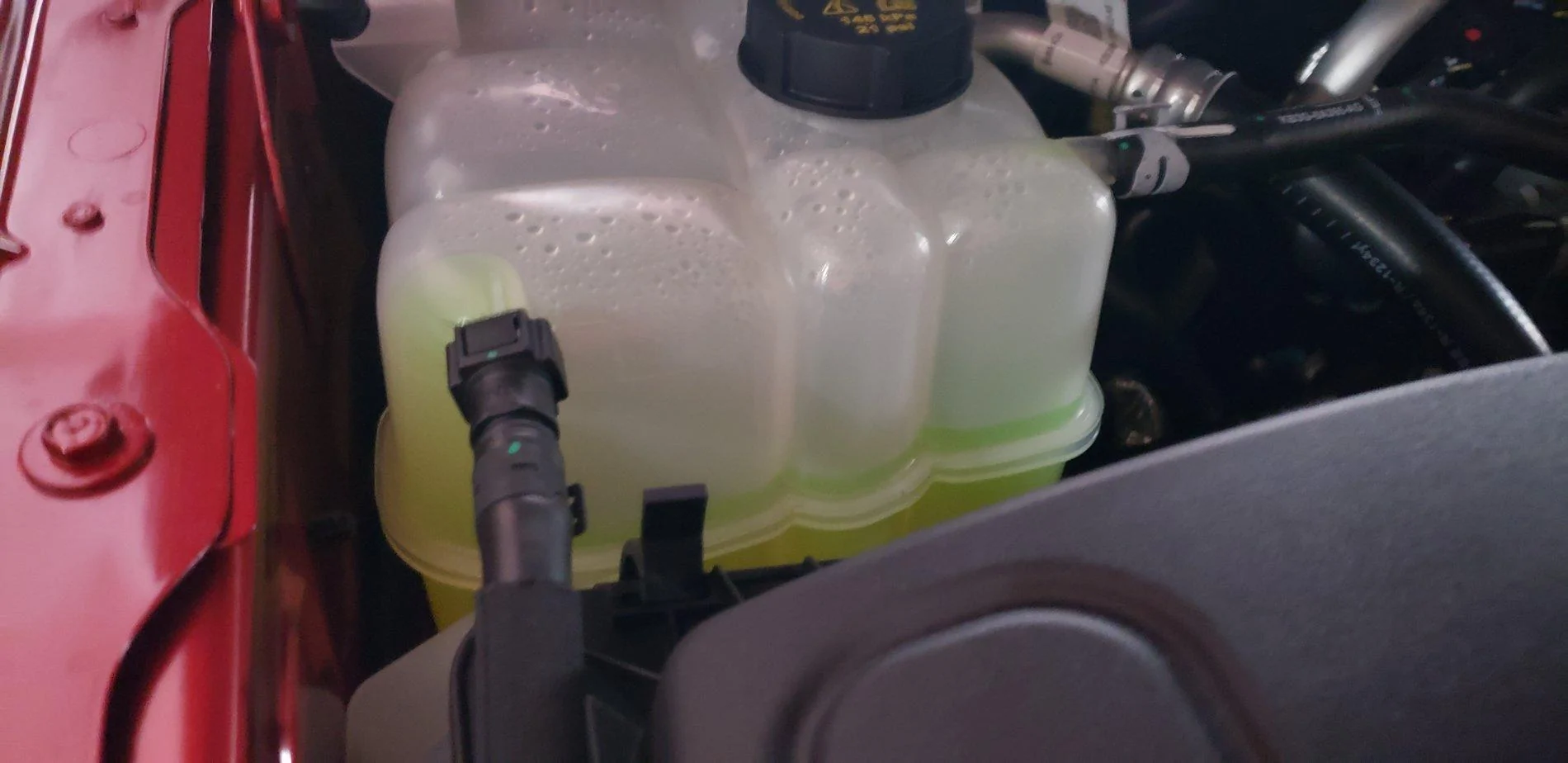

The Motorcraft site cryptically warns not to mix the 2 different color coolants, the actual coolant in the reservoir on my truck kinda looks yellow, in a psychedelic sort of way.
Who would you believe in this situation?
Personally I believe the chart and my eyes more than the asinine manuals...

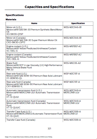

The 3rd printing of the 2019 Owners Manual, dated April 2019, specifies "Orange Coolant".
I included a pdf of the 4th printing below, it is dated June 2019, and it specifies "Yellow Coolant".
___________________________________________________
For our truck... all the stars seem to align:
July 19, 2019 Truck Build Date​
Mello Yello Coolant in the truck​
Owners Manual, version 4, dated June 2019 also specifies yellow coolant.​

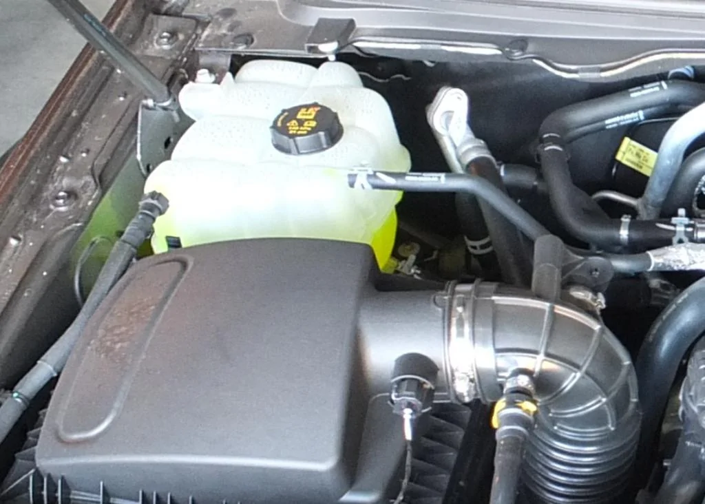

Im bothered that its just called "Yellow". The Orange looks Orange. But the yellow looks greenish. Flourescent green? Chartreuse? Would be more accurate.
Threw me for a loop the first time I opened the hood.

I agree, it resembles Chartreuse more than simply yellow, I'm guessing Ford did not want to confuse it's owners by dyeing it blue (Honda) or Pink/Red (Toyota). I'm just glad it doesn't resemble the color "rust"...lol

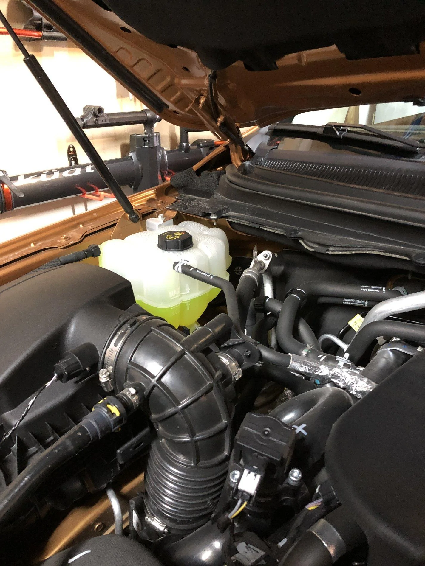

My June built 2020 is Mountain Dew color. Hmmmm . . .
