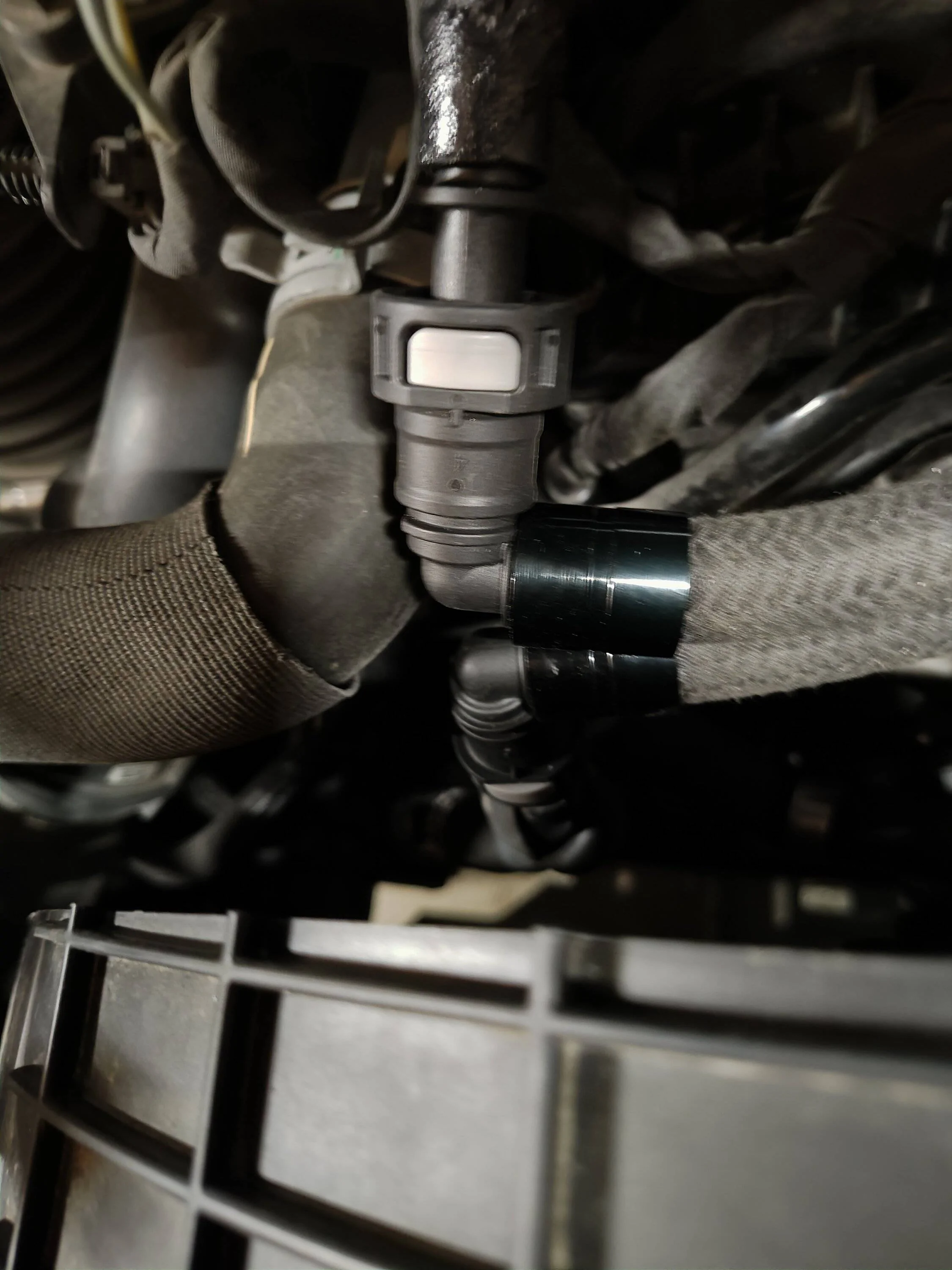

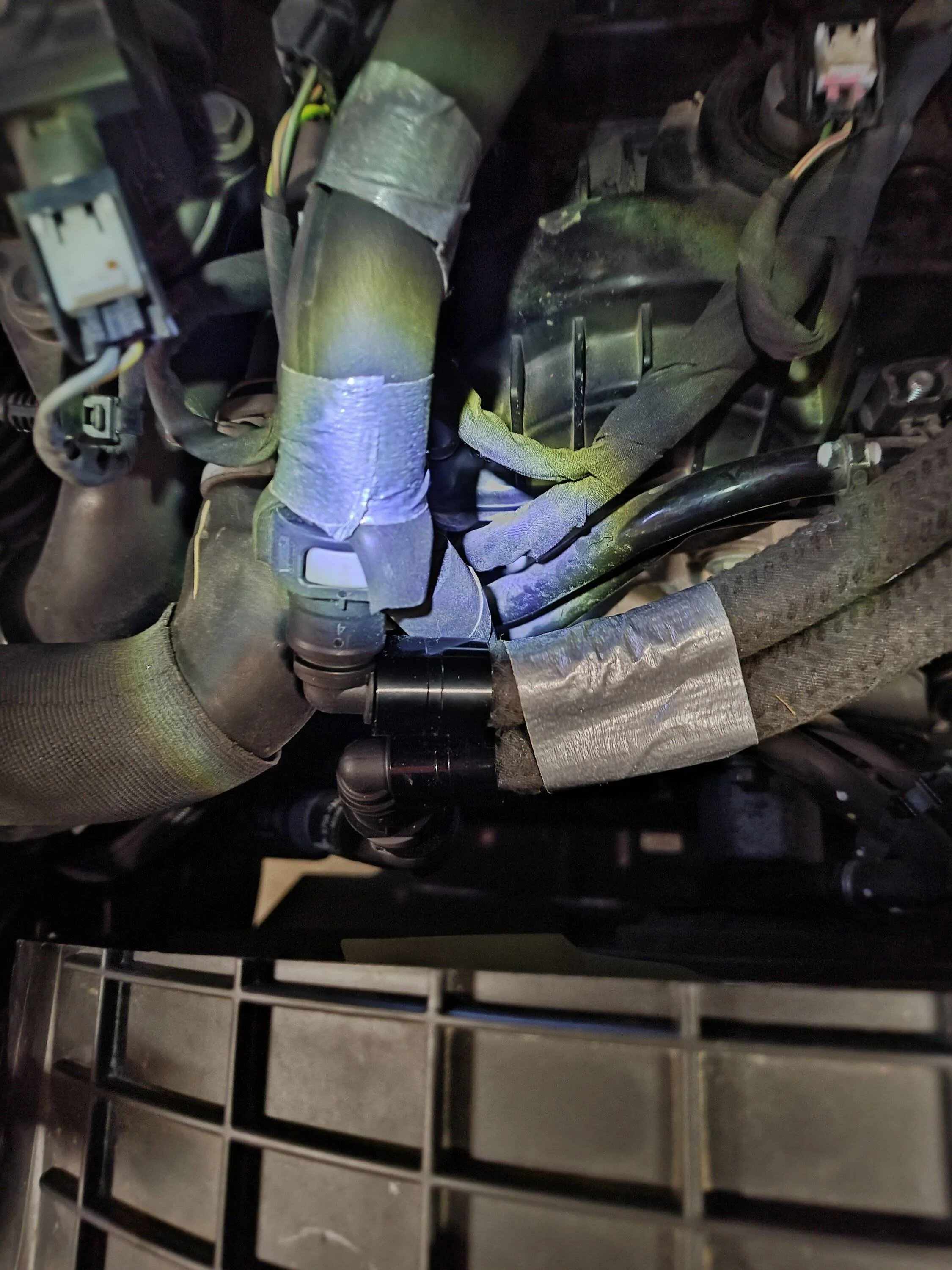

I just installed a UPR Catch Can, but not to the method in their instructions for the 2019 Ranger. This requires removing the driver's wheel and the oil change flap and fishing around in the blind to find two quick disconnects on the PCV hose. There wasn't room for my hand. I bailed after two hrs. I had another two hrs in front of me getting the UPR hoses connected, and I considered that very iffy.
I was ready to pack it up and return it, but I looked at their truly simple install on the new model Rangers, and the install on the Ford Performance can. The can just needs to be plumbed into the vapor flow from the PCV to the intake manifold intake.

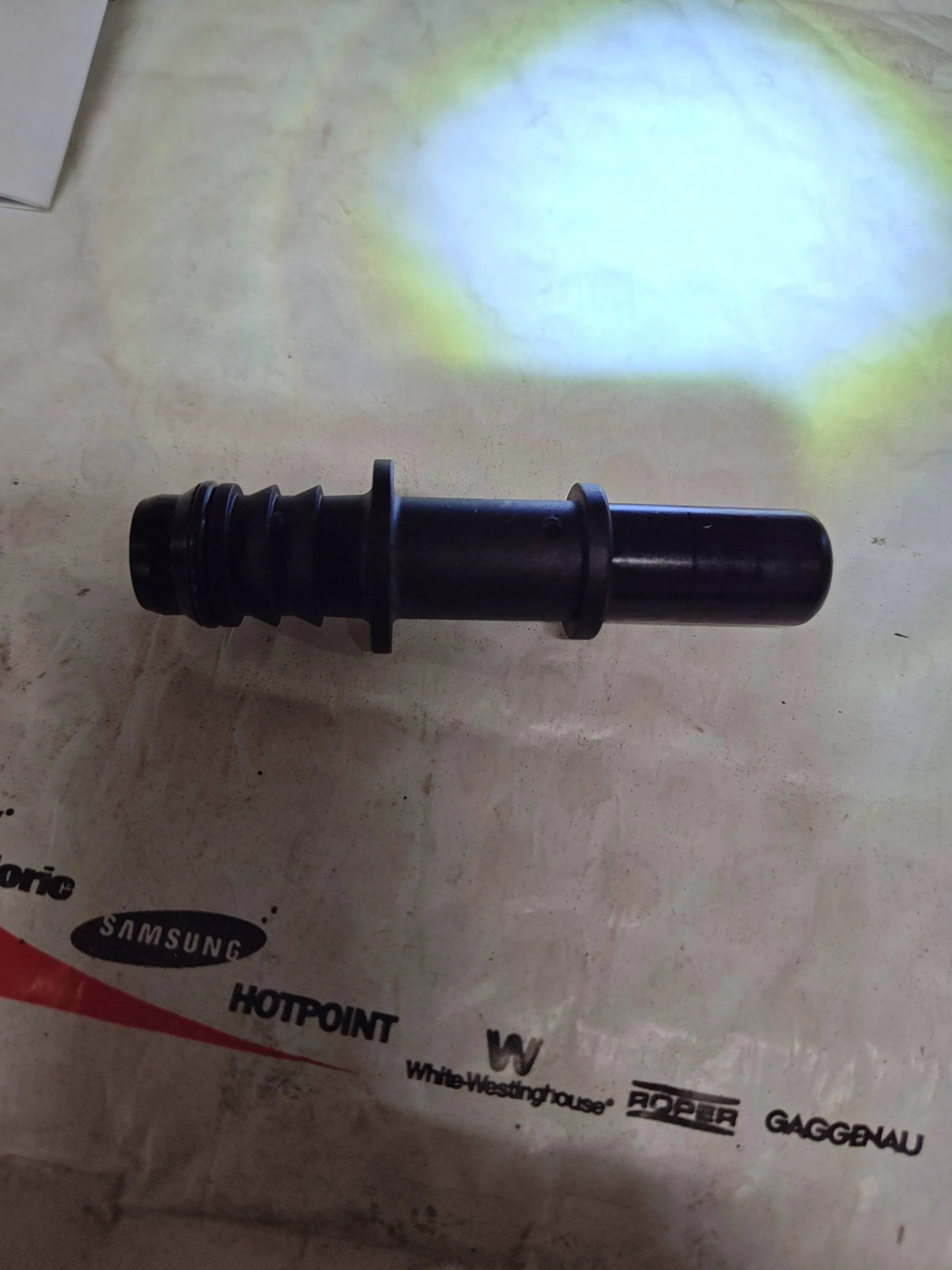

I cut the existing PCV hose and spliced in the UPR hoses using two hose adapters to connect to the UPR quick connects. Two hours tops.
https://www.anhosefittings.com/1-2-hose-barb-to-1-2-12-61-mm-sae-j2044-male-quick-connect.html

UPR advertises their cans as "plug and play", using their quick connect fittings to button up to the factory hose quick connectors.
In theory this would work on my 2019, except I don't know how anyone could access the factory fittings w/o an engine pull. Their instructions had a blurry photo of the general hose mess, with notes that the job had to be done "by feel". I wasn't going to risk disconnecting something I couldn't reconnect.
'22 and on Rangers have the PCV and intake vacuum connectors on top of the engine. ...true plug and play.
I had to cut out a 5.25" section of hard plastic hose and use a heat gun to heat shrink the adapters in place. ...not plug and play, but it worked.
