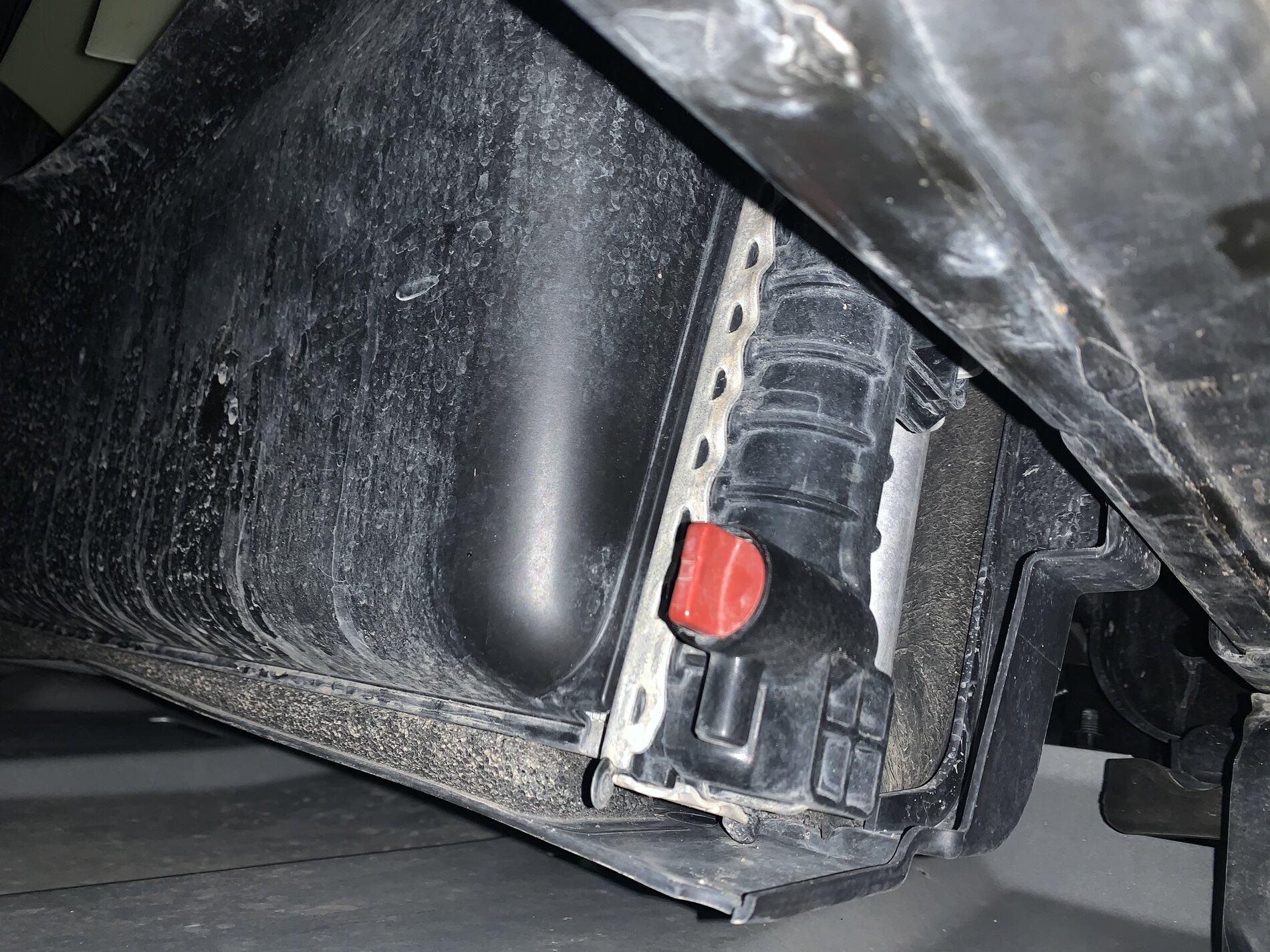

Is this not the radiator/antifreeze drain plug? Thanks might replace orange with yellow.

That is the drain. Unfortunately the only drain...

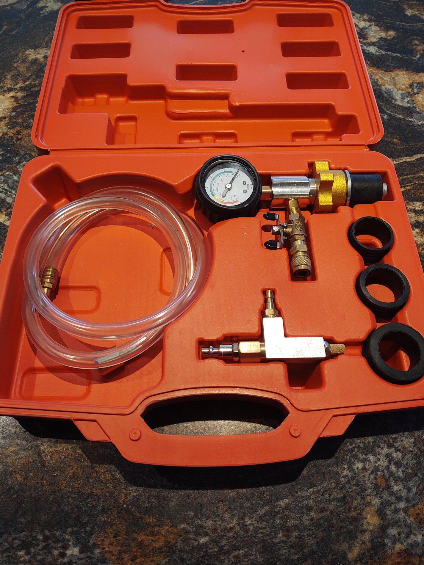

FYI...in case you don't know. Modern vehicles with a pressurized coolant reservoir ...which is all new cars I believe, require a vacuum coolant system device to fully refill the system. I don't remember how much I paid for mine. Web shows $50. ...thinking I paid less. These work great, but require an air compressor for the venturi vac pump.

Thanks for the heads up. Was hoping I could just drain and refill it. Clearly not that easy. Recommend a video for such?

I myself have a Harbor Freight one and it works well. Might not be as much and if you have a local Harbor Freight then you are good to go!!

Oh man, def have Harbor Frieght near me. For tools you'll use very infrequently it's my go to. Thanks for the heads up.

Yes, you need this device. There is no direct way to get coolant back into the system. Just filling the reservoir won't work.
And for the Harbor Freight recommendation : Hell yes! ....don't remember why I didn't buy the vac tool there. But I'm a pretty serious DIYer, and I purchase most of my tools from HF. ...few have failed me, and their prices are low enough that you could buy a second for a spare for less than a single top shelf tool.
