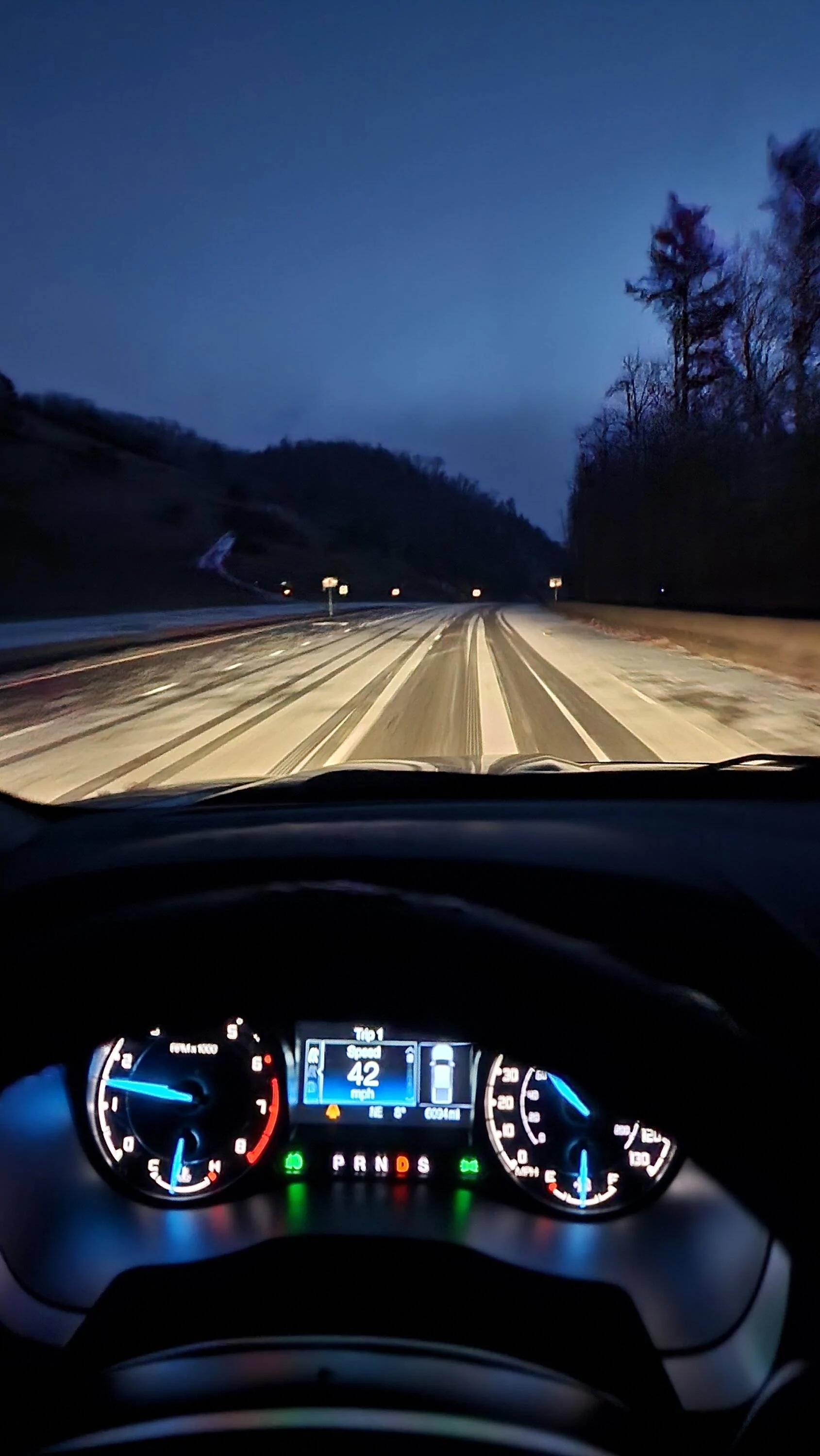

I see you are in NC. I am in TN, so we have similar winter weather. The issue for us is that often as the snow is occurring the temp is dropping fast, so what looks like a wet road under the snow is actually ice. For me, if I begin to feel some slippage then I hit the magic 4x4 button. Just today I used mine for the first time since I bought the truck in March of this year. I used 4x4 low to get down my very steep driveway, then 4x4 high to get out of my neighborhood. Once I got to some main roads I turrned it off for a few miles, but then hit a surprise stretch of icy road that did cause some slip, so 4x4 high was back on. I only needed it for about a 6 mile or so stretch, but it was nice to have. Ironically, one stretch of the road is a nice "S" curve, and as I was clearing the curve I passed a flatbed towtruck that had just pulled a jacked up Chevy 4x4 truck out of a ditch. Point is, 4x4 will definintely help you get where you are going, but it can't fix careless driving...
@Justin says... Greg is absolutely right in this. I'm primarily in Ontario, where it's flat and when winter hits, it sticks around for a while, so the weather and roads are somewhat predictable. But, I spend a lot of time in the summer and around Christmas visiting family in the NC mountains, near Boone (I'm here now). The rapid rise and fall in temperatures means that there's a lot more potential for black ice conditions in Western NC than I'll ever encounter in Ontario. That's exactly the type of conditions that I've always had AWD or 4WD on every vehicle that I've owned, and probably always will as long as I live in areas with wintery conditions.
I spent a fair portion of today in 4H because even the main roads aren't totally cleared (not as bad as down in the Low Country, but still....) and with those hairpin turns in the mountain, I don't want the truck to be sliding around. The road you showed looks like it could be driven in 2H, but that's only a snapshot; how many twists and turns are there. Is it flat, or are there inclines? What kind of traffic are you dealing with?
I was driving up the mountain this evening following someone who had snow chains on, but I suspect that they had them on the wrong set of wheels (they had them on the front, and from the way they were slipping and sliding, I think they might have had a RWD; near white-out conditions, so I don't know the make and model). Being behind this character, it gave me some sense of comfort to have the 4H engaged in case I had to move the Ranger in a hurry to avoid their backslide; definitely not the moment to have the RWD fishtail on me.
All of this factors into it. At the end of the day, like many have said, it's a gut-call.

The road conditions OP shows are not bad for 4x4, and as you become more comfortable with your truck you will begin to learn how the truck reacts to certain situations.
Just stay within the limits of what the manual says, don't drive 4x4 on dry pavement etc and you'll be fine.
As some have mentioned, take the truck to an empty parking lot and play. Start, stop, turn etc. Learn the limits of what 2wd can do in the slippery conditions. Than turn on 4x4 and see the differences. Before long you'll learn when you need 4x4,when it is helpful and when it makes little to no difference.

What about roads like this? If you have 4WD on, is it ok to make turns? I think the front diff is open, so I dont see how it would harm anything.
The front diff is open but the transfer case is locked, therefore there will still be a speed differential between the front and rear axles on turns. That said, a road with long sweeping turns won't hurt it. On the road pictured I would probably not use 4wd. If I did, I would do the same thing you are doing and switch back to 2wd occasionally to let everything free up.
