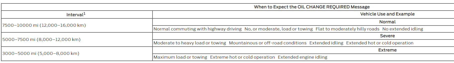

That's how it works. An algorithm monitors your driving style and calculates when an oil change is needed, OR you have reached 10K miles, OR 1 year since last service, whichever comes first. I get mine change every 5 - 6k regardless.
Since OP doesn't put a lot of miles on, I would say change every 5000 mile or one year, whichever comes first.
