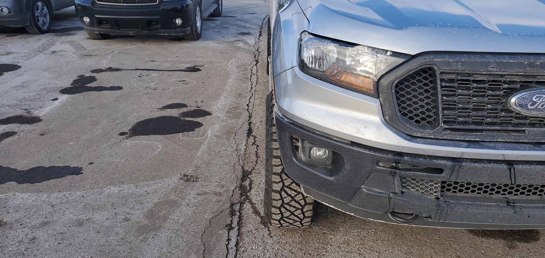

265/70/17 ridge grappler +25 offset
It's not quite what you asked for but it's close

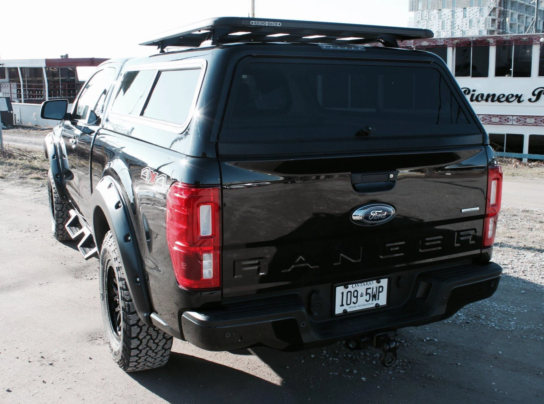

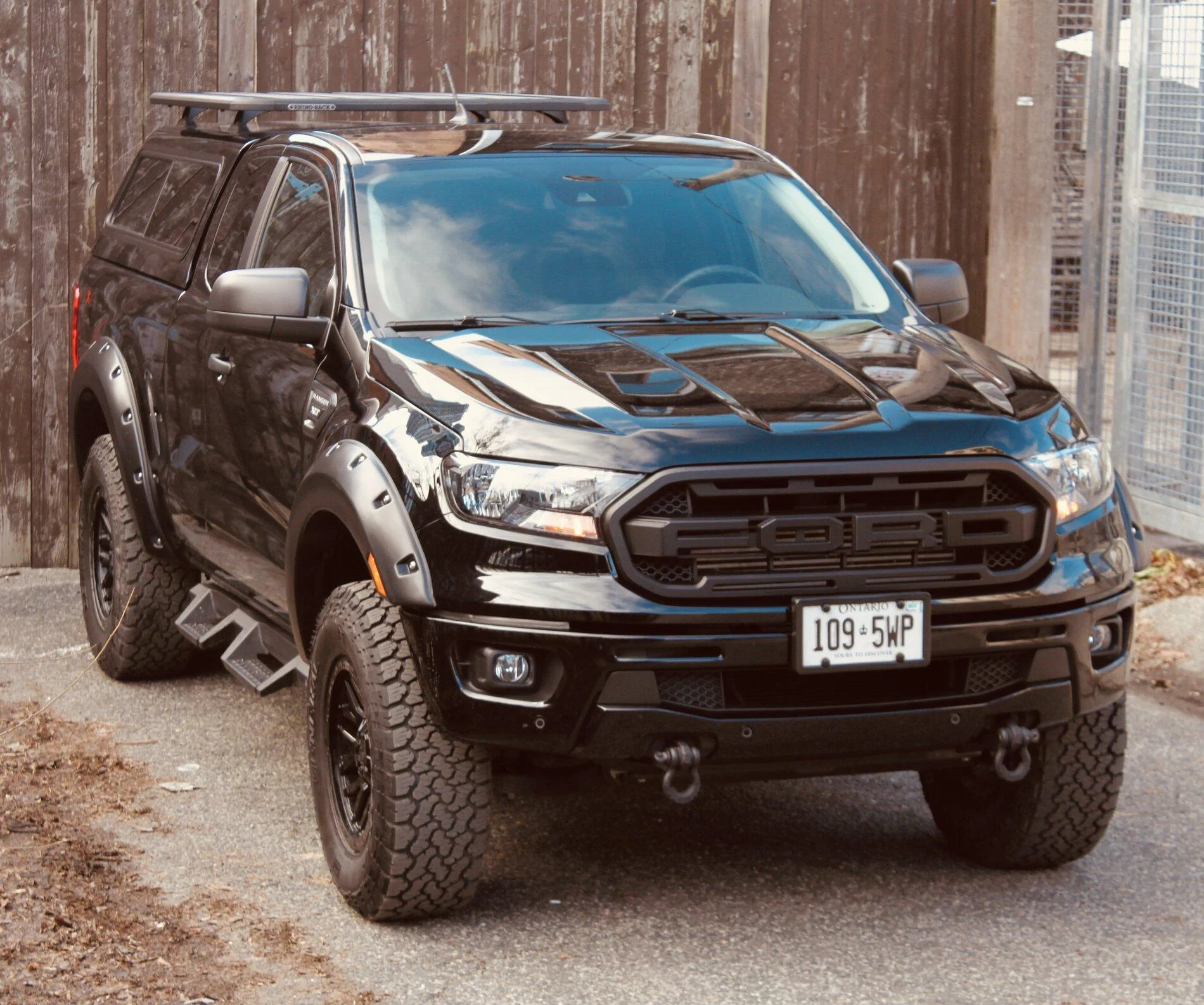

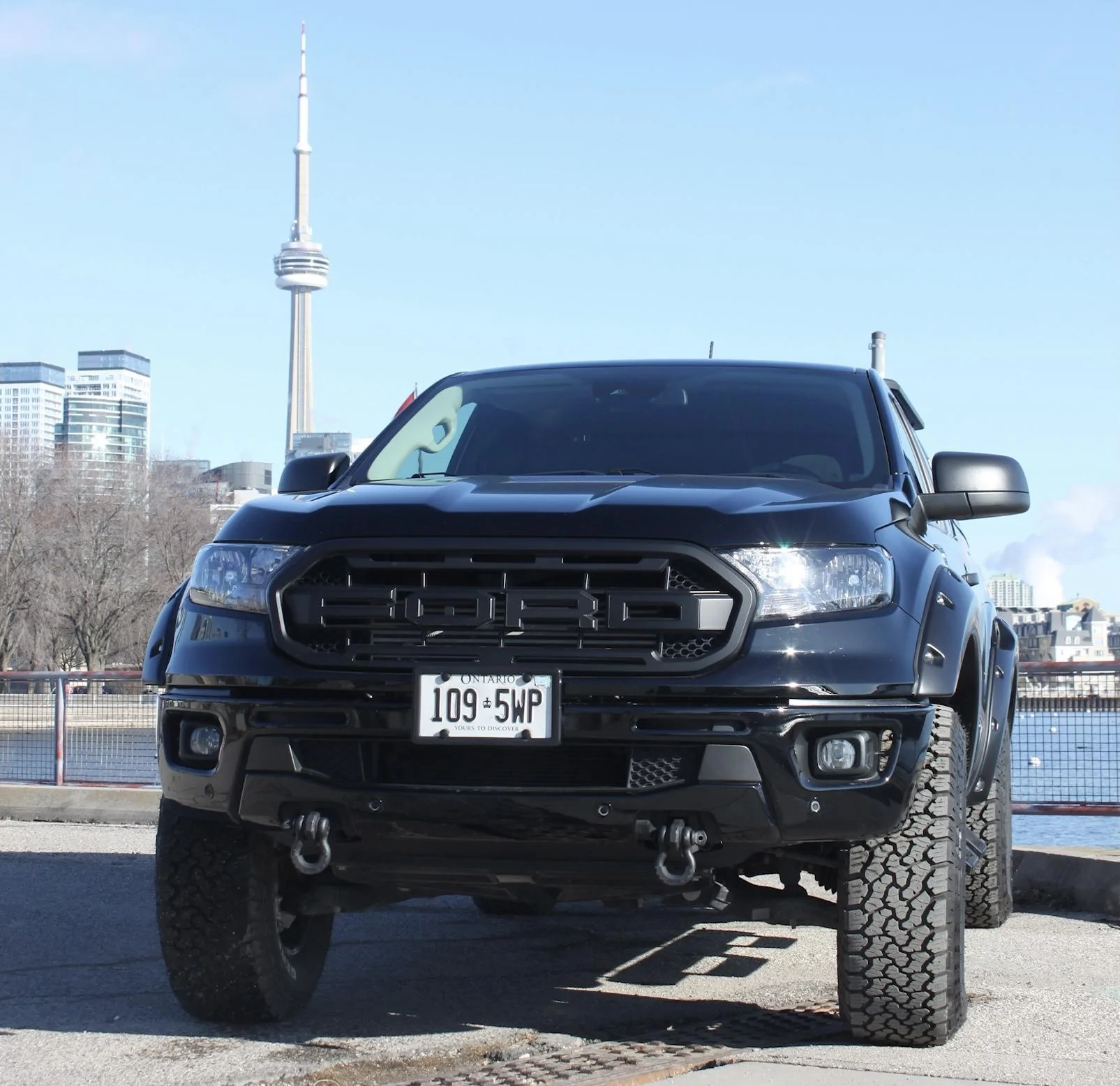

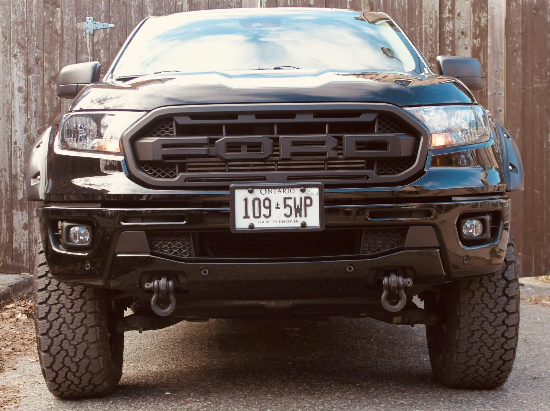

I hope this gives you a sense of the amount of poke you might expect. My Bushwacker flares stick out quite far. It would be a bro’ truck without them.
275/70/17 General Grabber A/T (32.2”)
Menace Wheels 17x8 +15mm - no spacers
Bushwacker Fender Flares

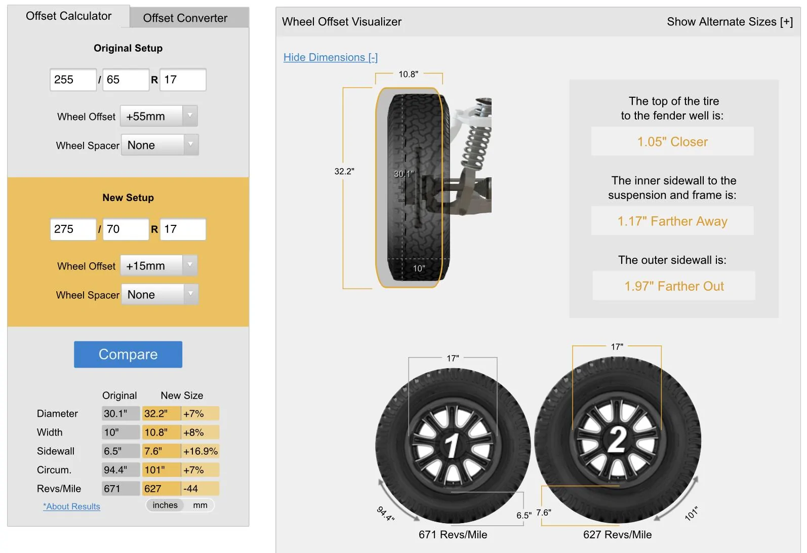

There is a handy offset tool here. You input your existing tire size and offset (+55 for stock Ranger) and your proposed setup specs. It will tell you how much further out your tires will be based on new tire size and offset.
Example:
Example:
Any rubbing or trimming? 2.5" level lift?
RC 2-1/2” Level - no rubbing - bars in tact but very close to rears (1/4”). Installing ReadyLIFT beams as a precaution.
Example:
That's a really cool offset tool! And your truck looks great too!
