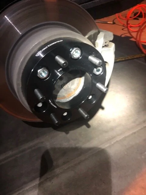

Papaw has been busy this weekend. I HyperDipped my side vents last night and I finally installed my FactionFab 1.5" wheel spacers on Friday night. I really love the look of the wider stance and I definitely love the feel of that extra 3" of footprint on the pavement. (You can definitely feel it!)
I wanted to let everyone know that I ran into a safety issue when trying to get good installation instructions for these very well spec'd wheel spacers.
First off, if you watch the Stage3motorsports installation video (that's who I purchased from), they are installing the spacers on a brand new truck with brand new hubs, no rust. Also, they only torque the spacer nuts to 100 ft/lbs. They do not use anti-seize, but they do use blue loctite.
Flash to the FactionFab installation video, they recommend using an anti-seize compound and they torque the spacer nuts at 150 ft/lbs. Both of these differences are HUGE! You MUST use the anti-seize compound as a weapon against the inevitable corrosion that is already occurring on your hub. When you seat that wheel spacer made of a "dissimilar" metal, corrosion will take over and create big problems. Also, the difference between 100 and 150 ft/lbs or torque I don't even need to point out. They do not use a loctite compound on their installation.
So I used some Permatex anti-seize, did some prep work on the hubs with a wire brush, used a little blue loctite (red is for permanent), and torqued to 150 ft/lbs. I'm feeling very secure in my installation and the FactionFab product specifications.

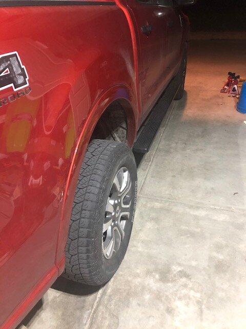

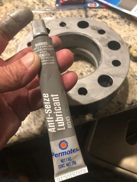

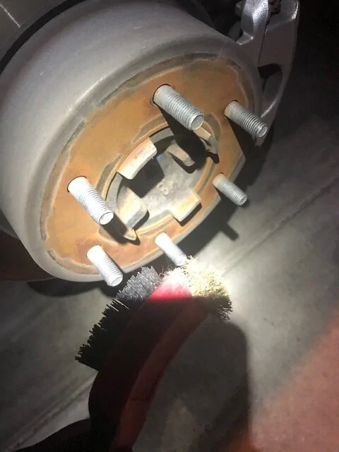

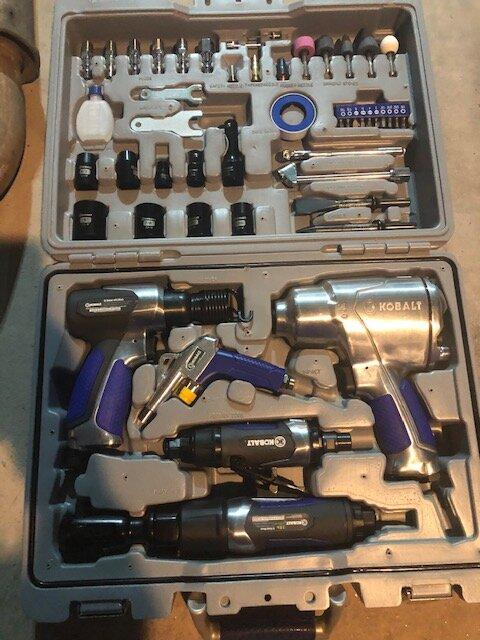

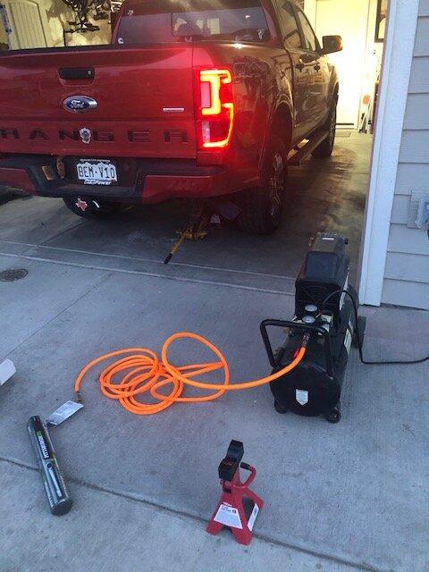

Big thanks to my other neighbor Dan who showed up with this awesome, brand new, never been used air tool set and his compressor to help me in my wheel spacer installation endeavor
STOP! Don't Drive Your Truck !!!!!!
FactionFab How To Install F-150 Wheel Spacers <--- This Video is for a F-150
@ 3:28 he states "OEM Torque specs which is 150 ft-lbs" that's for M-14 lugs on a F-150
OEM Torque Spec for 2019 - 2020 Ranger M-12 lugs is 100 ft-lbs
Side note: They only use anti-seize on the hub-centric portion of the spacer, and none on the actual wheel lugs. Not sure based on your post above if you realized that?
Worst case scenario: You need to replace all the studs, since you over torqued them. Are they ok? No way to know. Replacing them is the smart play.
Best case scenario: You need to disassemble everything and re-torque to 100 ft-lbs.
Big thanks to my other neighbor Dan who showed up with this awesome, brand new, never been used air tool set and his compressor to help me in my wheel spacer installation endeavor :clap:

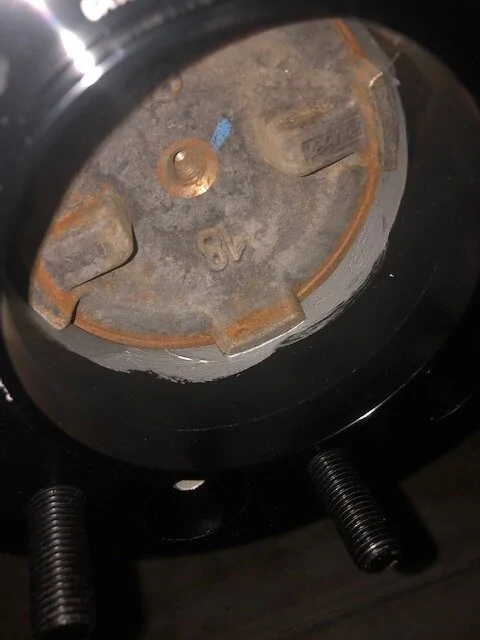

Mark, do the lug nuts have full thread engagement on the spacer ? Doesnt look like it in the pics. Bret

Yikes! I'm surprised you did not snap a stud when torqueing them to 150 ft. lbs. You definitely want to back those off and re torque to 100 ft. lbs. Unfortunately, there is no real way of determining if they were stretched too much and weakened.
I'm going to retorque them after the game and see where I'm at. I have definitely pushed those wheels since installing the spacers on Friday night. I went out running around after and then again last night. I sure hope I don't cause an issue by messing with them. I was using a Pittsburg torque wrench from Harbor Freight so you wonder how accurate a $20 torque wrench is.....I'm fairly educated on torque wrenches, I used to calibrate all torque wrenches for my entire maintenance operation in the Air Force. We actually had to calibrate this monstrosity the was used to torque the lug nuts on B-52 bombers. The head on that thing was like 6 feet long and the rod was 15 feet long. It would take four of us to break that thing over. I can't remember what the foot pound rating was for that thing but it was a trip to deal with.....Thanks to you and HenryMac for pointing out the error of my torqueing ways.
Update: Of course there is no way for me to tell if any of the studs/bolts where over stressed. I just finished the first rear wheel and everything looked fine and went back together fine and torqued to 100 ft/lbs with blue loctite just fine. I'm not using the red because I worry about not being able to get it off if I wanted. Also, FactionFab doesn't use any loctite at all on there F150 install. Thank you all again so much! That could have been a disaster that I'm pretty sure was averted :fistbump:

I've always been advised not to use anti-seize on wheel studs as they will act as lubricant and allow over torquing at the same ft lb number...correct me if I'm wrong...
I followed mounting instructions to use Locktite Red to bolt spacer to hub...I check a week later and they were still at 100ftlbs...
You're right. No anti-seize, oil, grease, nada on wheel studs or lug nuts.
I don't think Mark did based on the photo's. I just wanted to be sure he was aware of that though as his wording in his post was unclear, at least to me.
If he had used anti-sieze and 150 ft-lbs, I'm thinking the first stud would have shown him something was wrong..
