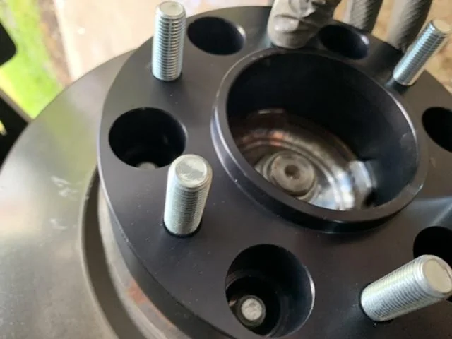

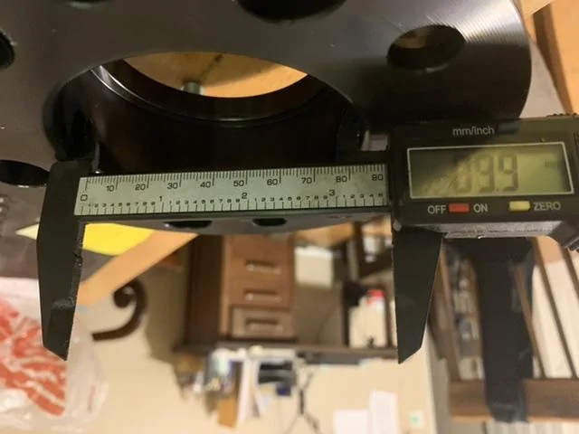

I ordered 1.5” Boras from motorsport-tech.com over two months ago and finally got it in the mail today. Went to install it and it doesn’t fit. Since it’s friday it’ll probably be a couple of days till I get a hold of them. I guess what I’m saying is, I should have went with wheeladaptersusa... sounds like little to no wait and it actually fits!

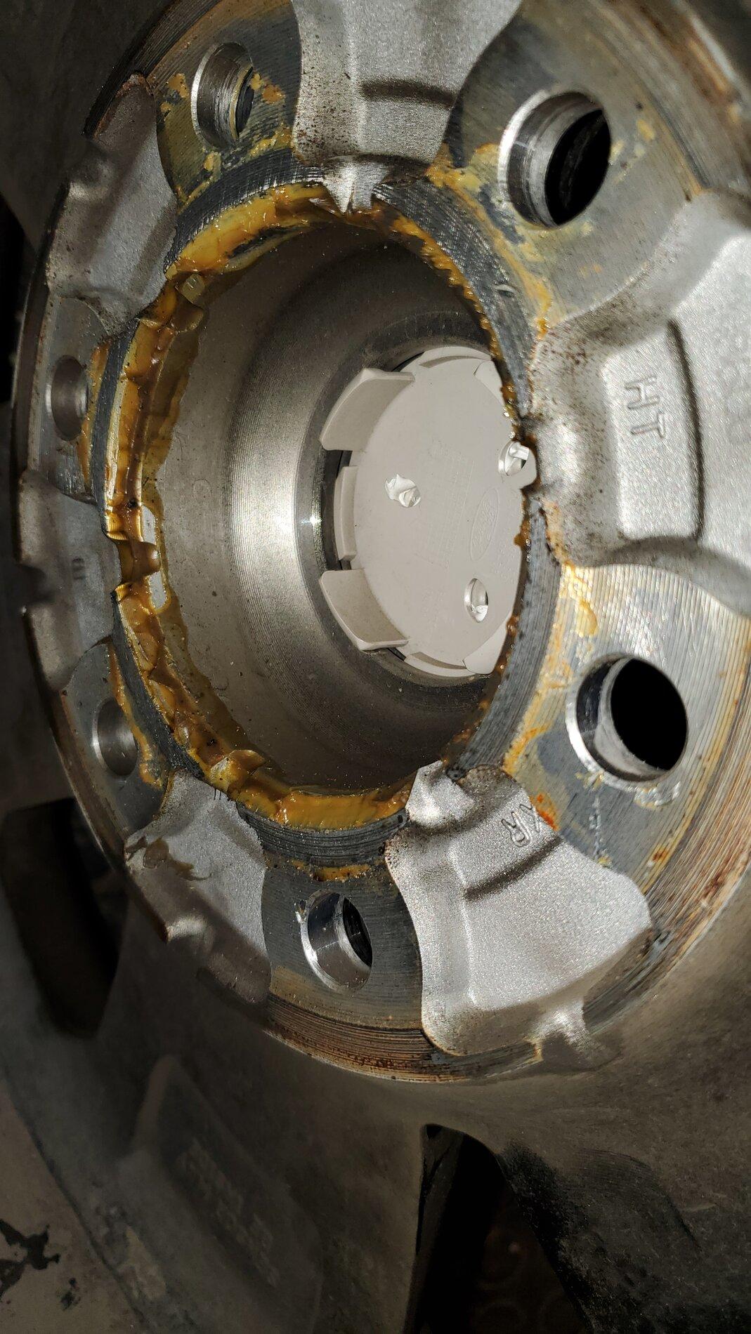

I have Bora's and had no issues. Do you have corrosion stopping it from bottoming out? Mine was basically brand new, slid right on.
Nope, it’s cut too small 89.9 instead of 93.1. I sent them pictures and of the size discrepancy, they responded with more questions but they are quiet today. I hope they will make good. Soon.
