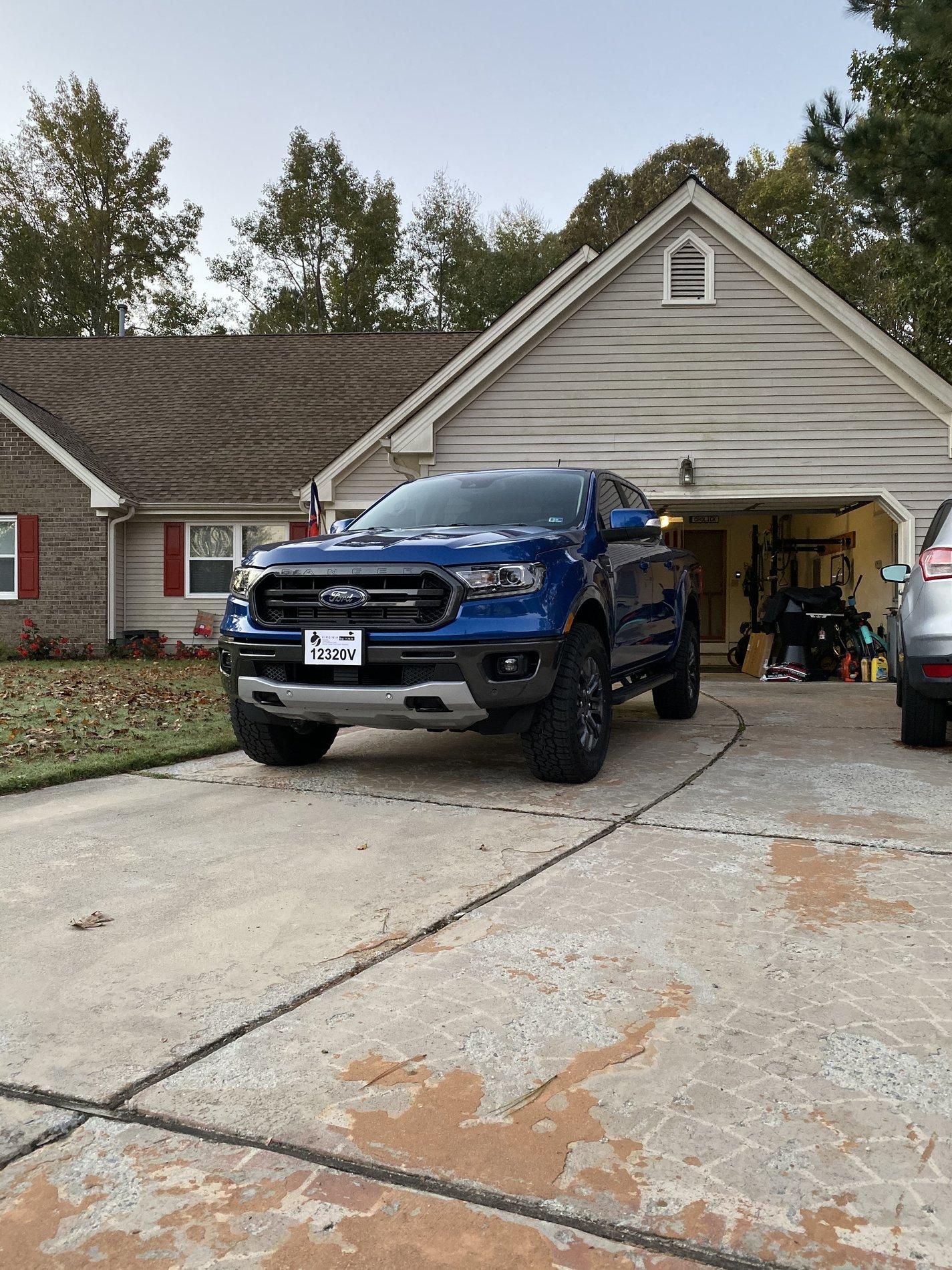

I was considering those, but I am worried about rocks/snow/mud hitting the side of my truck or other cars if the 1" spacers push my wheels out too far. I have the stock 17's and will be putting on 285/70R17 Nitto Ridge Grapplers.
I have 265/70/17 with 1” spacers. I wouldnt go any further due to rocks and debris thrown on the side of the truck. My left tire is also rubbing the front crash bar when I turn right.
That is it. The perfect offset for the tires. Right to the edge of the top of the fender. That’s the look I want. I can’t find any 25-30 offset wheels that I like, so a 1 inch spacer may be the ticket.

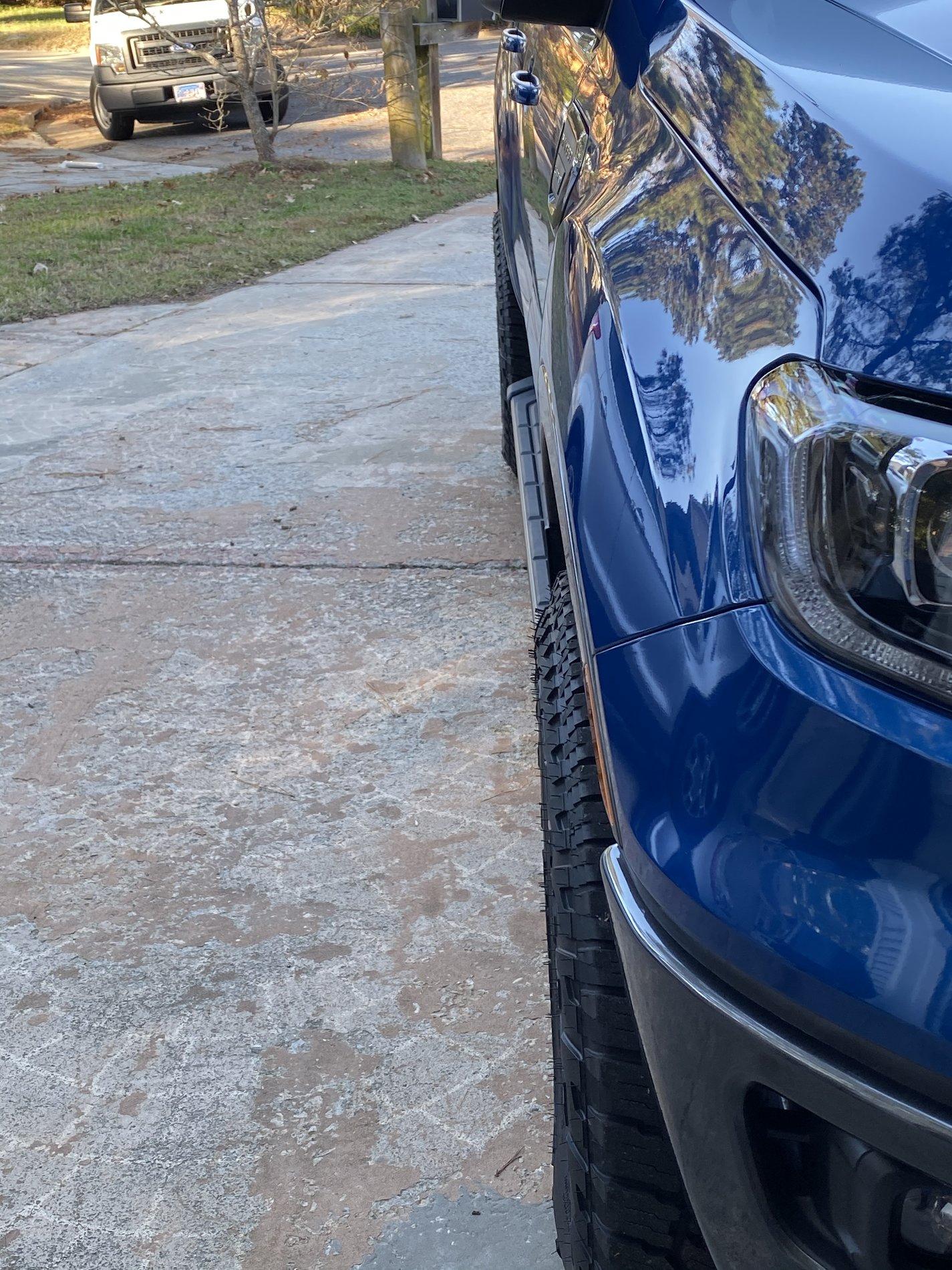

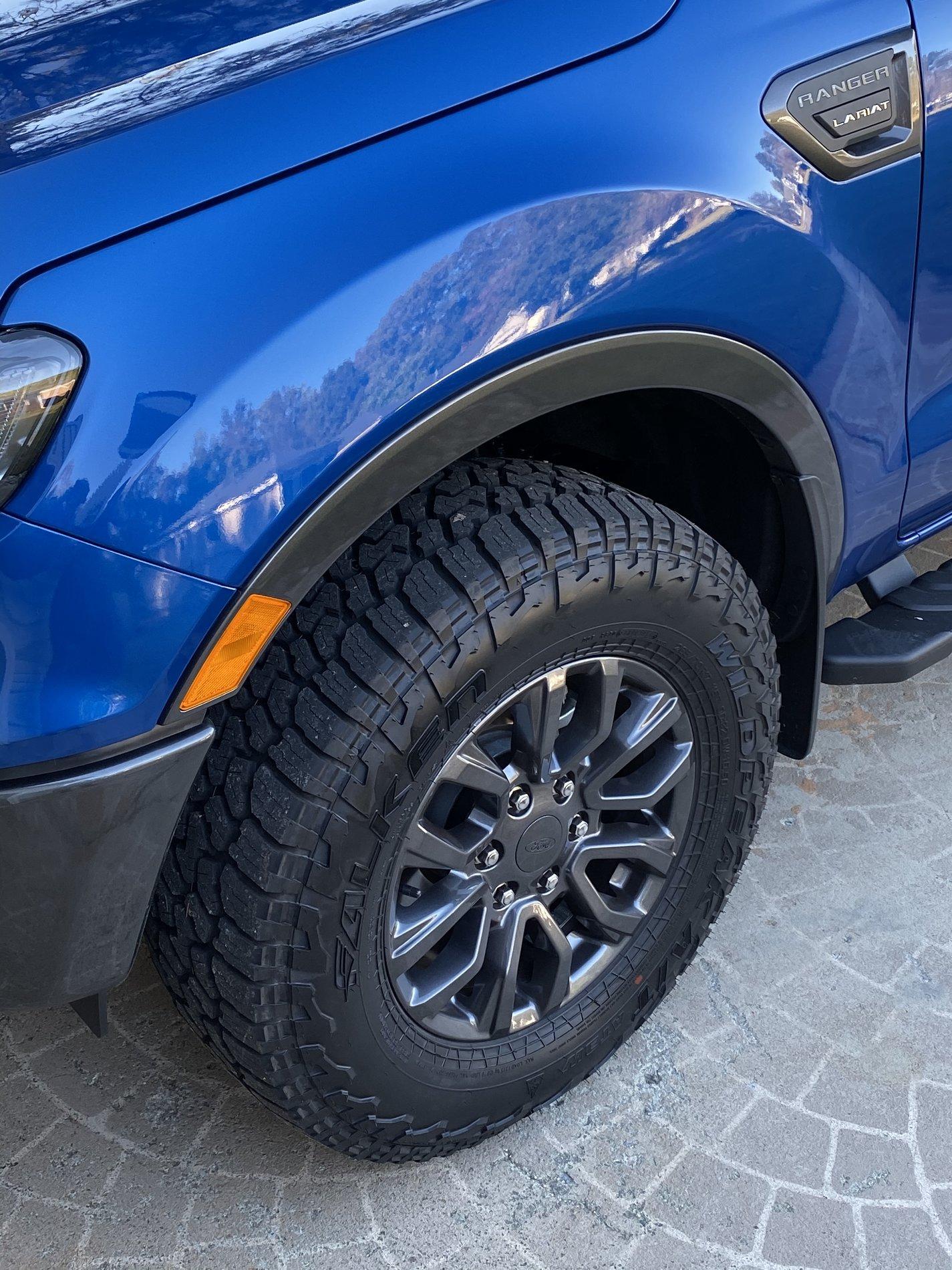

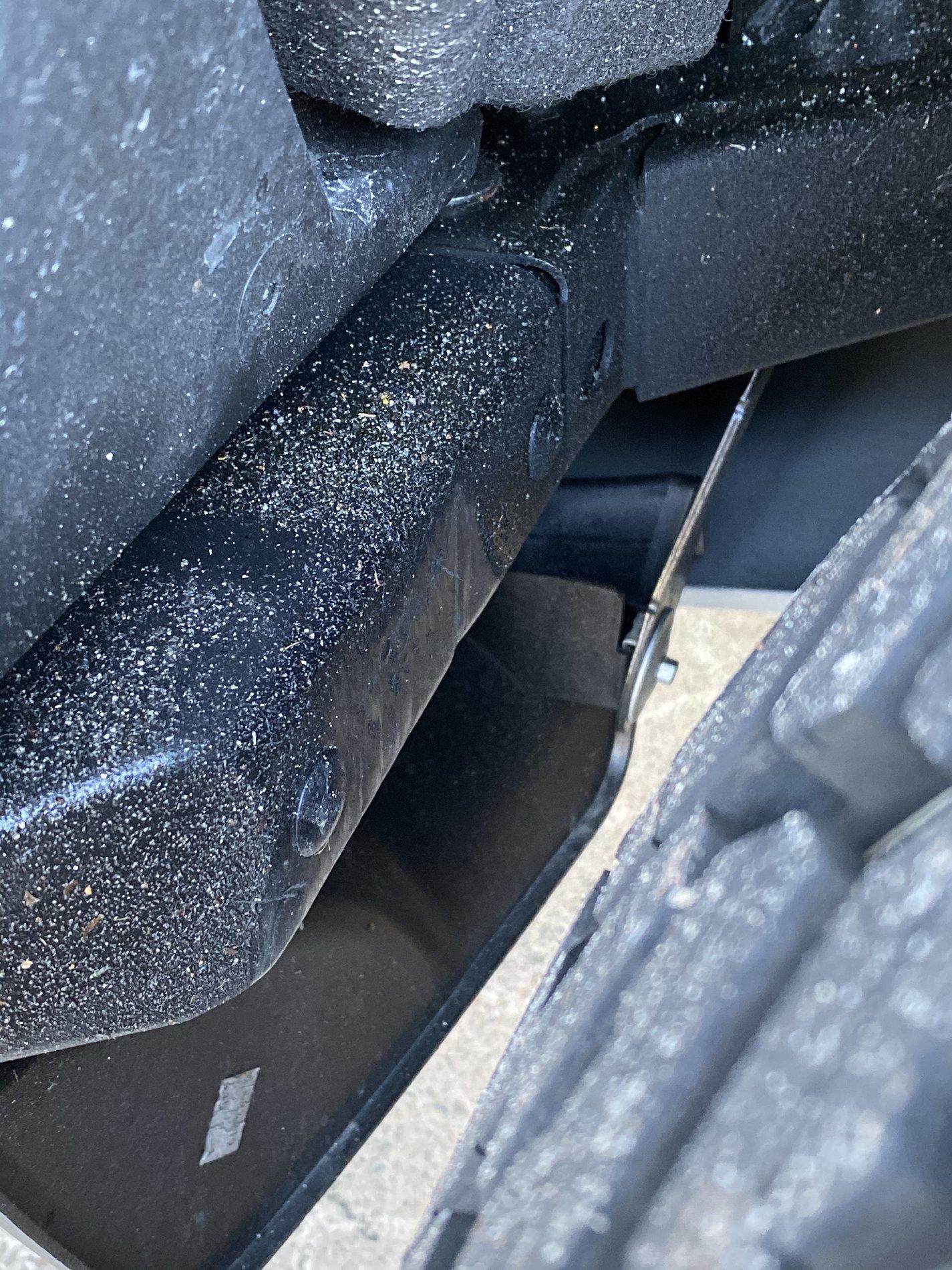

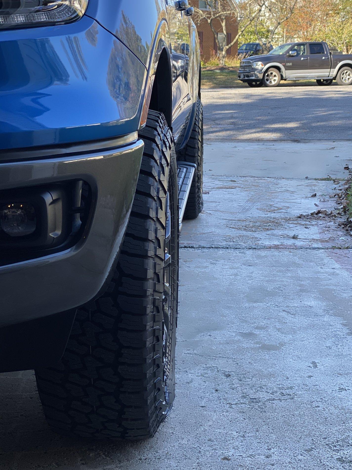

Some more pictures. Also the drivers front crash bar where it rubs. BTW, those are the factory Ford mud flaps.

Quick tip on the bars. By removing the plastic cover over the bars then loosen the 2 crash bar bolts and retorque them while holding away from the tire i was able to gain over 1/4 inch of clearance to the tire.
That’s a neat trick! I’ll have to give that a shot, that’s probably all I need. :like:
