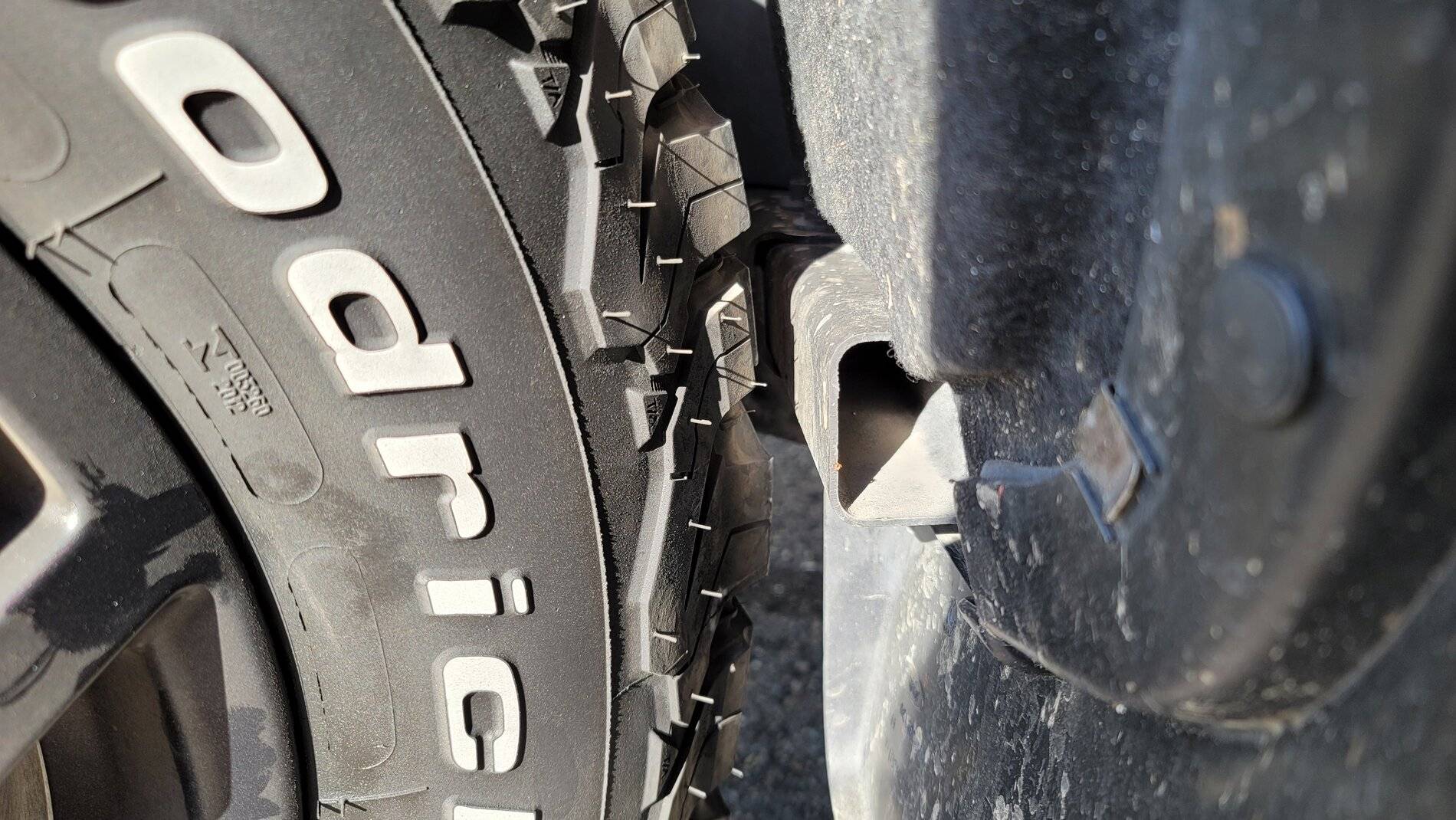

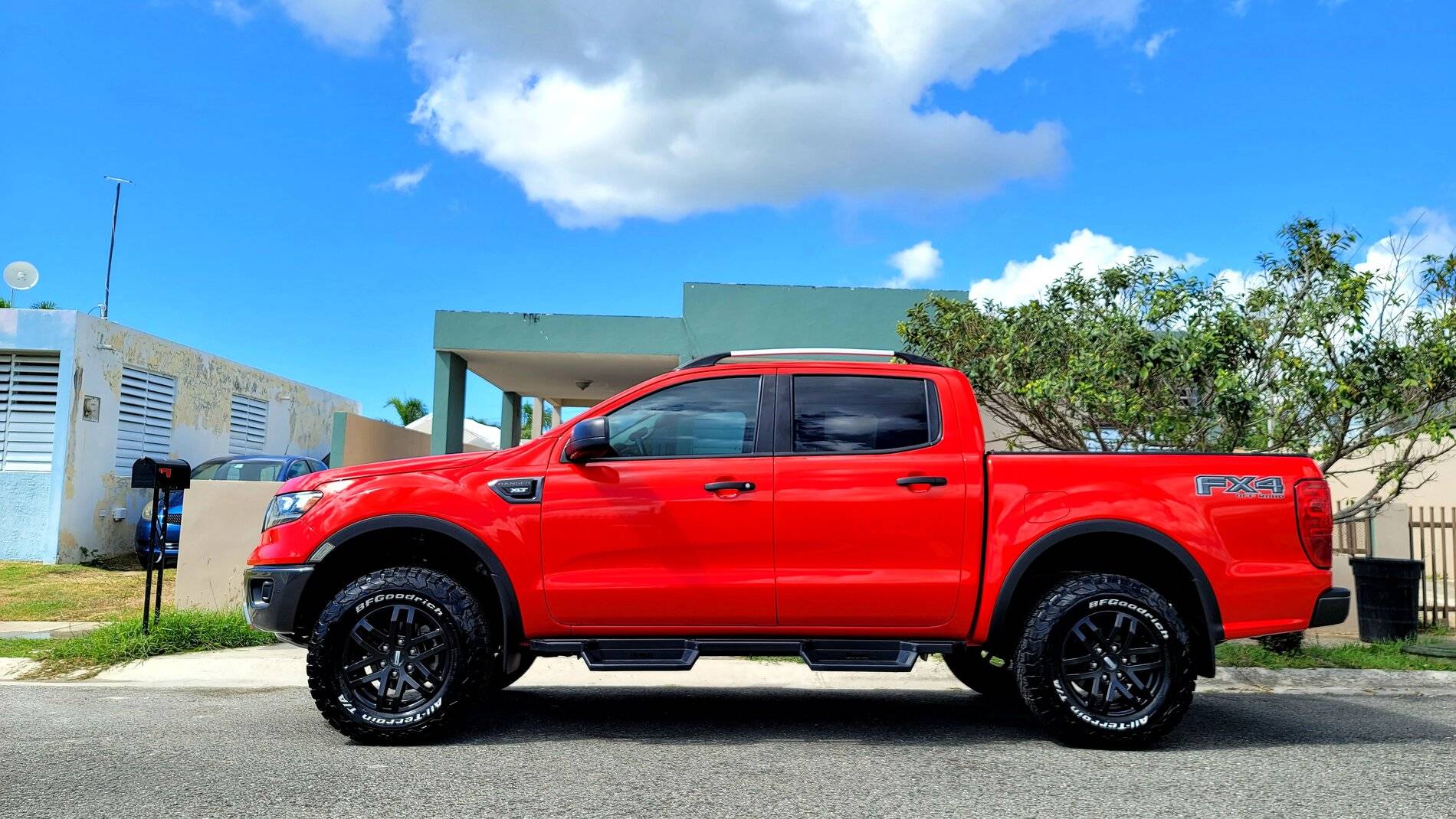

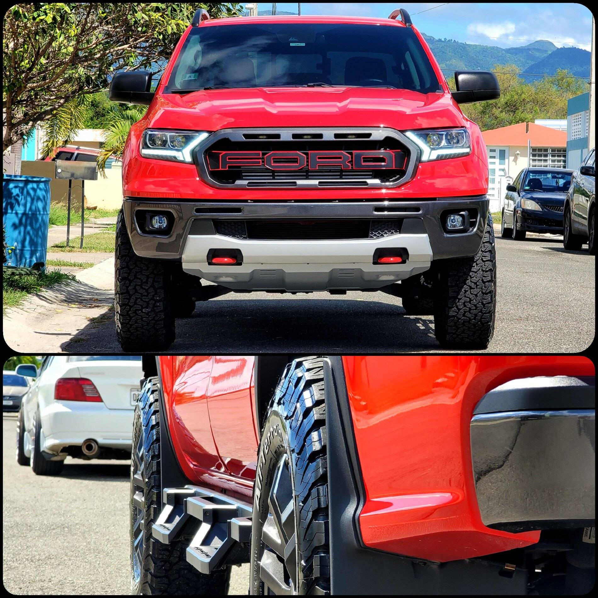

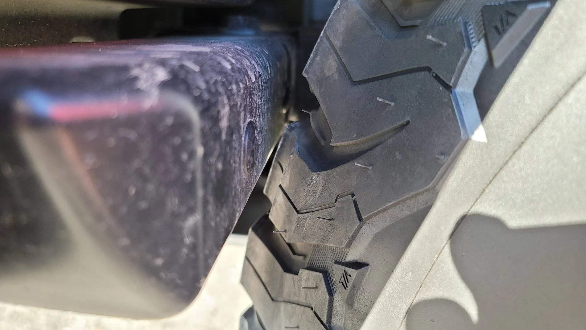

This is my Ranger 2021 with readylift 2 inch kit, only up like 1.5 inch, 265 70 r17 KO2s and now with 1.25" spacers. Now looks much better and doesn't rub the crash bars at full lock.

Looks like that is the limit with the crash bars! Will the tire hit the front bars if your wheel comes up off-road?

I don't know but if they touch, I read something here that loosing the crash bars they can be moved like 1/4 so I'm good. If I go to the offroad curse I will let you know.

Thanks for sharing. Your in stock tremor wheels which have what for stock offset?
