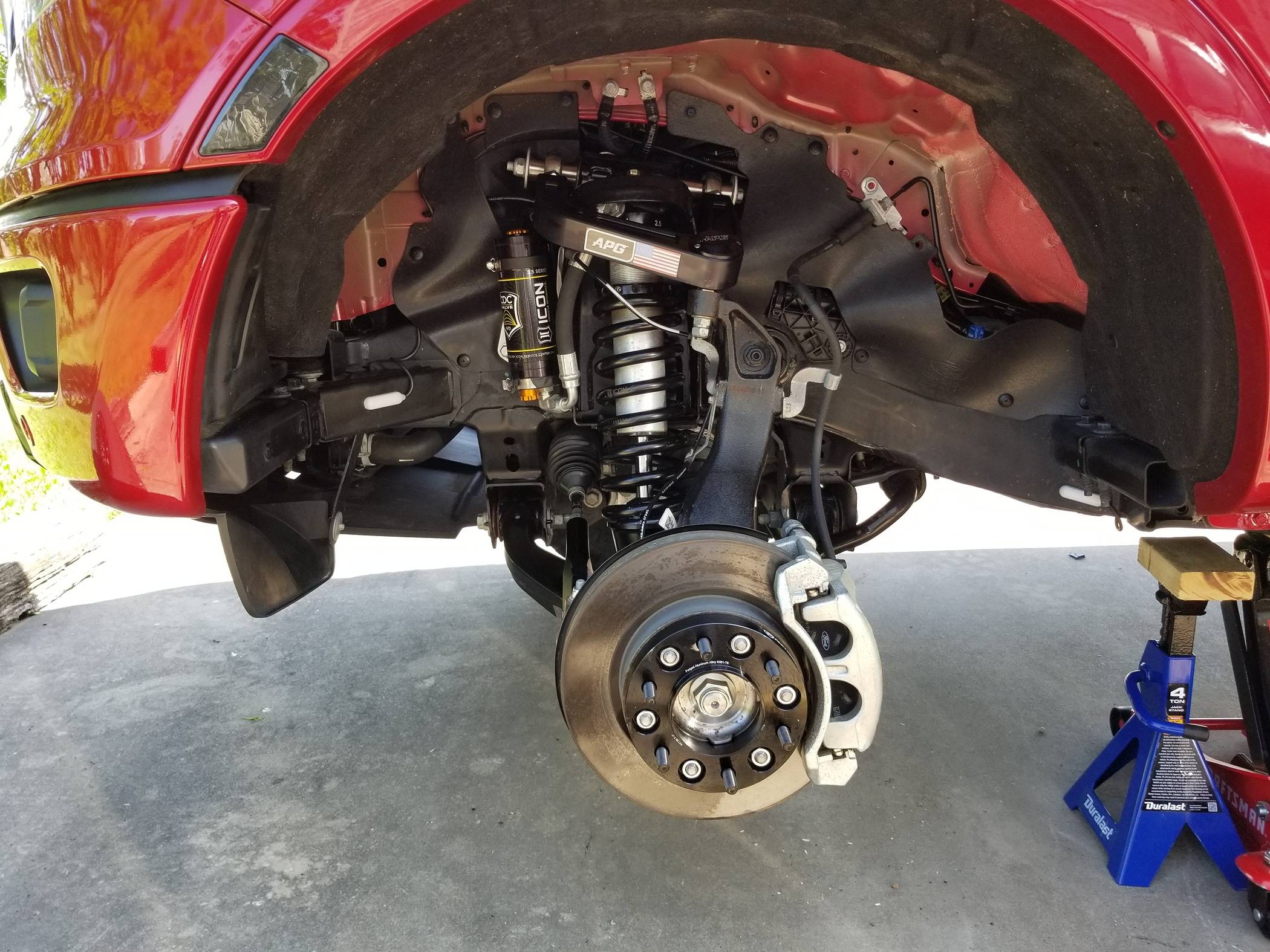

I'm debating what size wheel spacers to put on my Ranger, 1 or 1.5 inch. I have the Fox Ford 2.0 lift and am currently running 255/75R 17 tires but would like a wider looking stance. Some two track roads to hunting camp is about it for me, not serious off roading. Thoughts and pictures anyone?
One inch, no more.

Spacers are okay....Don't cheap out, use high quality Billet spacers...( aka Faction Fab)....Keep width reasonable ,,1.0 - 1.5" ..
Install properly...use a little antiseize, and Red Loc-Tite ...Torque to specs (110 ft lbs)
Yeah, I dont know what all the fear is with spacers. 100% get quality for machining tolerances and included hardware being properly rated. In my time in the auto industry (6yrs) and years being a car nut on top of that, I have never heard of anything more than a vibration caused by poorly made spacers. Still, no excuse to buy cheap ones.
I have been off-roading (dunes and trails), towing and just daily driving with my 1" spacers for at least 2yrs now, never loosen, always good. I went with quality spacers though (FactionFab 1.0").
There are plenty of videos online of peoples wheels coming off on the highway because the wheel was not torqued properly. By this logic, do not drive your vehicle at all without torquing your own wheels. lol that said, I always check the torque on my wheels after it being serviced in case I came across a lazy tech.

Wheel spacers have gotten a bad name from the kind that are not hub centric, meaning the studs are all that keep them in alignment. Those kind can cause vibrations and such. Good quality hub centric spacers will center themselves off the hub like oem wheels as well as use good hardware so you should not have any issues.
I am running 1" factionfab spacers for about 5k miles now without issues.

Again, if you're fitting taller tires then you want a 1.0-inch spacer to correct scrub radius. 1.5 inches would push that out of spec again, and will also poke your tire outside the wheel arch. Not only does that look stupid, but it will ruin your paint, make the vehicle less stable during emergency braking, and reduce the precision of your steering.
