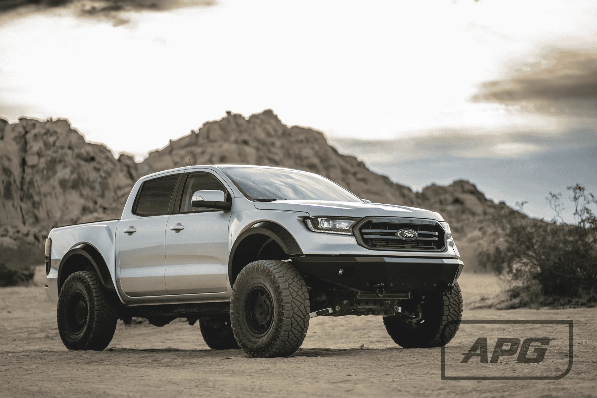

Was a little hesitant to run spacers on my truck due to all the stigma around them. They havent budged within 500ish miles since i put them on, and i checked them twice during that period.
One thing that calmed me down a bit was that these pre runner or w/e you call them builds generally run massive spacers in the rear to match the fronts. If those dudes can handle monster jumps on 35s, im sure mine can handle some decent trails, or at least, hopefully lol.
Too bad my fronts are rubbing when i hit bumps while turning, not keen on trimming my fenders or the plastic behind it.
(not my truck, i wish though)

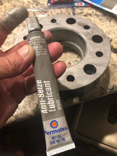

I don't worry a bit about my spacers. If I did I sure wouldn't push my truck like I do....The bottom line is if you can get the look you want with a good wheel/offset it's one less breaking point at the wheel. I've run mine for over 50K with no bearing or tire wear issues....proper torque is essential and I definitely recommend application of an anti-seize compound.
I'm running 1.5" FactionFab spacers and XD Series Rockstar II wheels with a +30 offset.....
Tires are 265 60/18's
**Snip photos**
Yeah I agree with that for sure.
Good to see you used the same amount of antiseize i did, was worried i may have over done it.
Yeah that is a good application, Any excess will just get pushed out

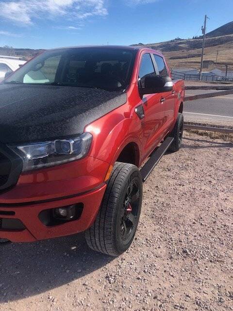

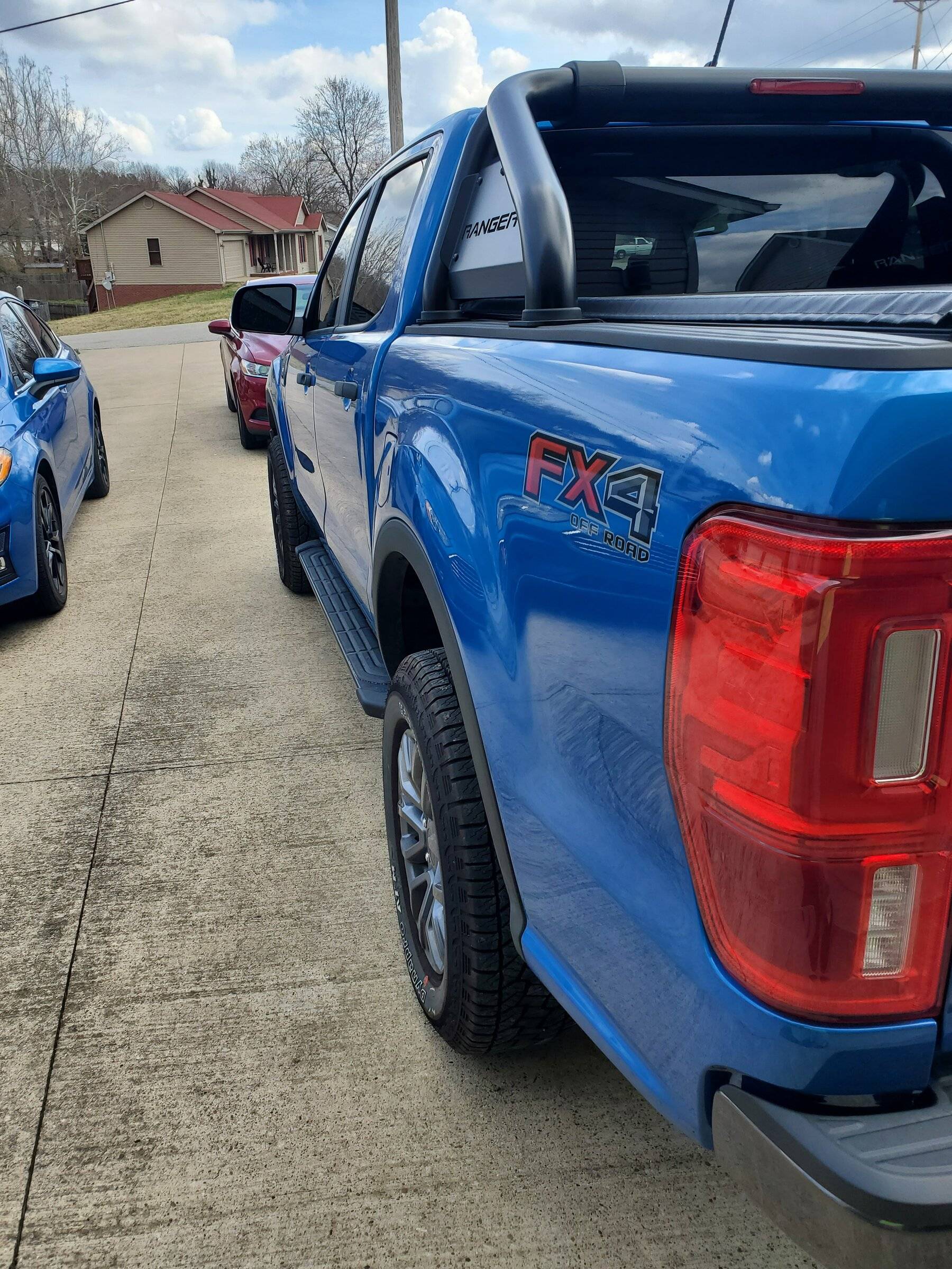

It's perfectly safe running a quality, modern wheel spacer. Spidertrax, FactionFab, etc.
BUT, you don't want to add so much additional width that your poke the tires out of the wheel wells, as many people here have done. In addition to destroying your paint, that much extra track width ruins your scrub radius (https://en.wikipedia.org/wiki/Scrub_radius#:~:text=The scrub radius is the,ball joints of the hub.) which will make your steering less precise, and reduce stability under heavy braking. It's also death on your wheel bearings.
The correct wheel spacer size for stock offset wheels (+55) is one inch. No more, no less.
Here's my truck, with one inch spacers, and both stock wheels and ROW Ranger Raptor wheels (same offset). The ATs are 285/75-17 and the winters are 285/70.
TL;DR: Don't poke your tires outside the arches. It's dumb, ruins your truck, and people will laugh at you.
