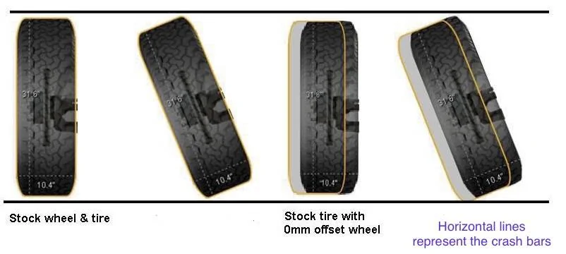

The local shop is only partially right - they’ll “fit” without a lift but that doesn’t mean they won’t cause problems when at full steering lock, especially when your suspension is compressed.
As others have said, a lower offset will push your wheels out and that’s all well and good until you turn your wheels. Rangers have front and rear crash bars that need to be considered.
Think of it this way, turn your wheels all the way left, the hub is now at an angle, now imagine moving that wheel further out with 0mm offset, and you’re pushing your tire closer toward the crash bars.
The picture below tells the story - the horizontal bars represent the crash bars, the shaded tire represents the new tire position with a low offset wheel. The shaded area is now making contact with the crash bar. :(
I’m not saying you’ll definitely rub on those bars, but it’s a real possibility. Hopefully someone on the forum who has tried 0mm offset without a lift and OEM tires will chime in.

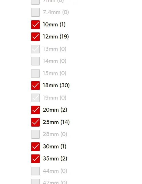

I'm on both the Tire Rack and the American Trucks website right now, and I can sort by the offset:
9,608
45,996
Folks have avoided issues by staying in the +25mm to +30mm area. This will bring things a little closer to being flush with the wheel well and hopefully, avoid issues.

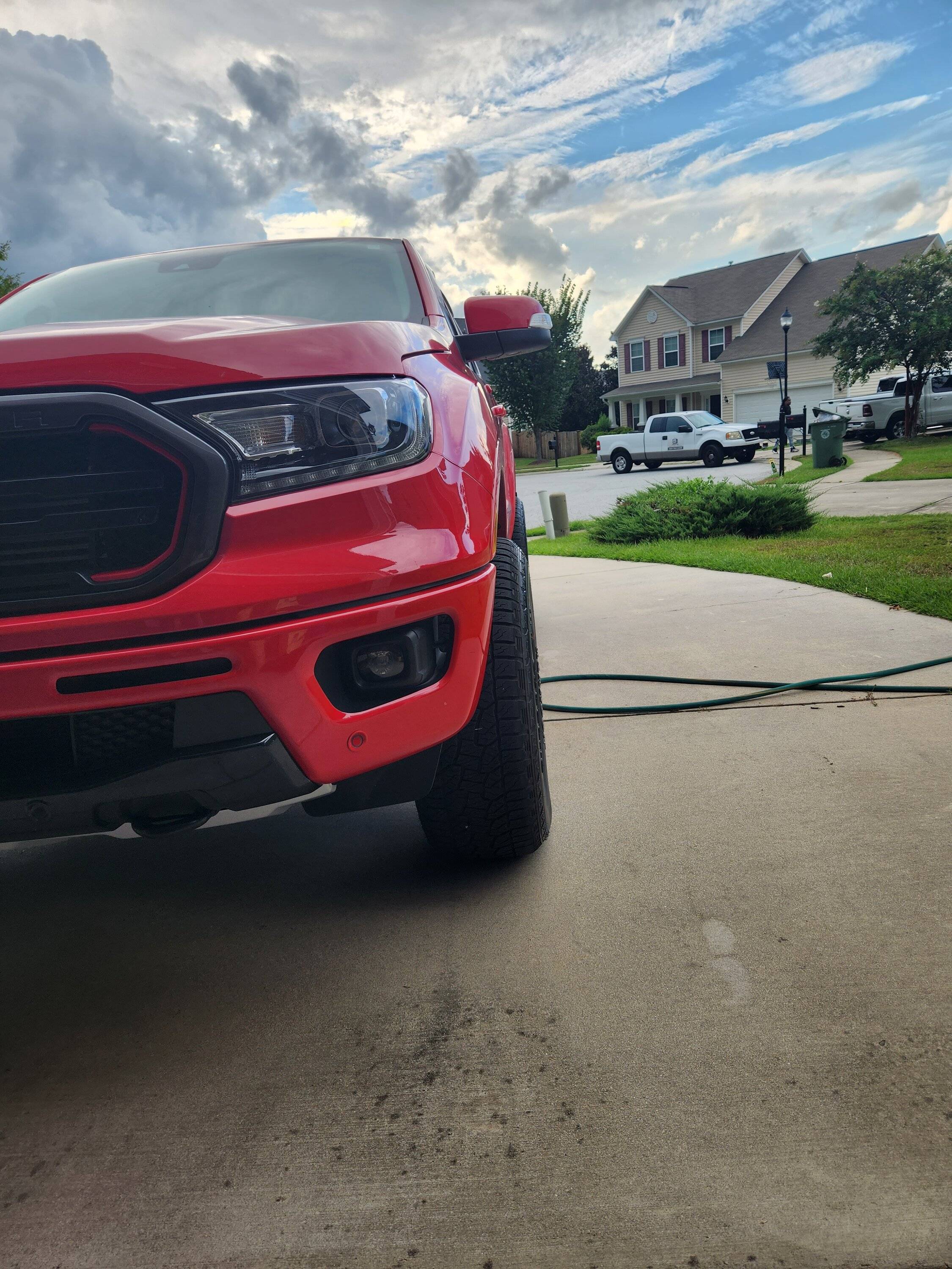

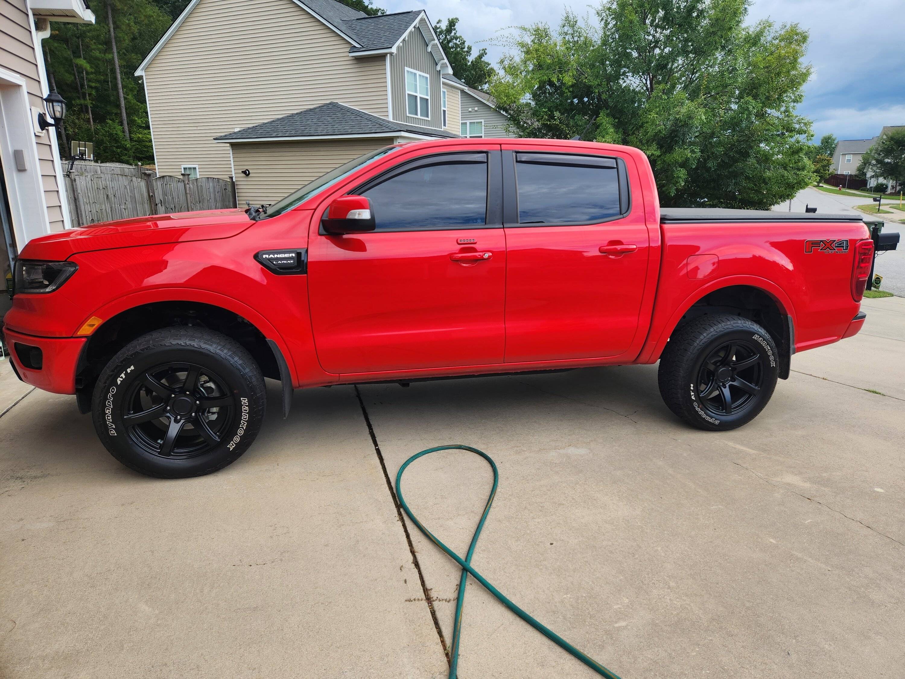

So, I know that the 0mm offset wheels will push the face of the wheel outwards about 2", just trying to get an idea of want to know what they'll look like actually on the truck. Does anyone have a picture of the stock tire size with this offset?

The 0 offset with stock tires worked fine. Had to trim some plastic, but it worked! I think it looks great!
I'll show this to a friend if he'll like the stance. He's considering the zero offset on stock tires setup as well for his new DD 2020 Ranger. His Raptor will get 35" tires, new fender flares, and headache rack with light bars.
