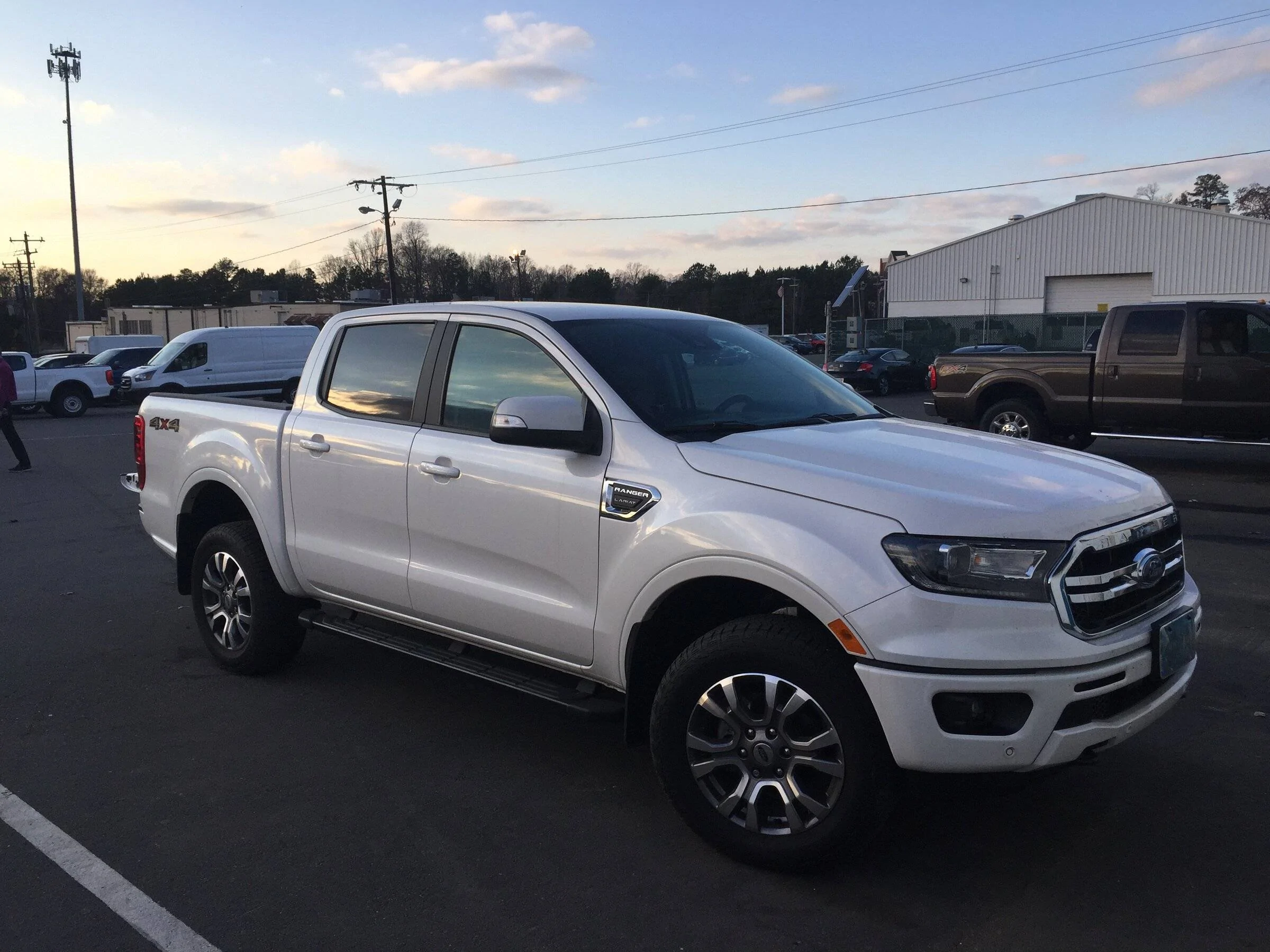

Dateline: March 28th, 2023 - Charlotte, NC. 2019 Ranger Lariat. No problems, runs fine, everything works as advertised. Sub par ride (my opinion) recently corrected by replacing ALL four shocks/struts with quality Bilstein OEM units. Enjoying Ranger even more than before. This Ranger is #4. 1988, 2001, 2006 and now a 2019 (all bought new) - very good, reliable vehicles, perform as advertised. Another blissful day with my Ranger...
