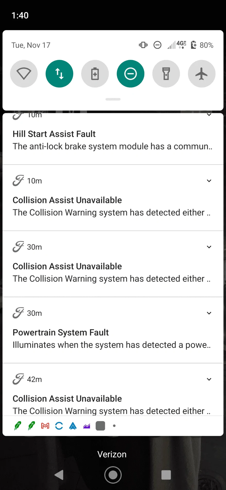

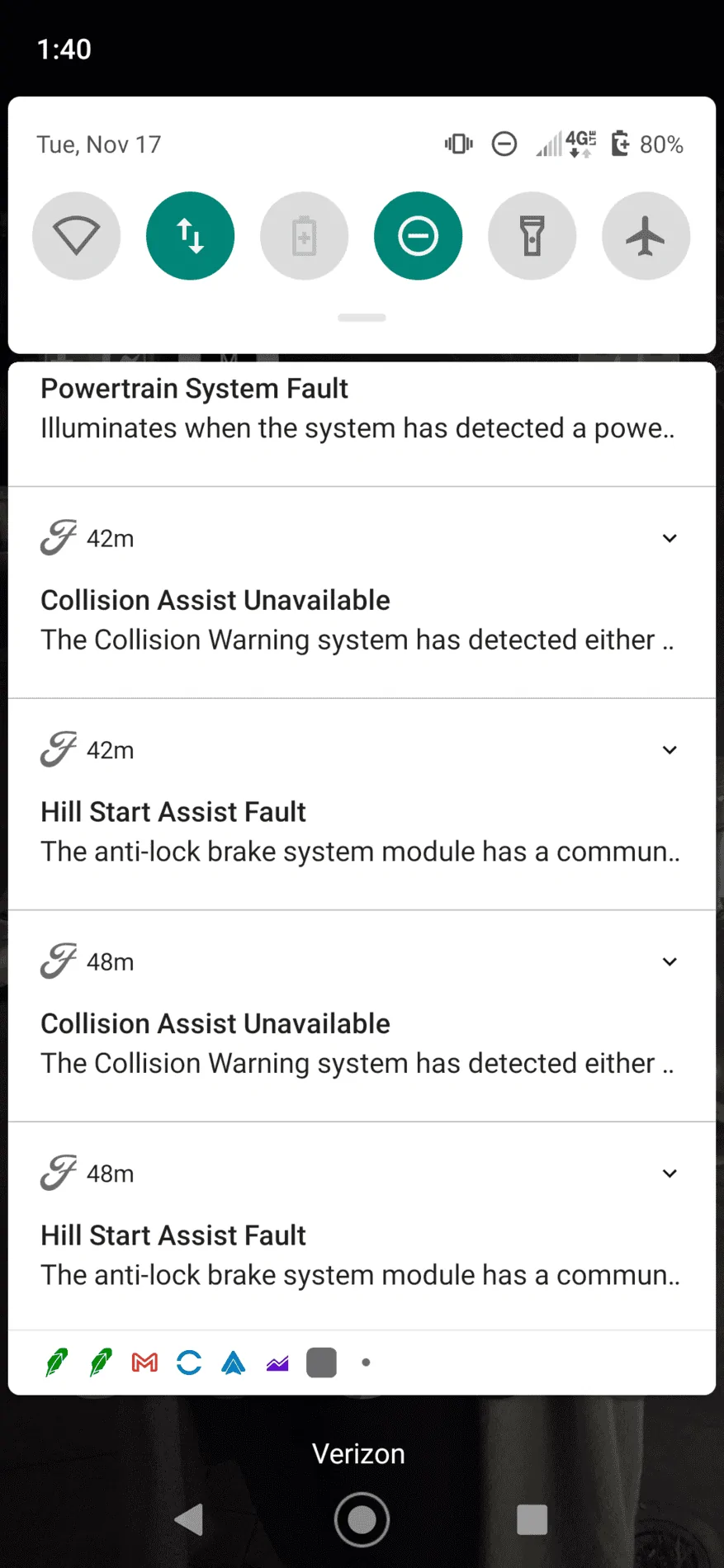

Alright folks UPDATE TIME!!
Just got the truck back from ford. So the solution was simple... Replace two modules that were not communicating with each other and we're causing the rest to act wonky.
The tech said he's never seen this issue on new vehicles, typically the computers don't just shit the bed in the first few years.... Typically. I'll upload a pic of the write-up from ford in a few.

Well update for all you helpful folks and less than helpful/smartass "people", ford has had my truck twice now. First time they replaced two modules that were dropping signal between them and the BCM. One day later the same issue occured except the radio now worked. Now the replaced the BCM and everything is working great. Just gotta break out the forscan n re input the bambi mode n re activate the climate control on the screen.

Grumpy as usual. Found the issue. The ground wire on the BCM side was bad in the connector kept shorting n burned up three bcms and two other modules before the tech decided to check the wires and replaced that part of the wiring harness
