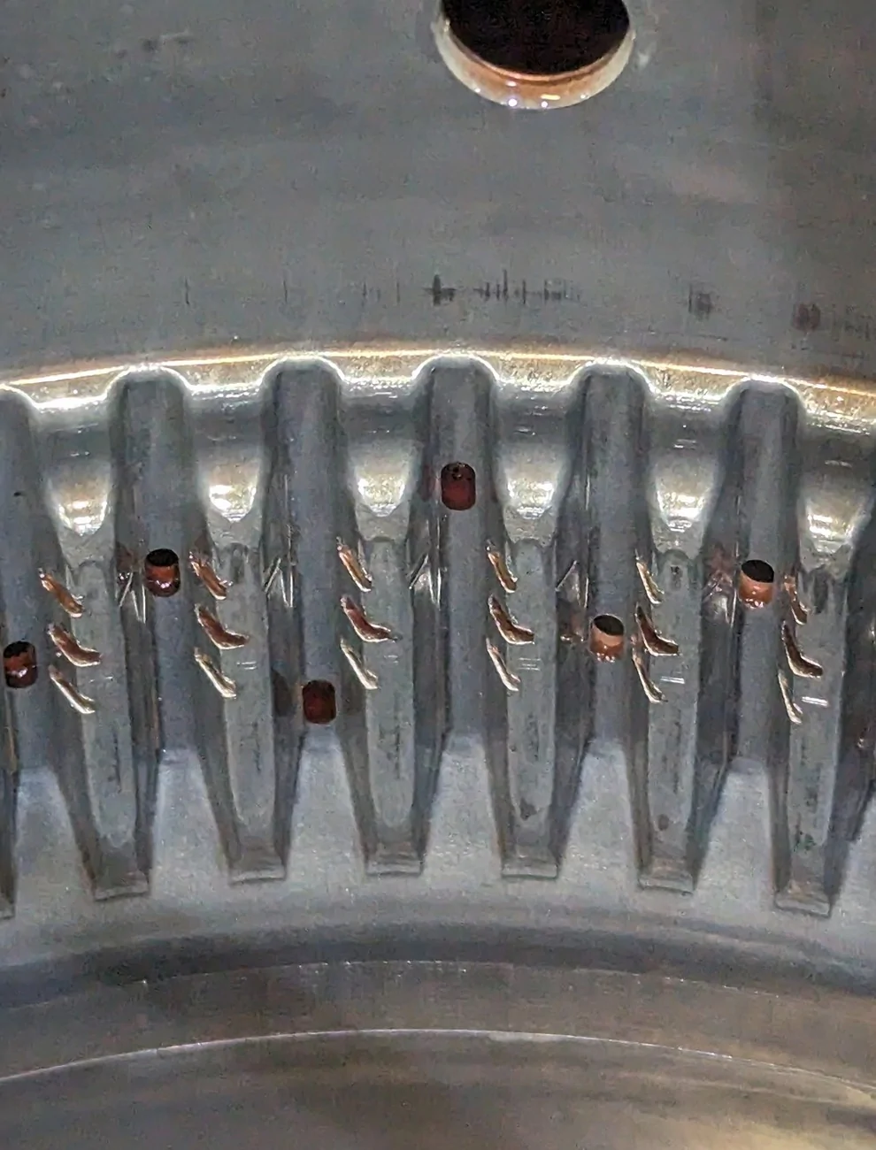

Update: The transmission tech who did my rebuild said that the scoring on my CDF drum was the worst he had seen. Photo attached. It passed the test in the most recent TSB and wasn't throwing any codes, but the technician said it was definitely not shifting right. The clutch plates were also completely destroyed so I got those replaced under warranty as well. I also have a Fitzstick installed and they didn't say anything about it in terms of voiding the warranty.
That image is of the outer shell or “trash can” which was replaced in your repair. This failure would probably explain why it didn’t show up in the CDF drum test.
