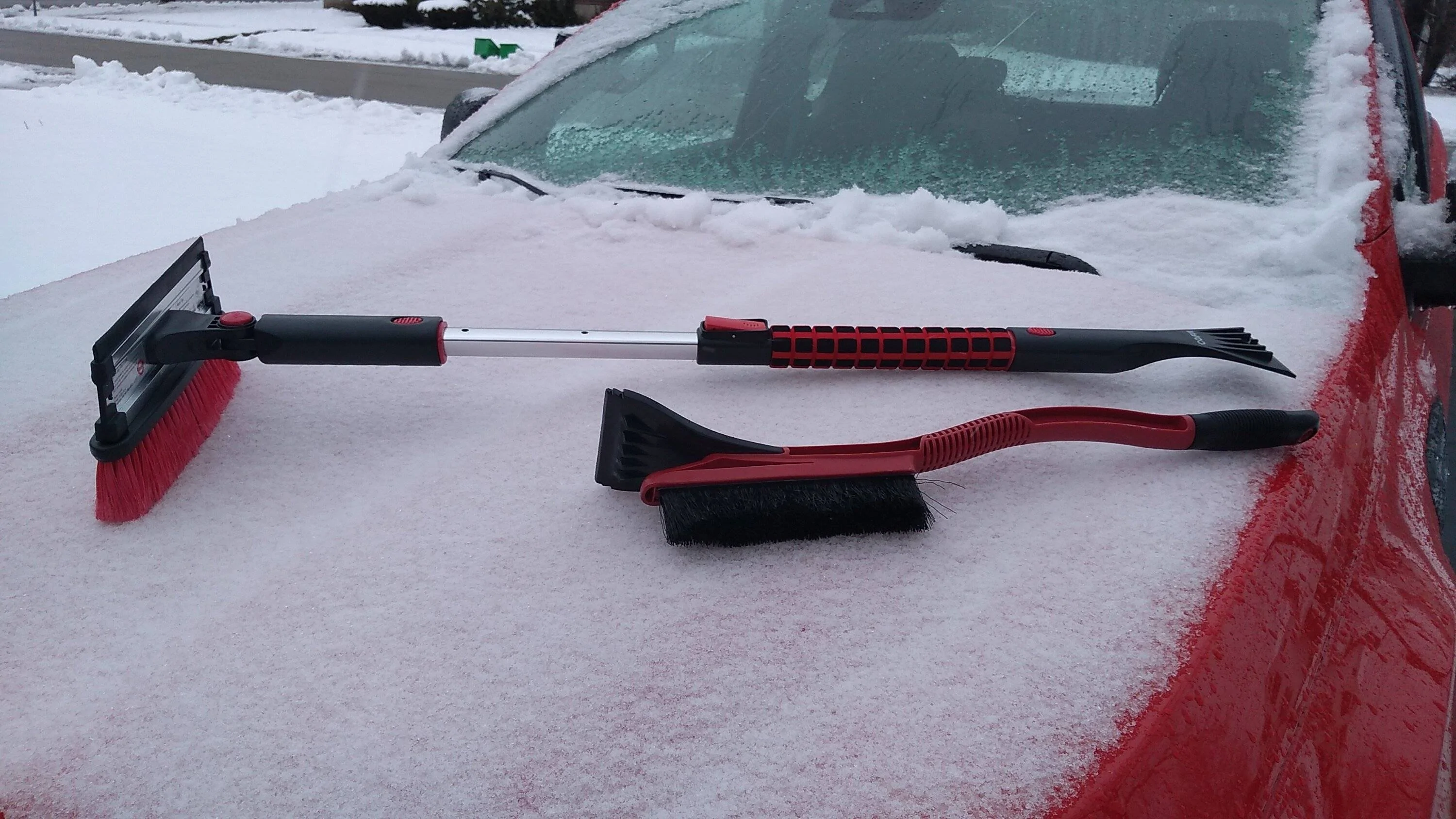

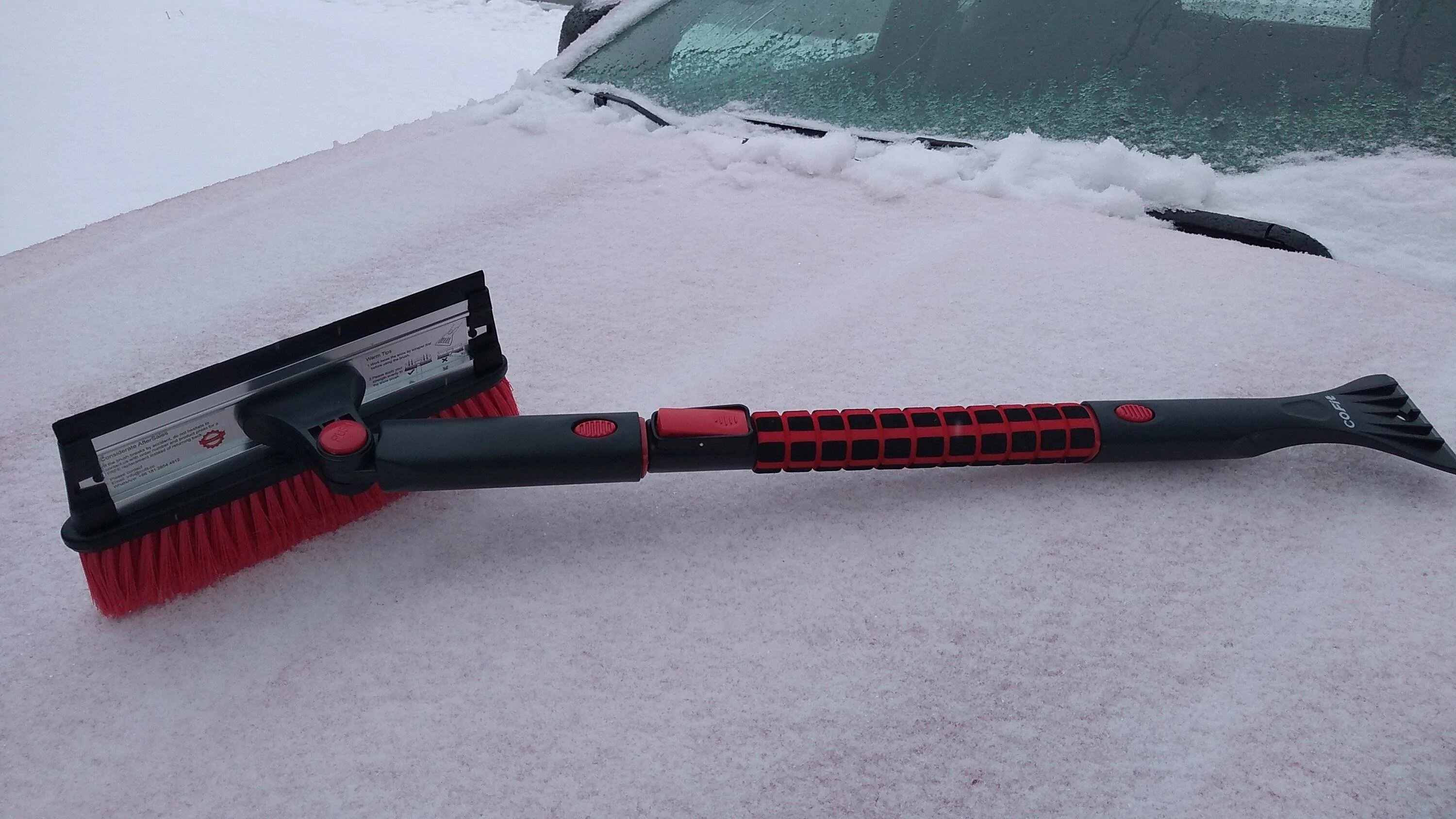

Just in time for some freezing rain and snow later. Much longer than my previous one and easy to reach the entire roof.
https://www.amazon.com/dp/B07YFRDKV9
I had one but didn't have a rotating head on it, made storing it inside the truck a royal PITA.
Ended up getting a standard one. I keep it stored between the rear seat and the seatbelt, with the belt holding it in place, my windshield screen takes it's place for the rest of the time.
4,554
23,154
It's certainly on the big side for storing in the truck. I'd stick it in the bed but the tonneau gets frozen to the tail gate (took most of a can of de-icer to open it last week).

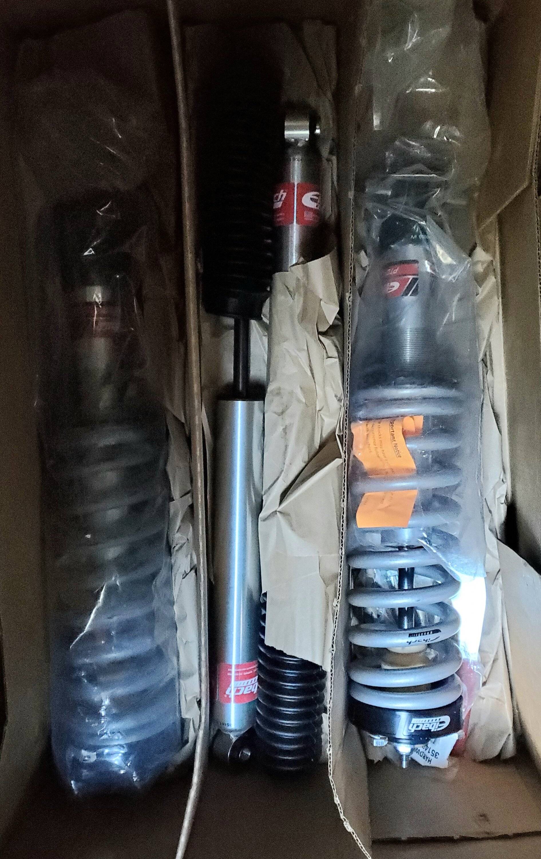

Tomorrow's project. Went by the Ford dealer and picked up replacement nuts for all the ones that get removed. And a 35mm socket. Already have 32 and 36.
Hope the project goes well.
Brian
9,850
47,131
Good luck, help is here if you run into any issues.
9,850
47,131
thank you very much! heading out in the cold to get started.
Pfffft - N. Georgia - you don’t know from cold! ;)
Good luck out there!
TIP: DO NOT do this with one side jacked up at a time - both sides up on jack stands at the same time. ?
Thanks for the tip.
Don't want to.hijack this thread, so i can start a new one. But, i am one bolt in already stuck. The nut that holds the upper end link to the knuckle spins, but doesn't move. So, I can't get it off. It's the 18mm at the top of the knuckle.
Any ideas how to remove it if it won't back out?
It won't tighten nor loosen
Bob902
Bob
May 6, 2021
3,771
20,964
St. Louis
2021 Ranger XLT
RETIRED!!!!
Thanks for the tip.
You need an offset 18mms wrench. If you look closely at the front of the bolt, it is machined for a hex key. Put the hex key ( I think it is 6mm) in a ratchet and with the offset, easy peasy.
