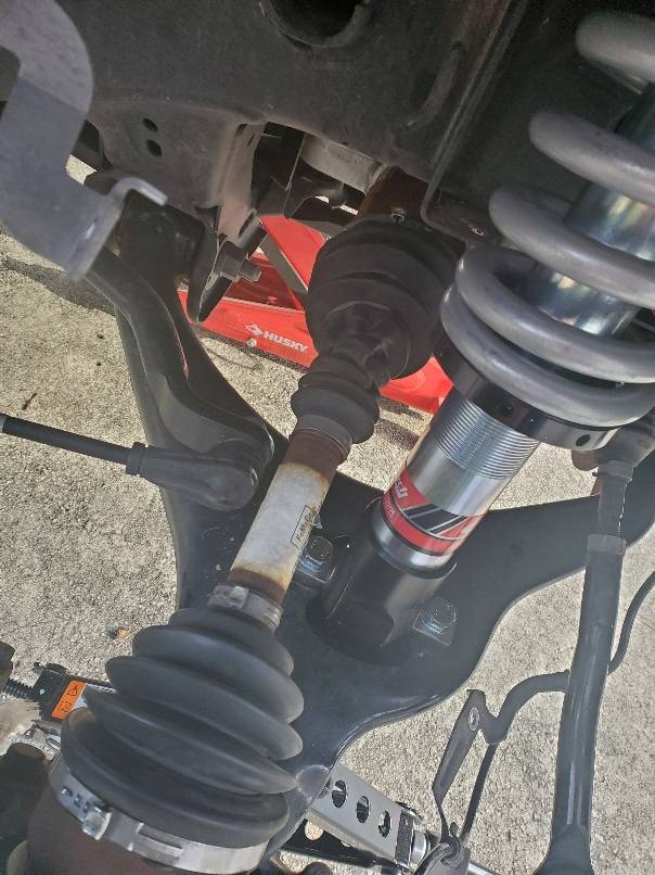

How do you know if you overextended the inner cv?

I cant get the knuckle anywhere close to the upper arm. Axle isnt all the way back in, but that wont be enough to get it there
I ended up using a Jack on the passenger side to get it to where I could connect the upper arm.

Well, i took off the brake caliper and rotor so i could access the axle. Took the wheel end out the hub, and the inner side seems in there. Wont rotate, not mushy or anything

You mean jacked up the opposite side you were working on?
No. Like Duke said earlier, the entire front end needs to be off the ground. So the the passenger that was giving me fits got the Jack under the lower arm and slowly raised the lower arm and knuckle up to meet with the upper arm.

it would also help to have someone else use the Jack while you push and guide the knuckle to the upper arm.
