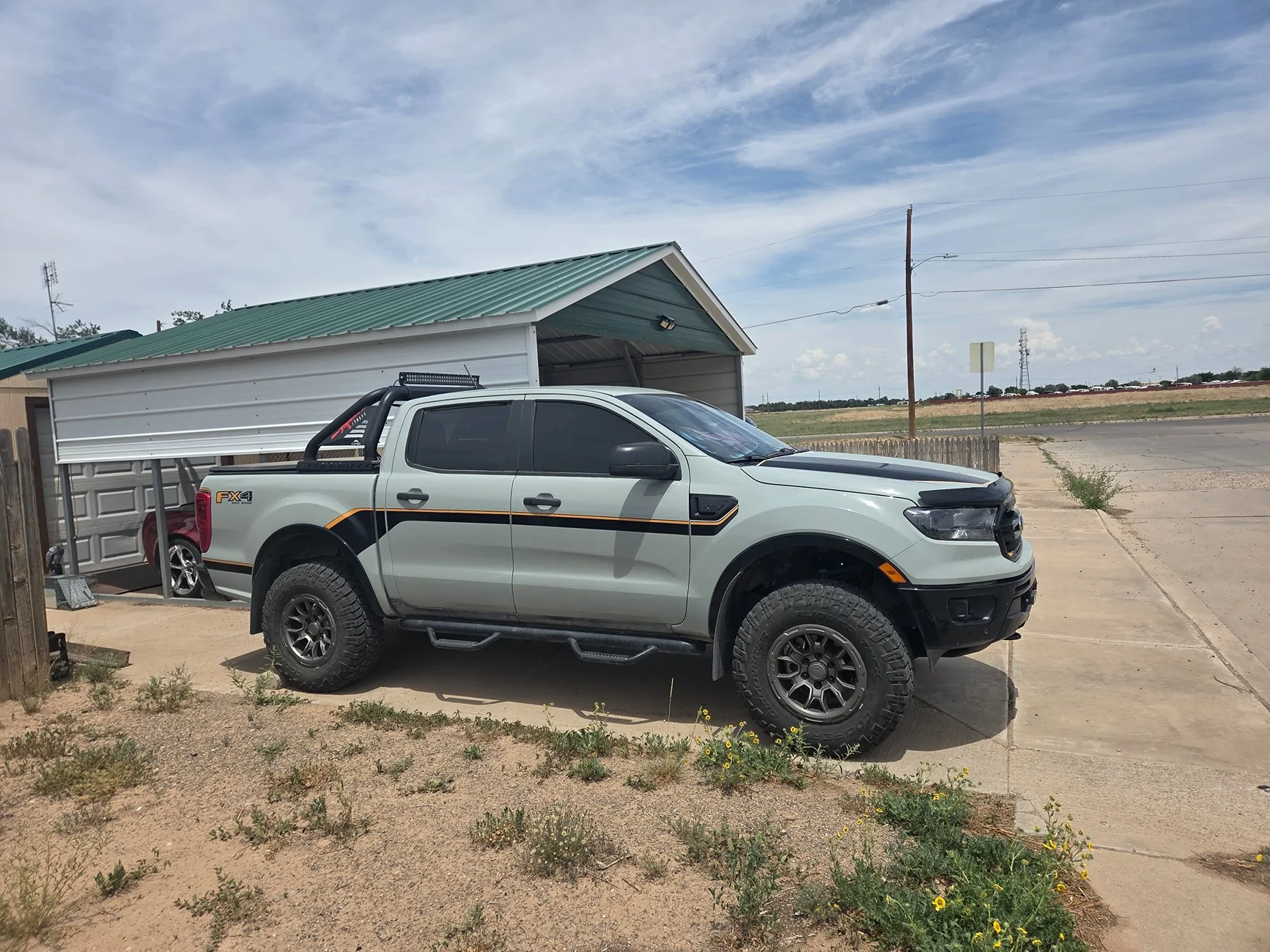

Changed the front lift on the ranger today. Installed a 2 1/2 spacer lift and reset the bilstein 5100's to the .6 in lift position. Got 3" lift total and a way smoother ride. When you crowd the springs with the 2.5 setting on the bilstien's they get harsh. My ride is nice and smooth again. With an awesome stance.

That is a sharp looking truck!! Very nice! 😎

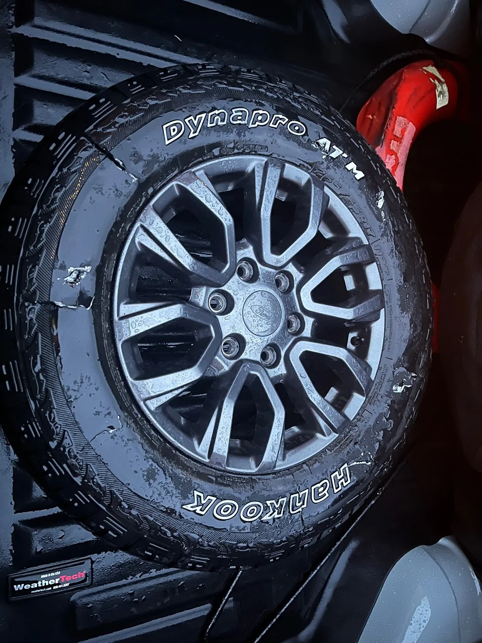

Rear right tire blew on highway in a rain storm. Original Hankook ATMs at under 36k mi. Replaced with the full size spare on the side of the highway.
Was going from crawling in traffic to just barely accelerating and the tire pressure warning came up at 25PSI quickly plummeting. Ended up around 5 psi in a matter of minutes or less. Not sure what caused it. No notable road debris or anything. Just a slow ride in rainy day traffic before seemingly sudden failure.
Managed to have some help with the right tools come by as I was working to get the spare out.
Now I’m trying to figure if I go for a full set replacement now. I had a The Works service about 1k miles ago and the tire wear was noted as “Good”.

Wow, that's a good blowout you'd think would've happened at high speed and not from crawling in traffic. But it's a blessing in disguise it happened that way!
What better time than now to upgrade and get a new full set and maybe go up one size. Heck, while you're at it might as well put on some new shocks and lift it a little more. lol 💸

Will poke around and look at the tire more in the morning. I had a little bit to limp before I could get to an emergency pull-off. The speed at which I lost pressure seems to line up with a sudden failure. While pressure dropped quick and I could sense something wasn’t right, it did take another few minutes before the tire was audibly flat.
