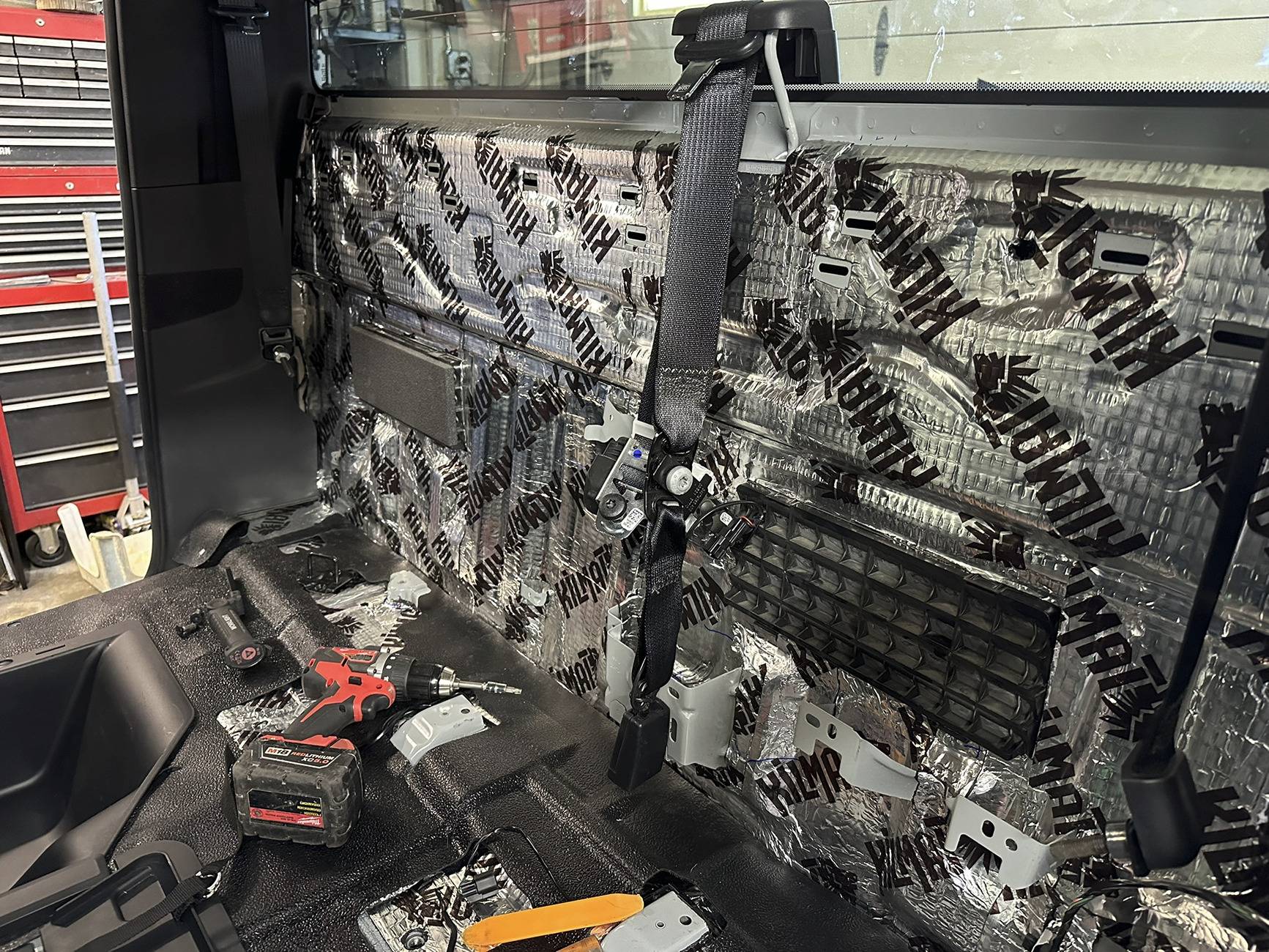

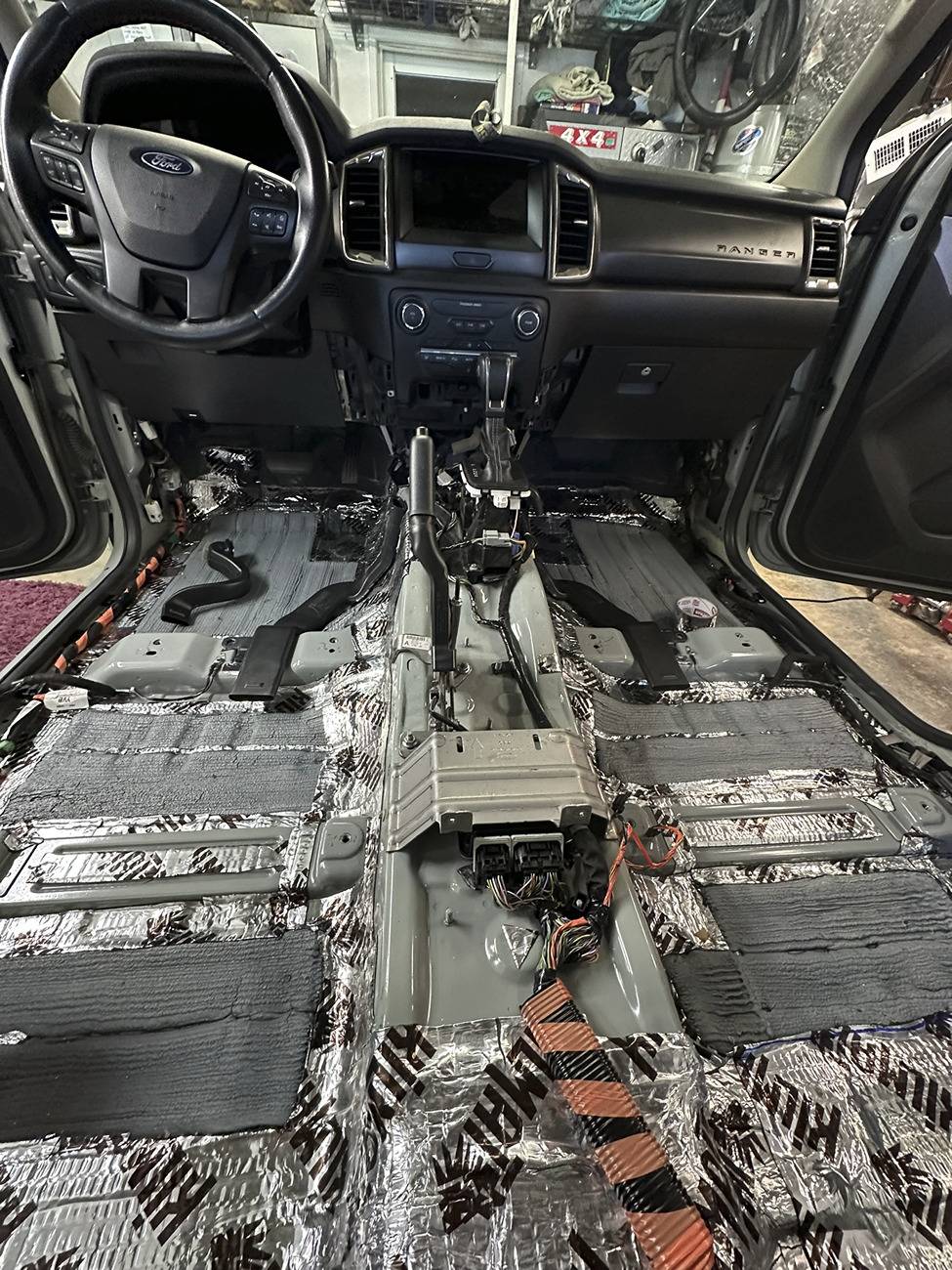

Tore it apart the interior and put it back together, whew, I started out to swap the carpet out with rubber mat, that is due to the dog hair factor, my 7 month old German Shepherd sheds so much, I got frustrated trying to vacuum out under and between the seats, the hair embeds in the carpet, I go to the park with her almost every morning and I am usually vacuuming it when I get back, otherwise.... when the wife gets in she grumbles about being covered in hair.
Anyways, while I was at it I thought "I should just throw in some sound deadener" it took me two days to get it all done. the good part is the cab is so quiet now, I only hear the DI pump now, the trans whine, the tire noise and any under chassis noise is gone, it really surprised me how much of a difference it made, and I used the thin stuff, 50ml for the floor and 80ml for behind the rear seat.
I do highly recommend it, but it's a lot of work, I managed to not break any of the clips that hold all the interior together, but damn you have to be so careful:facepalm:

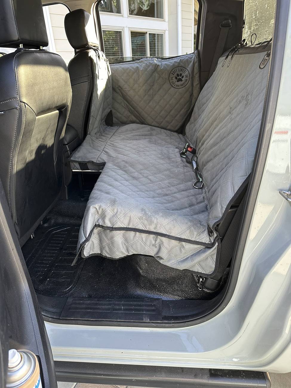

I have almost the same one in the wife"s car, but for the truck I wanted good support in the center at the console because she goes from the front seat to the back seat a lot on trips. I also wanted her to be able to go to the floor, that way she is not jumping the full height of the seat to the ground, Shepherds have bad enough hip problems.
So I made a steel frame with a plastic top and added a cushion, it also makes the under seat access a little easier.
