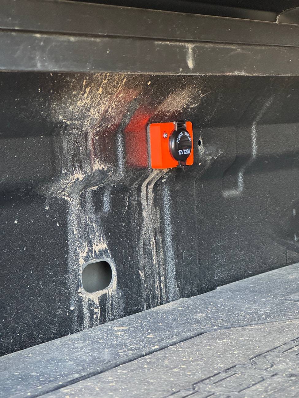

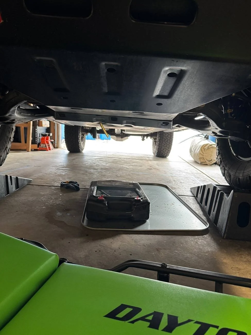

Changed the oil. The Valvomax plug works great, even with the ARB skids. I’m going to order a longer hose for the changes in the future, but… it made quick work of the change.
I also installed my Wolf Haus adapter in the bed. I’ll change Forscan tomorrow to allow it to run my fridge overnight.

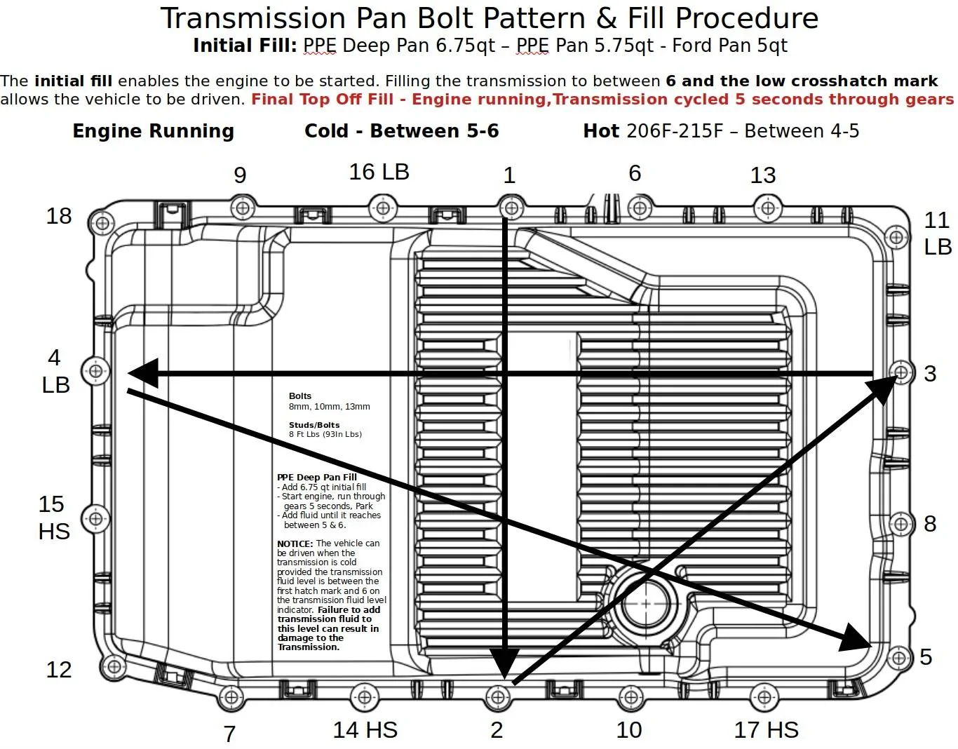

So I sat down and finished a diagram a couple of days ago using Sean's (seanellaz) bolt pattern chart as inspiration, I modified PPE's bolt pattern tightening sequence, included bits of Ford's Official fill procedure from 307-01 Automatic Transmission - 10 Speed Automatic Transmission - 10R80 General Procedures, and added a pinch of practical Fluid level checking wisdom of Youtube's Ford Tech Makuloco. Here's my new chart updated from what I learned after the install and fluid level check.
This image perspective s looking down into the pan.
BTW, A public "Thank you" to Sean (seanellaz) for creating and posting his chart.
Anyway, I successfully installed the PPE Deep Transmission pan yesterday, and modified my original diagram and instructions for what worked for me.
I pulled out 5 qt of fluid 4 days ago, another qt 3 days ago, and yet another qt 2 days ago. I pulled almost another qt from what was left in the pan and filter yesterday when I removed the pan.
So almost 8 qts were pulled out over 4 days time.

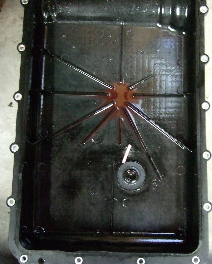

Here's a picture of the pan...with the errant heat shrink in the bottom, in one piece no less. I'll clean it up in the morning.
