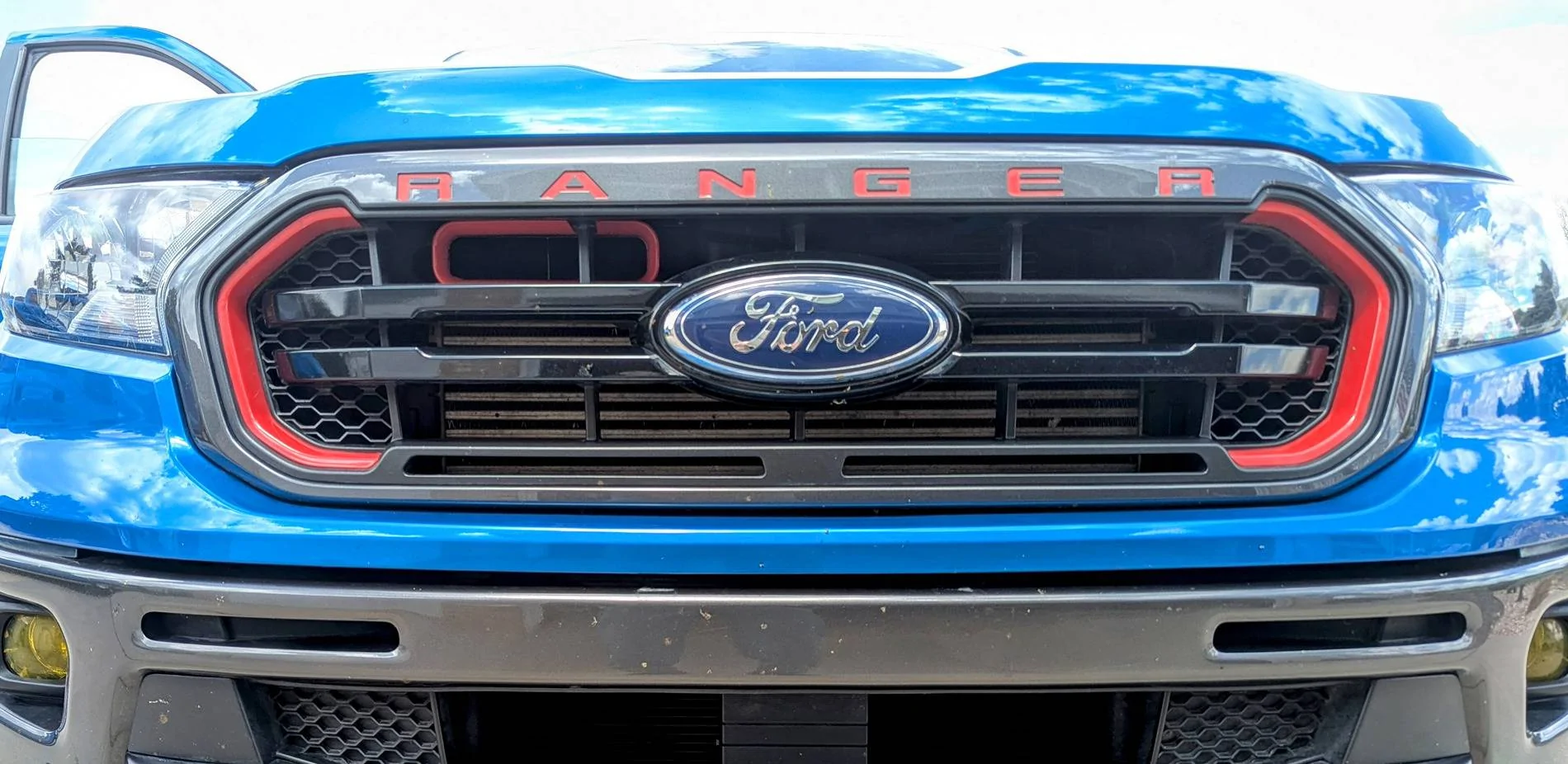

Looks great with the rest of your red accents.
Brian
Thanks. Red works with my truck.

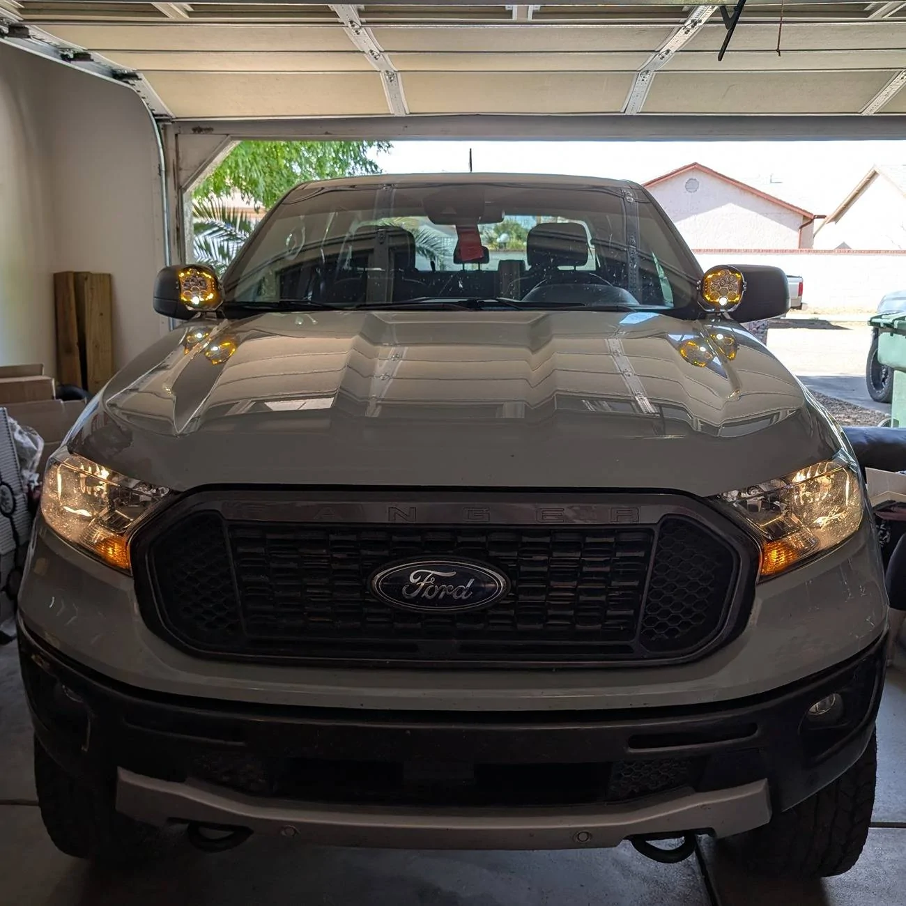

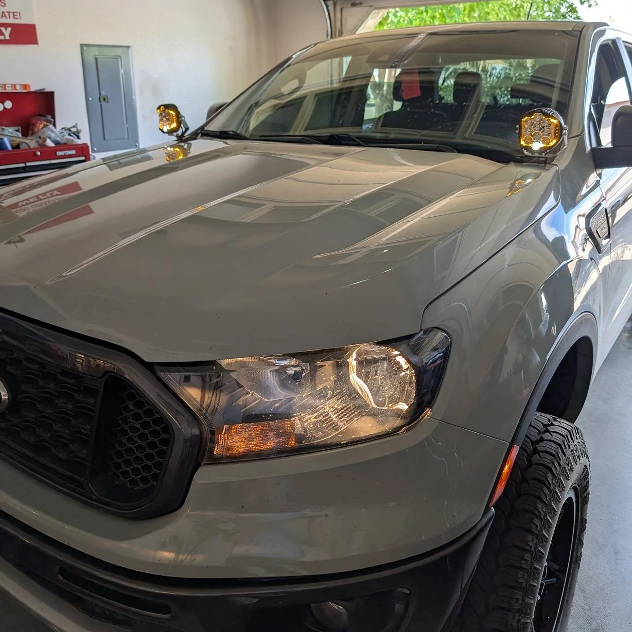

I added some ditch/hood lights and an auxiliary switch panel in-cab.
The stock headlights and LED fog lights just weren't cutting it while tooling around out in the dark desert, mountains, and forests nearby... We simply couldn't see nearly wide or far enough for comfort.
Mounted (x2) 5in spot/flood combo light pods. a 6-gang switch panel and relay system and tapped the power-steering fuse for accessory power... If anyone wants additional pictures, parts links, or more details, let me know and I'll send those over or do a bit of a write-up.
Testing the daytime running lights:

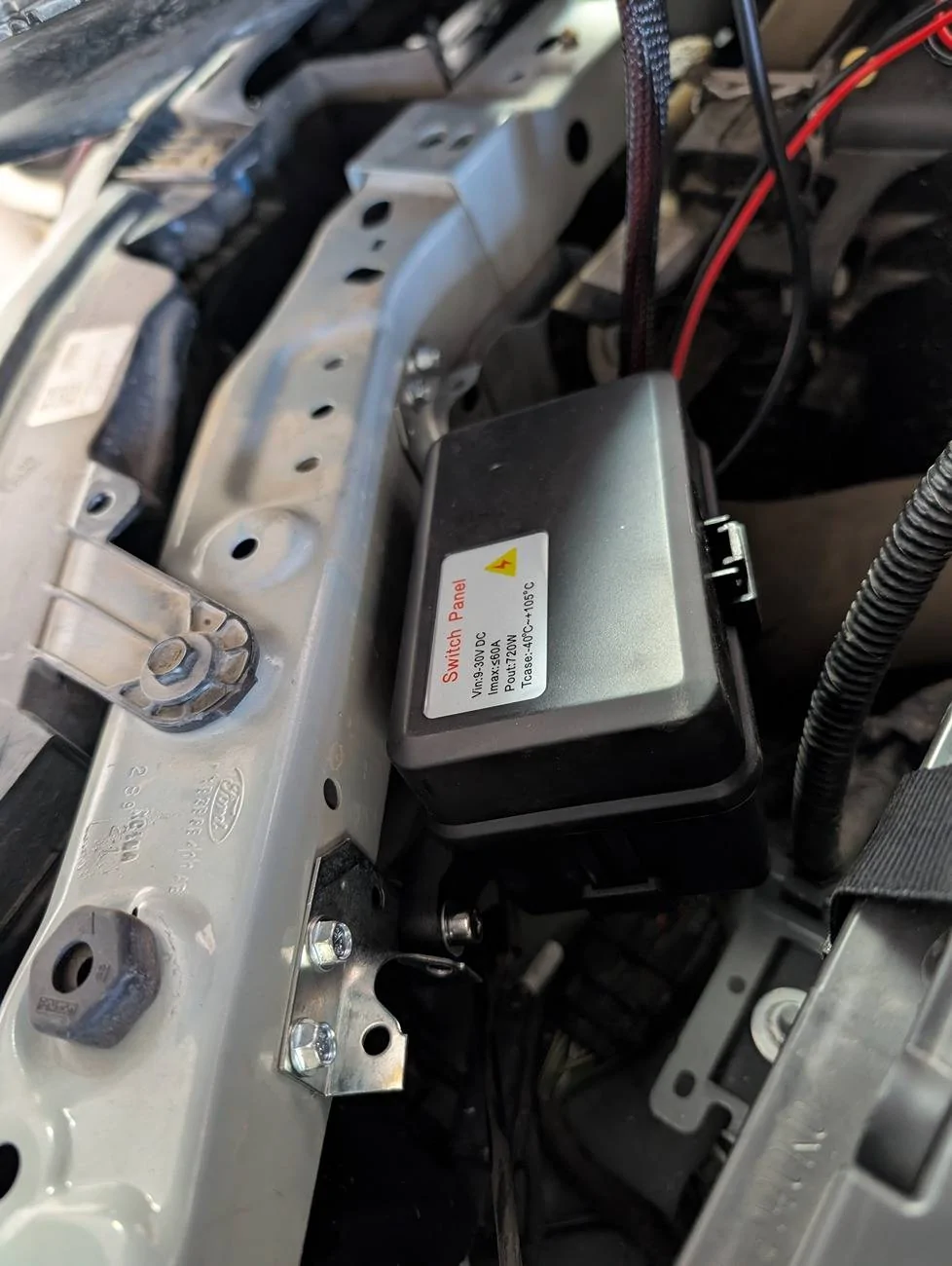

Mocking up the relay box:

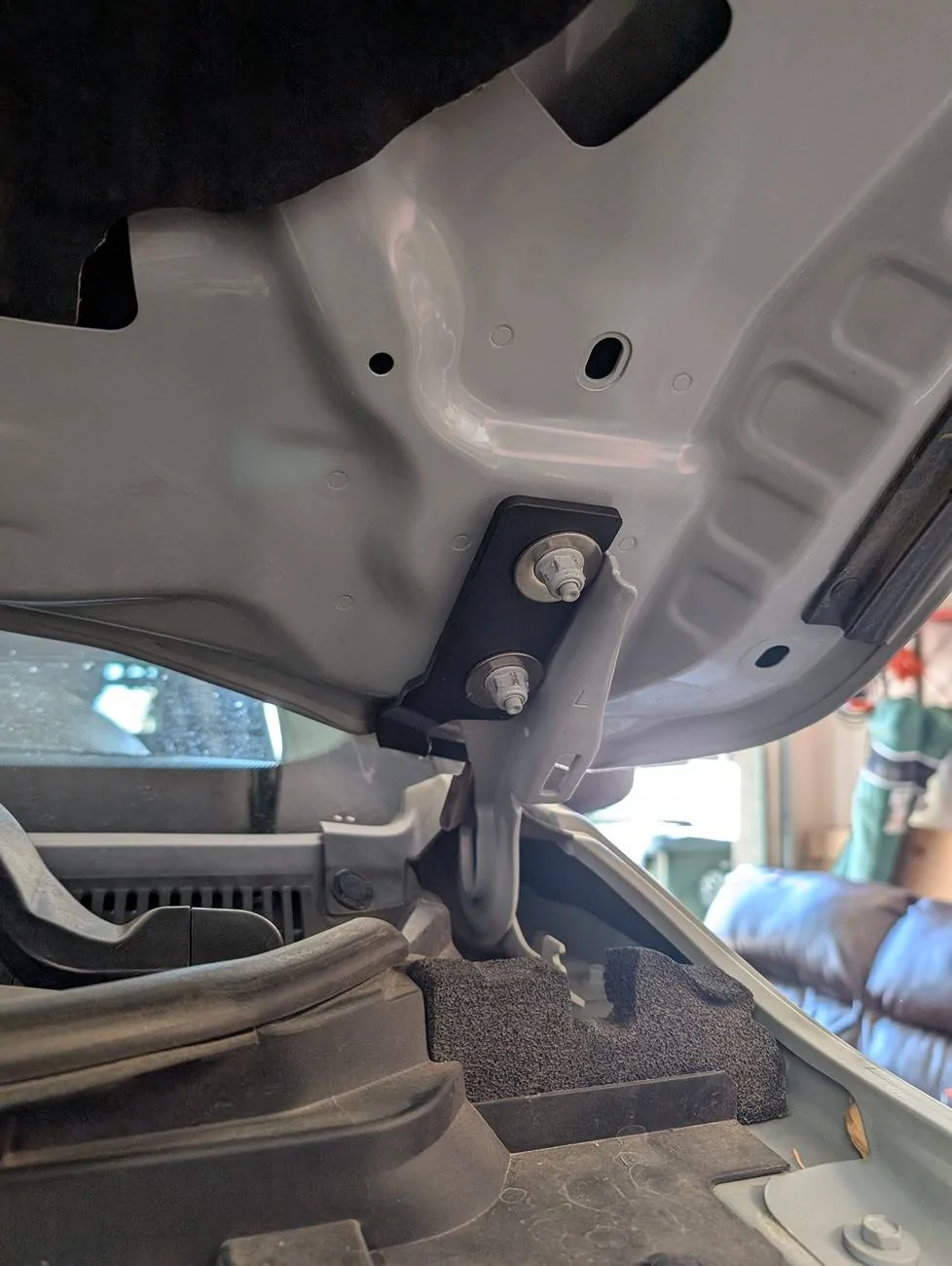

I utilized a couple old L-brackets I had laying around, drilled some pilot holes in the body and used metal-to-metal self-tappers to create a drop bracket and place the box below the front plastic trim behind the driver's side headlight. When mounted here, the relay box can still be opened to access the fuses, and the headlight bulbs are mostly accessible without moving anything around.
Cheap brackets with washers added for a better "bite" and stability.
Took the new setup out for testing yesterday evening, and I'd say they already paid for themselves. Had a pack of 4 mule deer run out in the road ahead of us, and we were able to spot them at roughly twice the distance my headlights and fog lights were able to make them visible at.
Twinsies !
Love it ! Those look awesome on your truck. I had considered those lights. Then I got a bug up my ass to go with 4 cubes instead. Now,,, I'm going through a "phase" were I cant stop adding lights. Fogs and another set of grill bumper lights (RC) are next. I may change it in the future and get the ones you bought.
