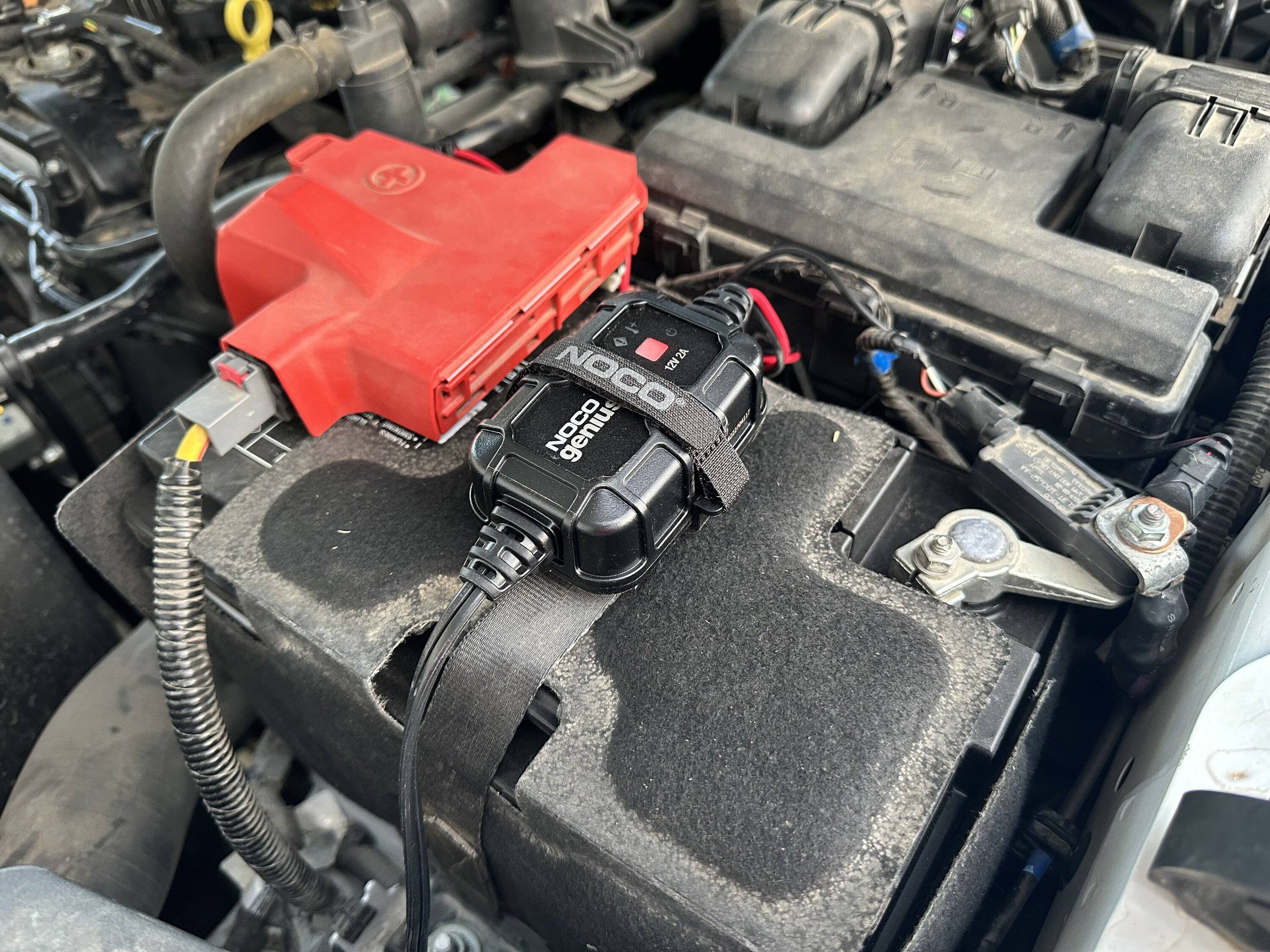

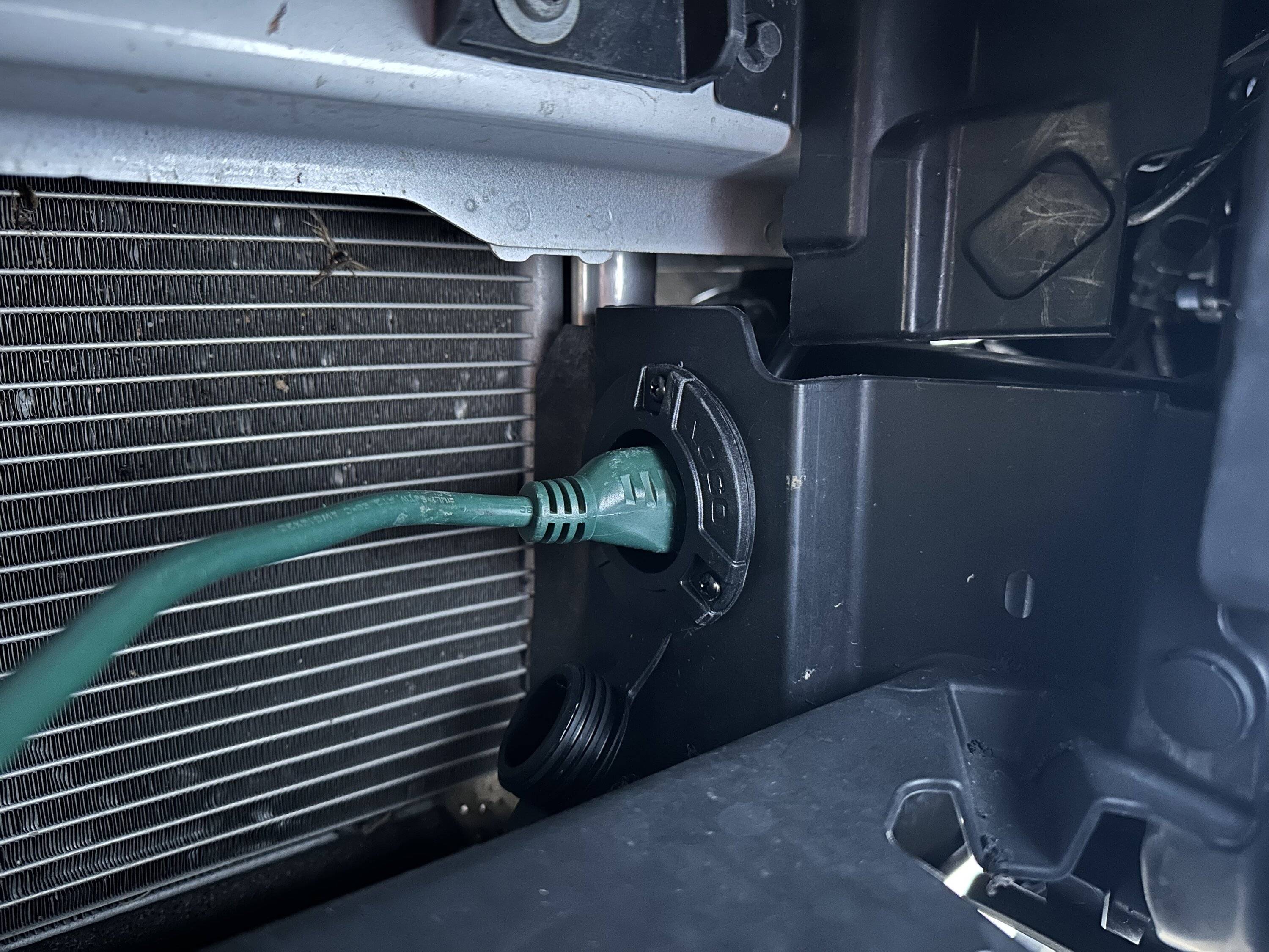

My truck sits a lot since I work from home. So I picked up one of the NOCO 2A on-board battery maintainers and the NOCO A/C receptacle for a clean install.
Used a 2” hole saw to make a pass through in the plastic beside the radiator that is there guide air through it.
