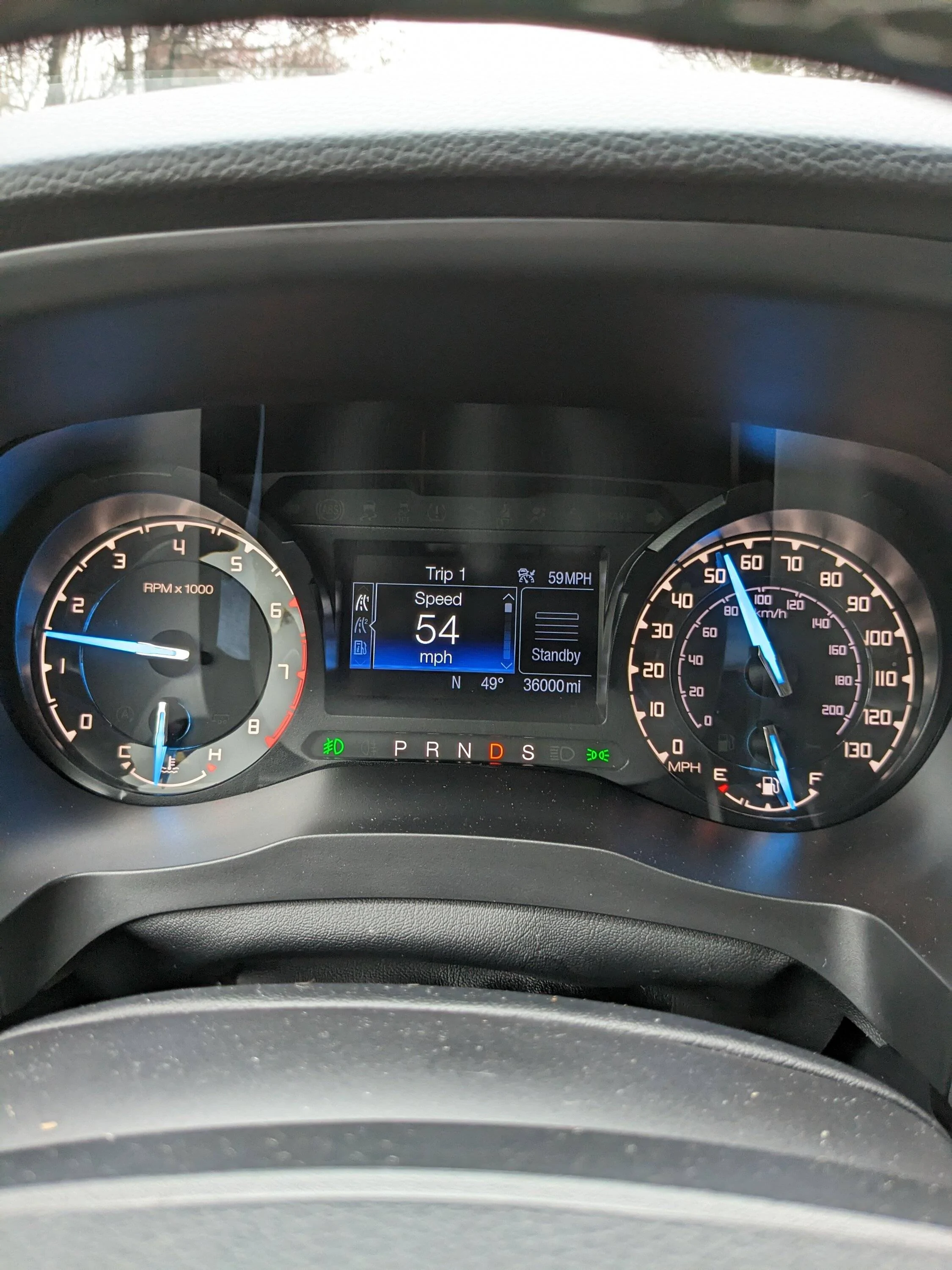

Hit the magic number this afternoon, 36,000 miles, on my own for repairs, no extended warranty, no warranty issues since day one
Powertrain goes 5 years and 60k on warranty, correct?

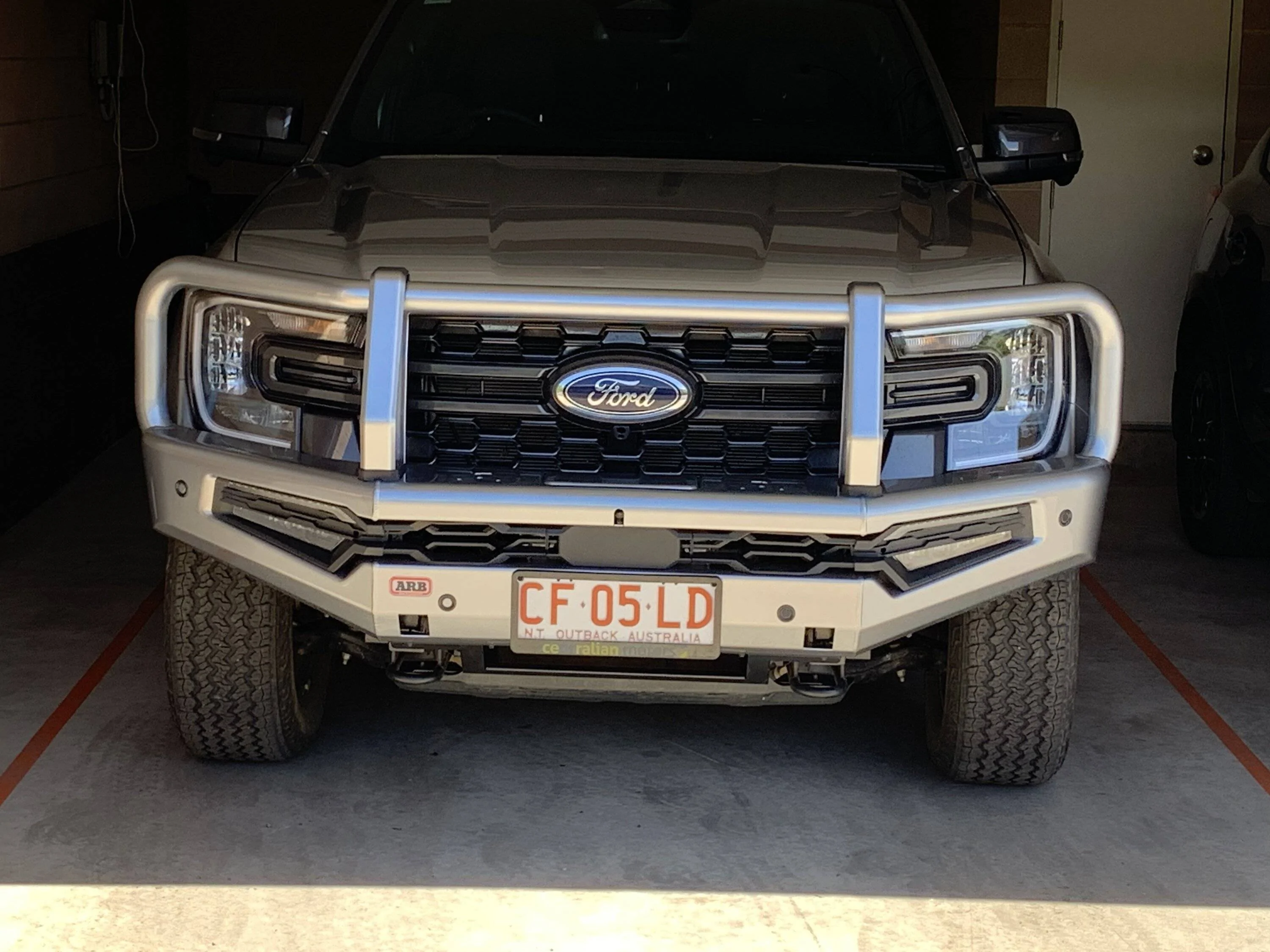

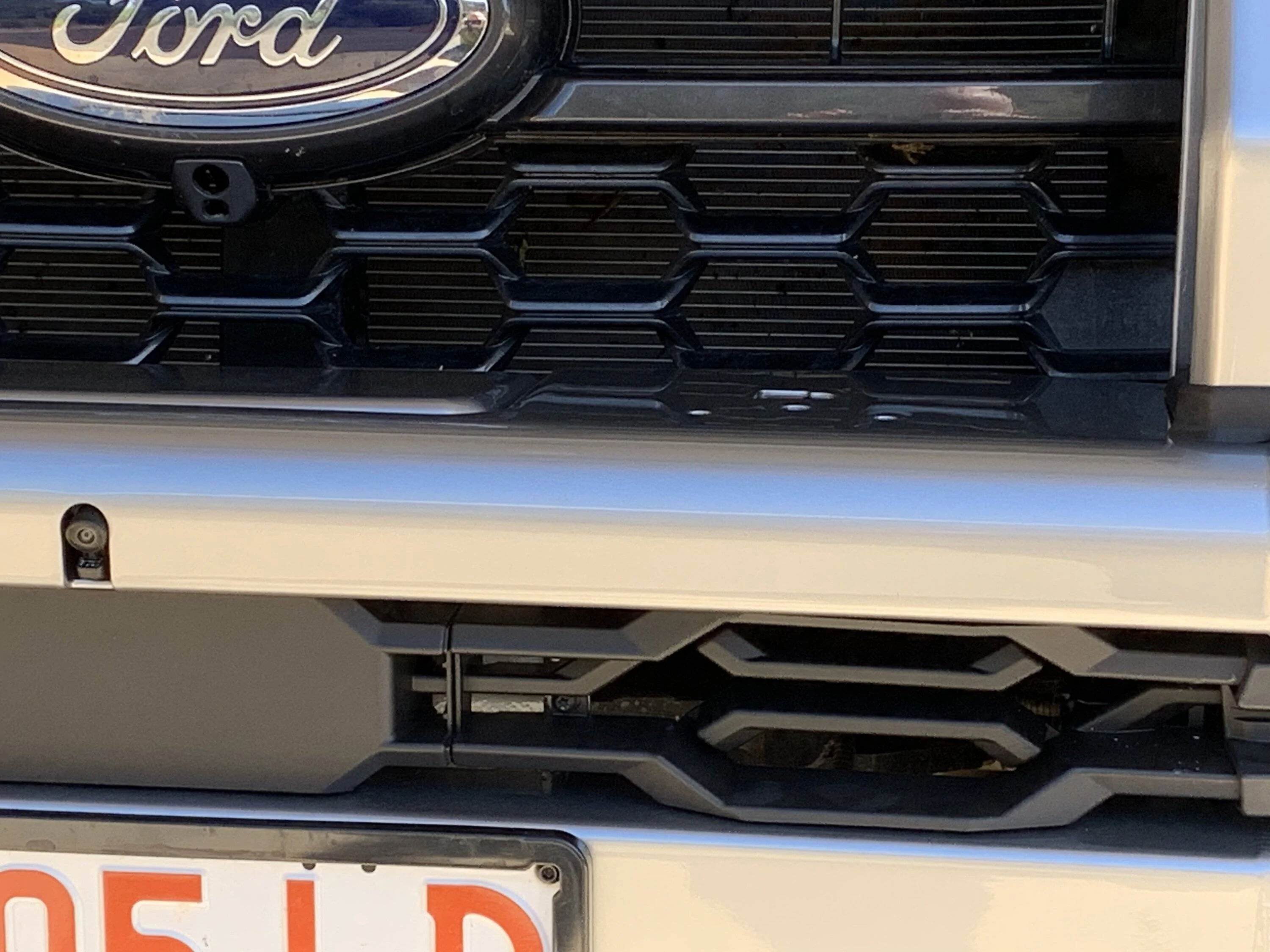

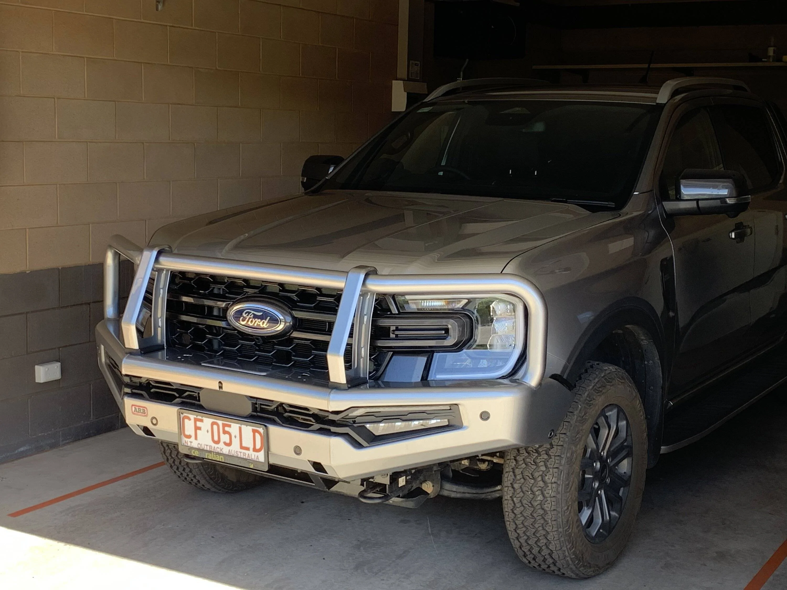

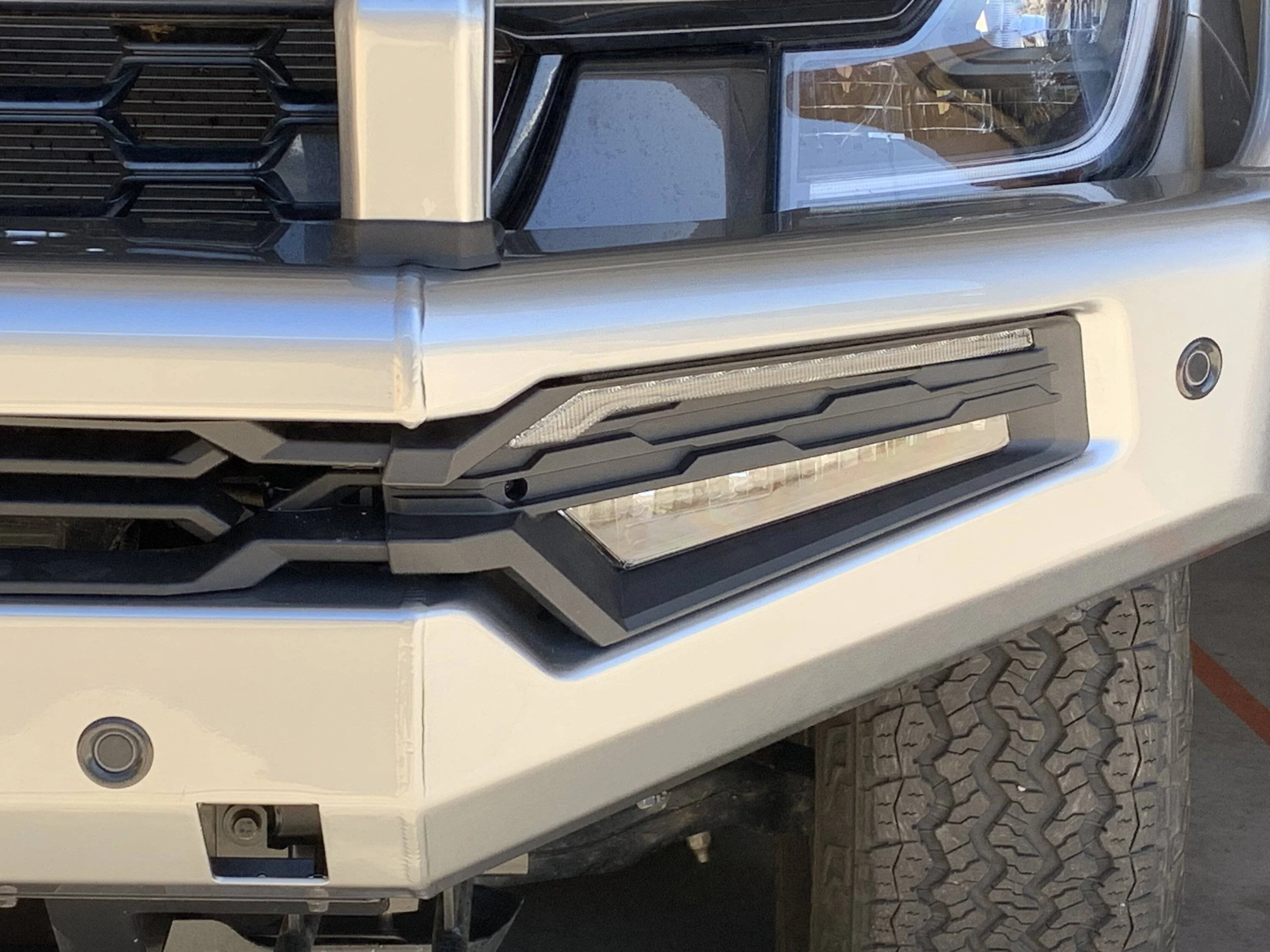

Added the ARB Summit bull bar to my Gen 6 WildTrak today. Well made, great fit and finish, and engineered along with Ford for full integration. All front sensors and front camera seamlessly relocated into the designed locations on the bar so all systems retained full functionality. Bar insets match the grille design and the bar was painted to match. It is also fully covered under the 5 year unlimited mileage warranty due to the ARB/Ford partnership… well done all the way around…
WOW, that looks amazing! 6G with ARB = sweet!

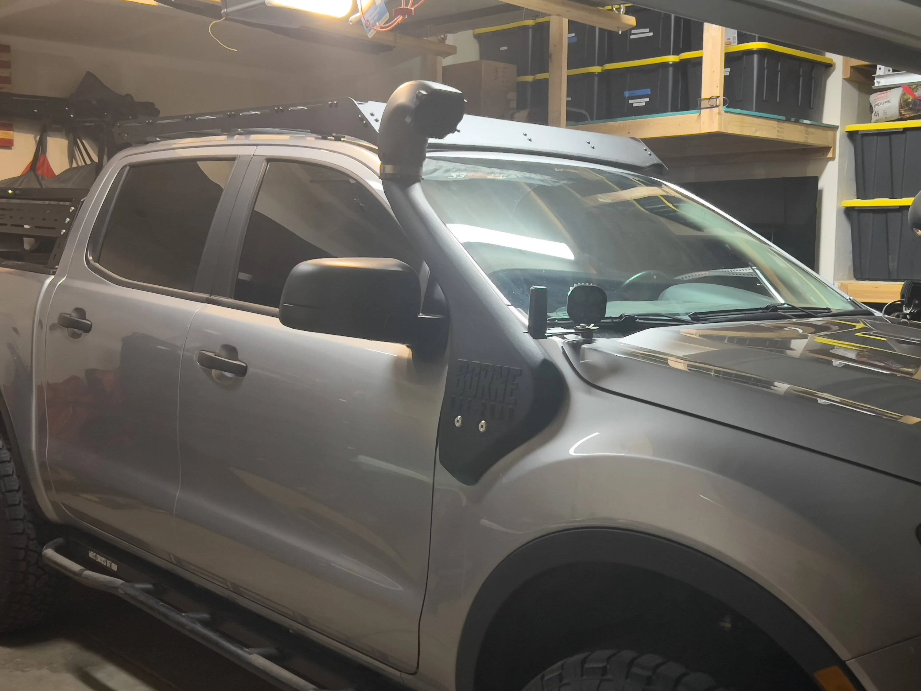

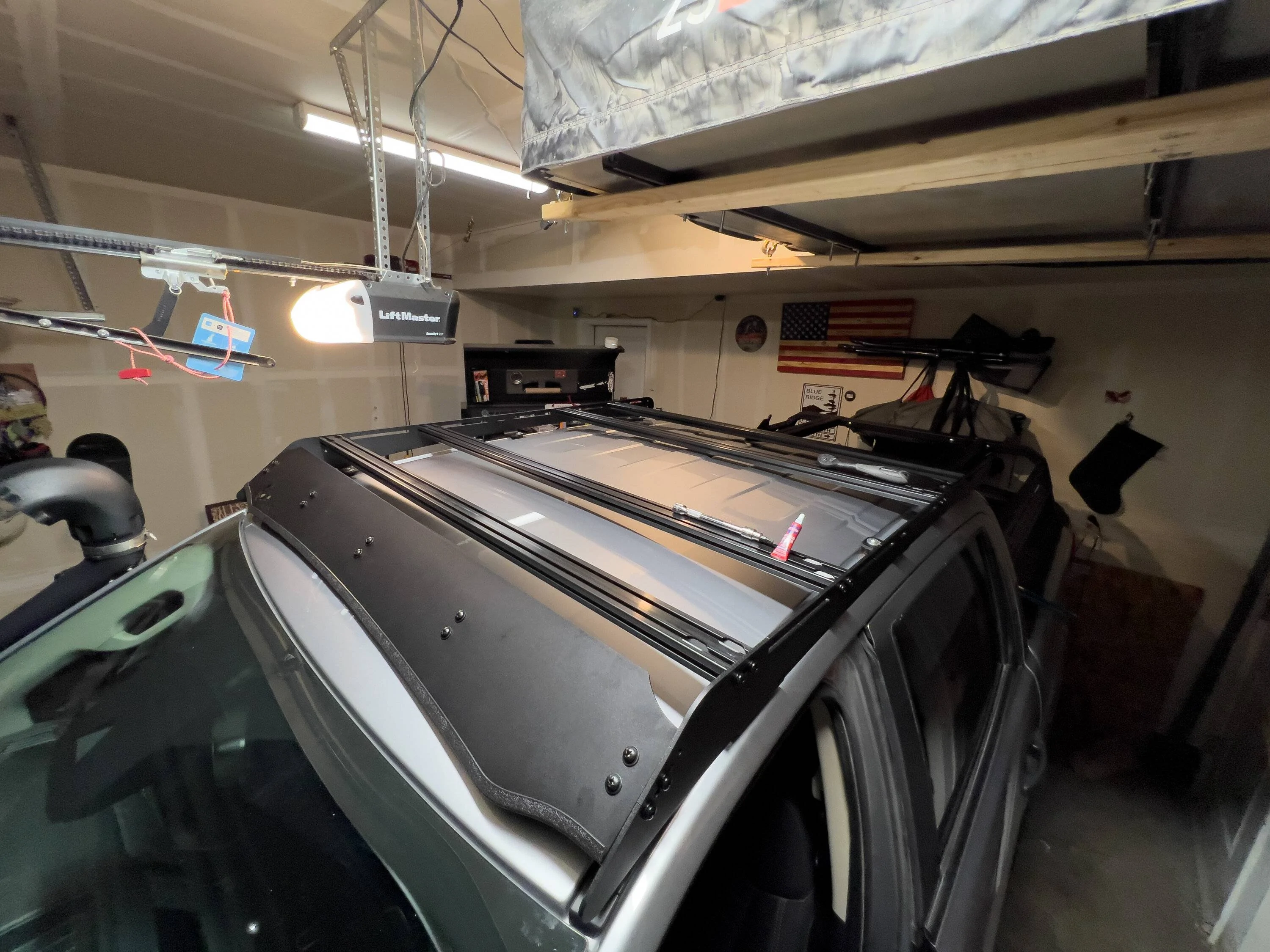

I hope it goes smoothly for you. I puckered up tighter than a frog when I drilled into my topper for my Rhino Rack - I can’t imagine how I’d feel drilling into my truck. :D
Good luck with the install. Have one of your helpers take pics of the process if you can.
it went quite smooth. Letting it sit tonight, so the silicon can set. Had one failed rivnut, but other than that, it went fine. Took about 5.5 hours and we took our time.
better pictures to come.

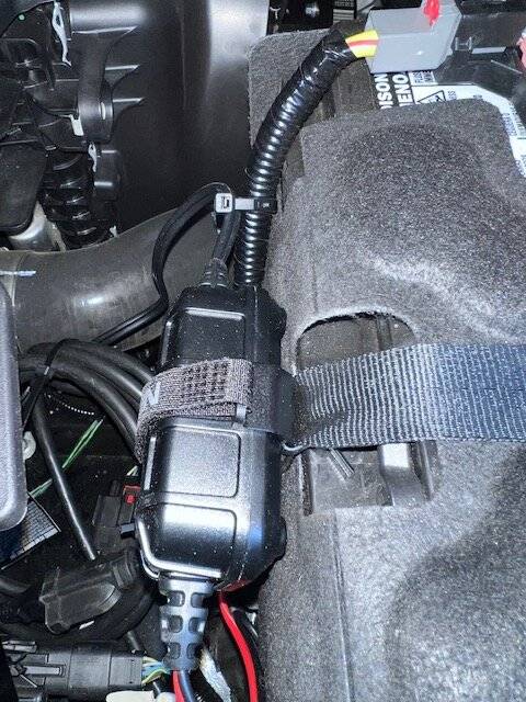

Don't put a lot of miles on the Ranger so this was long overdue. I think this unit was like $30 with a lot of good reviews. Spent a couple hours installing this NOCO BM. It's an onboard version, so this is where it ended up.
They provide a mounting bracket with screws but there isn't a ton of room for a screw mount so I went with zip ties (best invention ever) and it worked out.

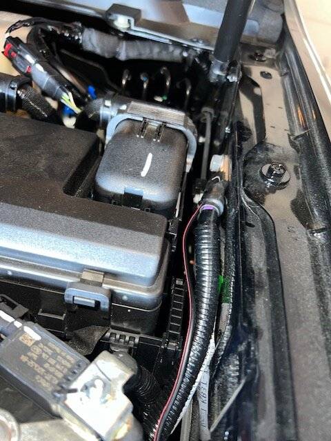

Ran the ground to the frame. I could just get the ground screw out. Had to flip the latch on the left though.
Direction say to mount it to the battery terminal but I wanted it to attach before the BMS sensor.

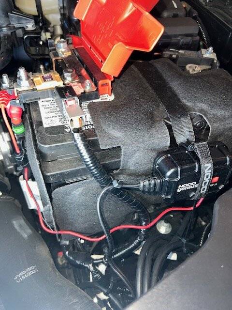

This is kinda of top view. You can see the top zip tie. Holds very firm!

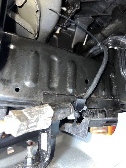

The last part is a bit of a PITA. I ran the extension down past the radiator and around the frame. Then through the front past the ACC. Then over the frame and down in back of the bumper on the PS. And yes, zip tied it. Turned out very firm and out of the way. Done!
The End ??
i just picked one of these up myself, thanks for the install pics
