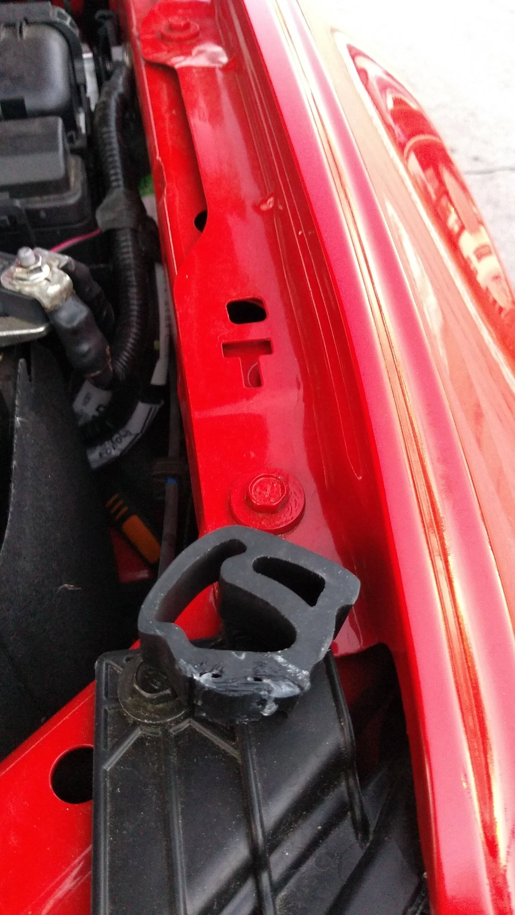

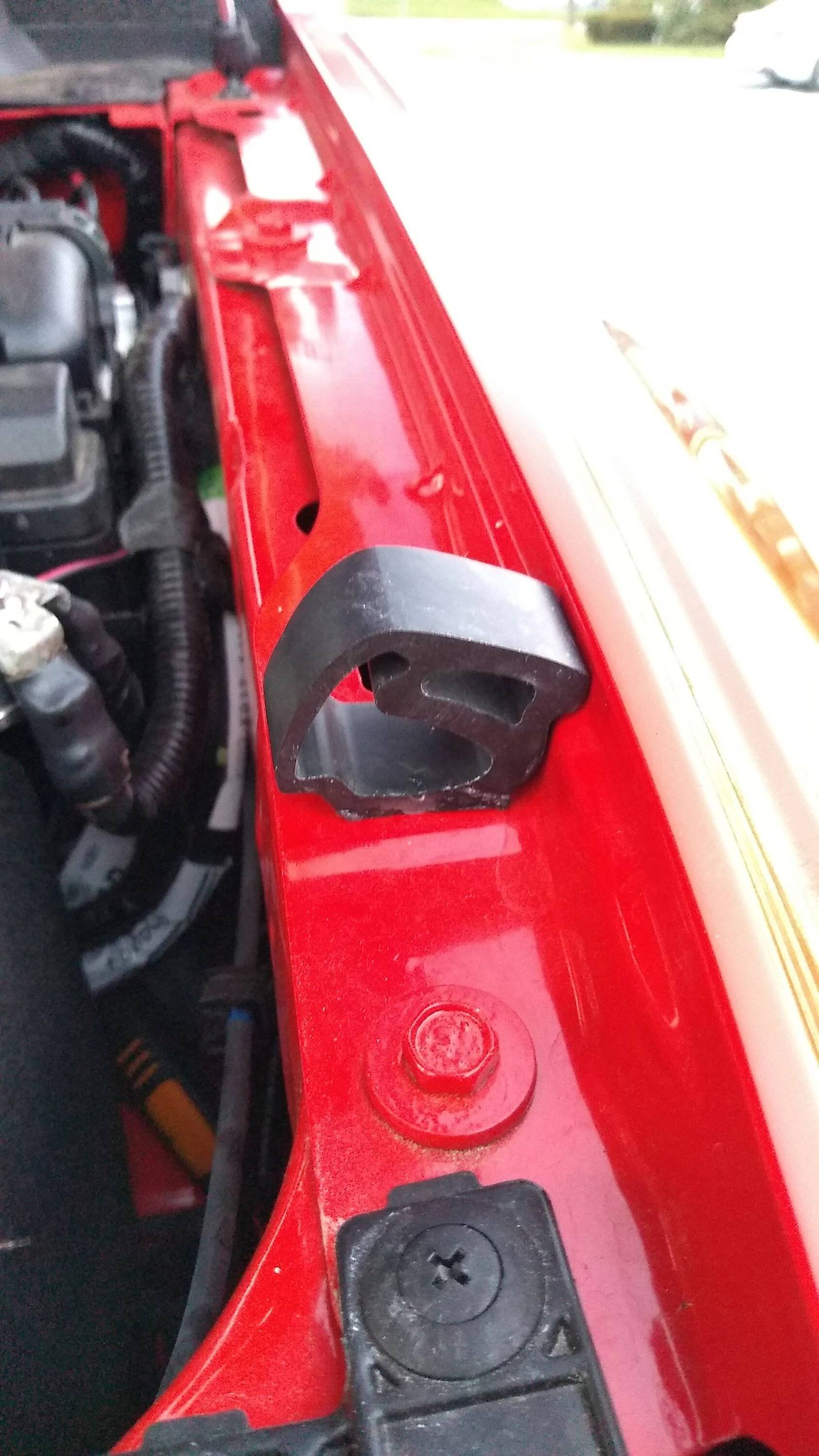

Even though it's 35° out and the rubber might be stiff, I just had to install the hood bumpers. And it reminded me of another deleted item: hood struts.
I used a little silicone paste (probably not needed, they slot in easily).
And the bunny faces in for proper install (thanks @RedDakooter05).
Now the hood will rattle less and not annoy the engine cover mice.

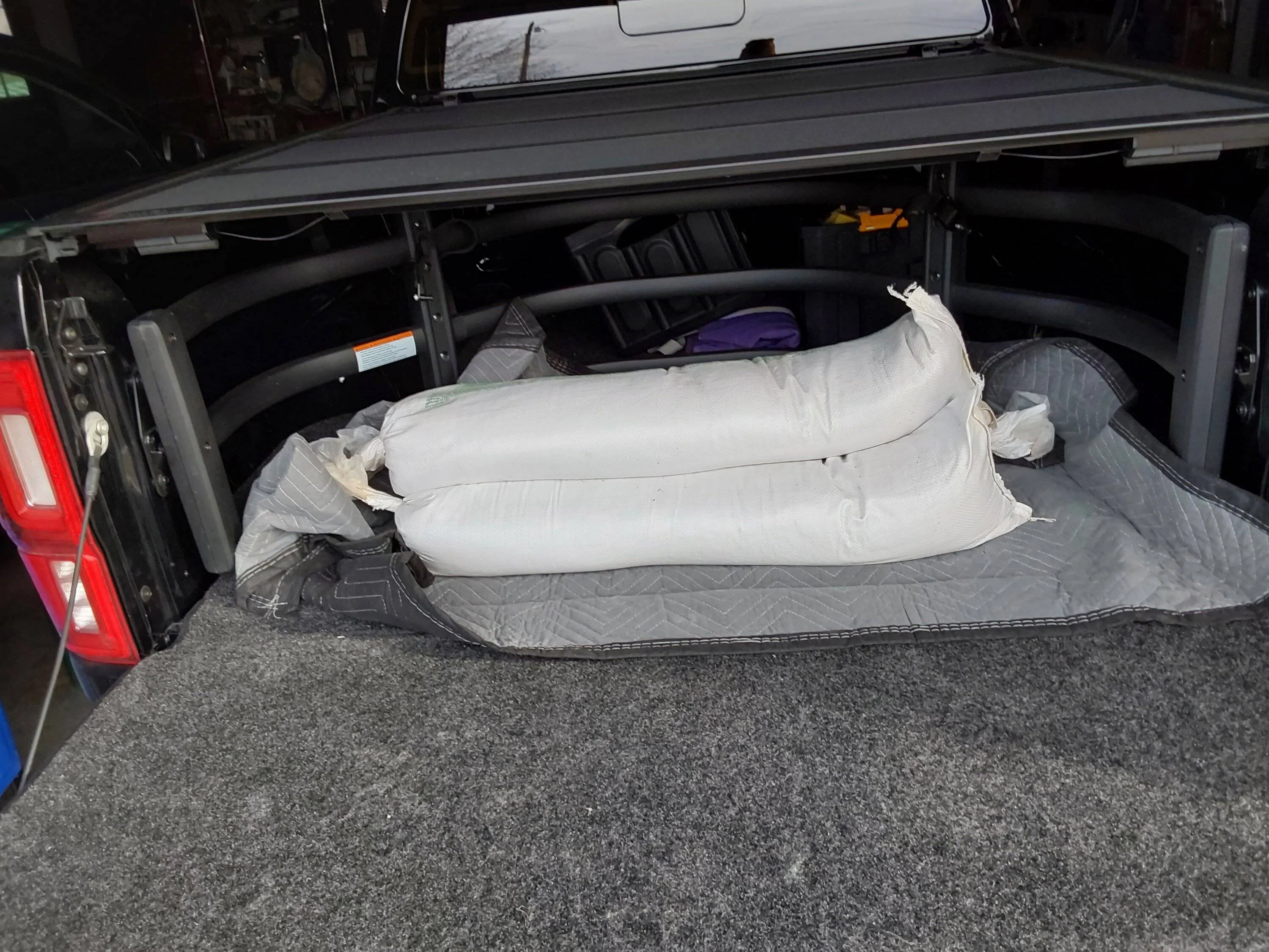

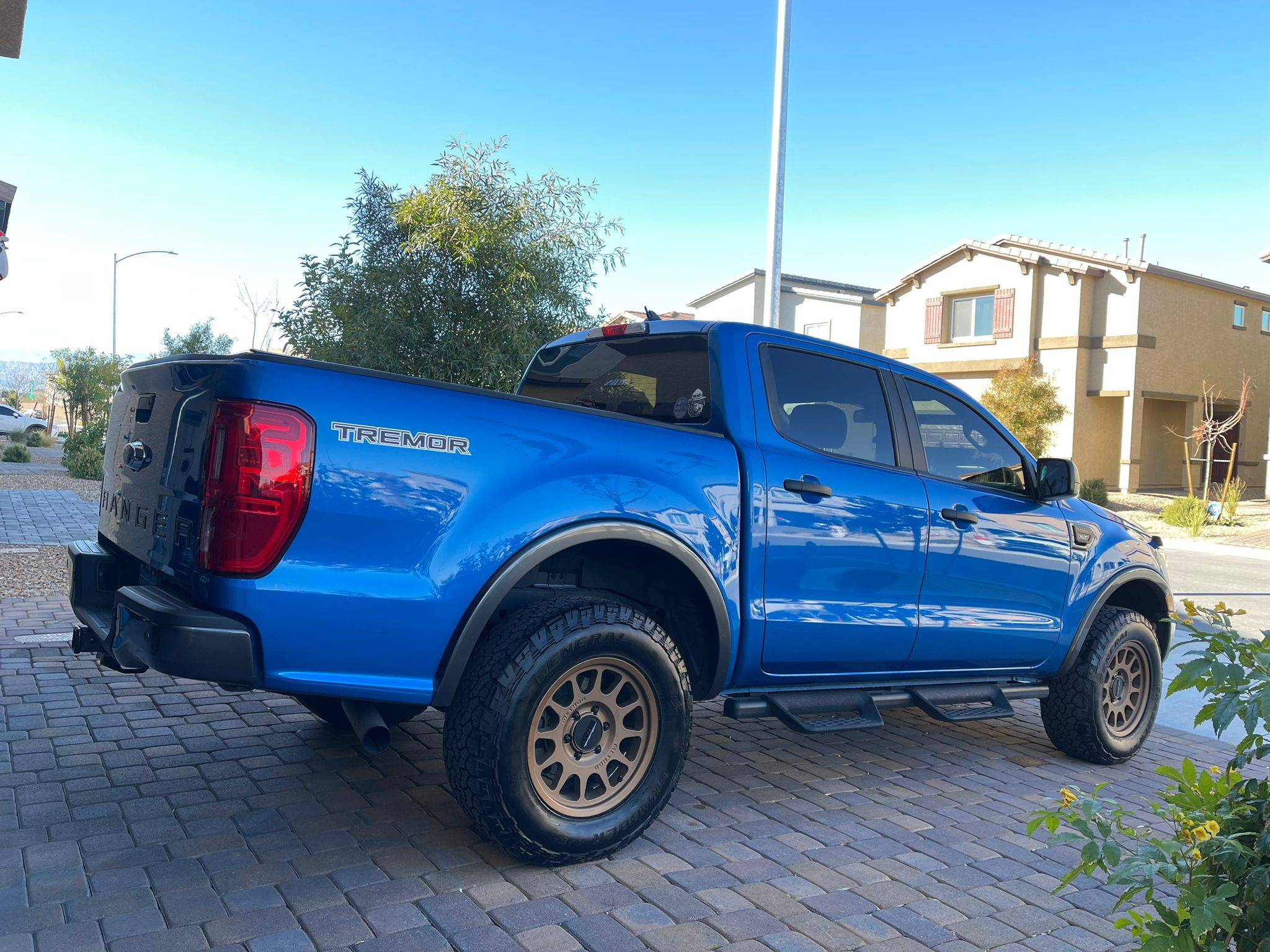

I leveled it and made it ride like a Cadillac for under $20.00 ?. 3 bags of wet sand at 200 pounds total was what the engineers must have used for testing. May keep it there year round.
Ed I have a couple of those sand tubes in back too. I will leave them in until spring then take them out. They are sure nice to have back there!

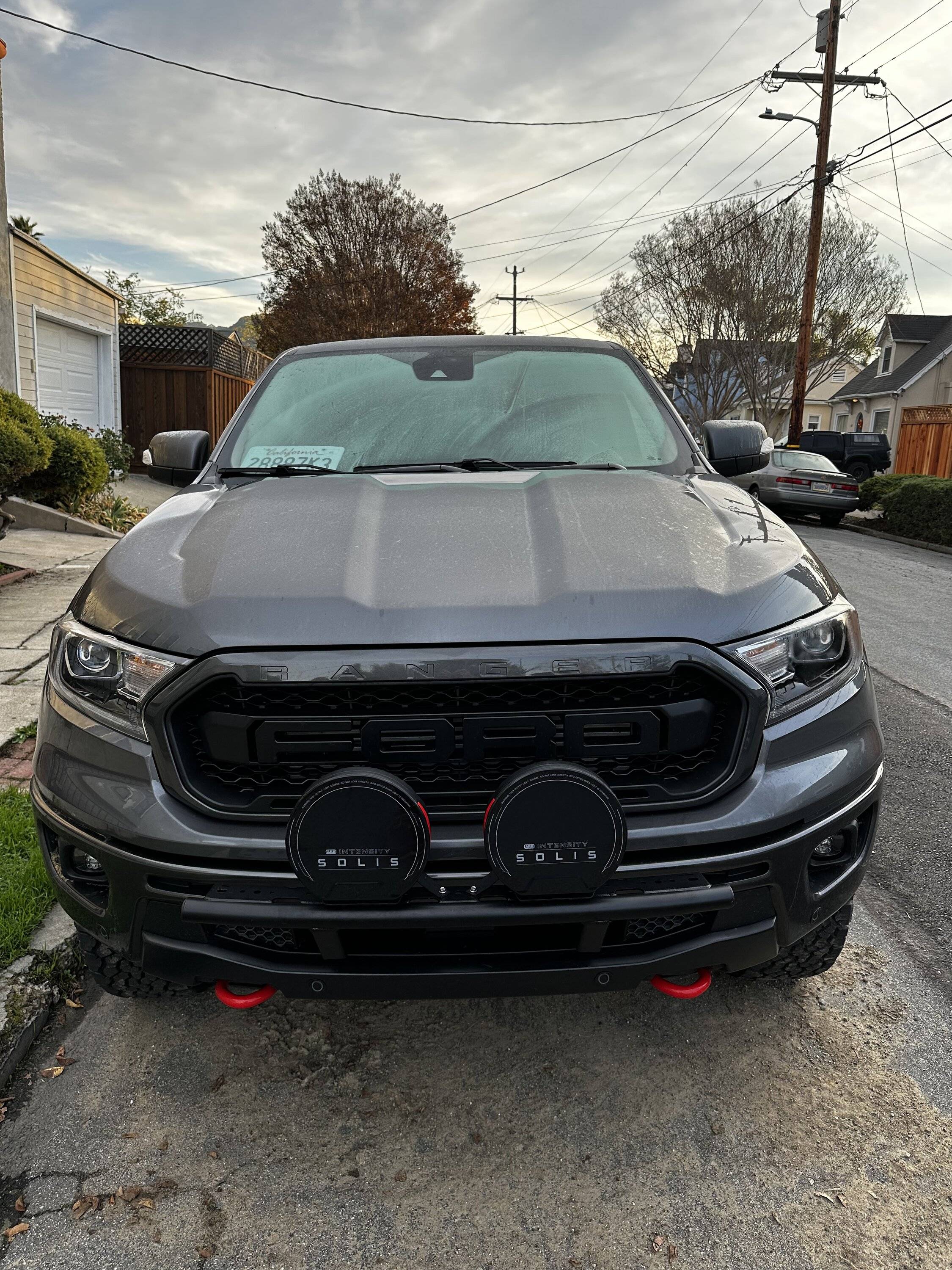

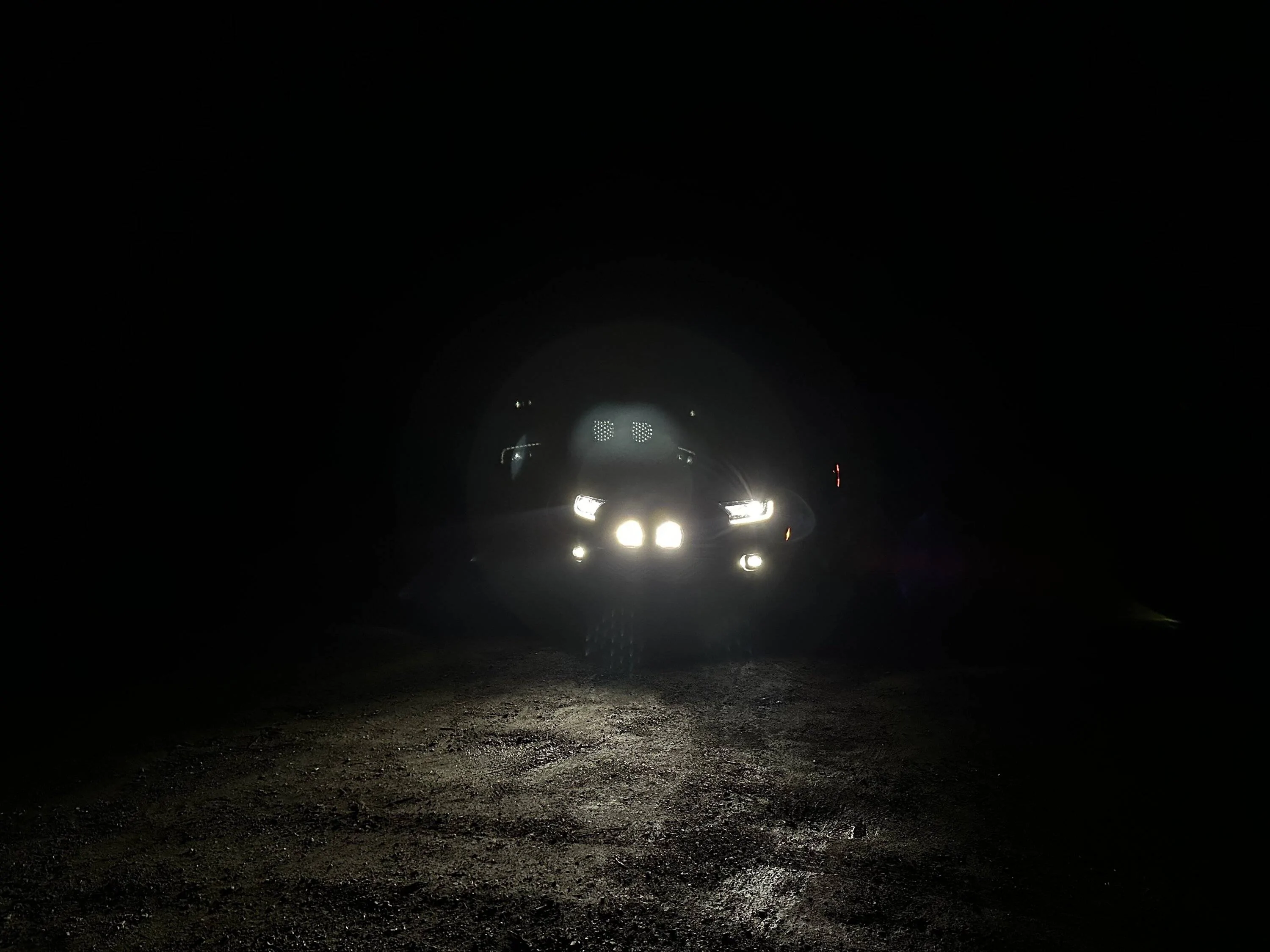

It’s been a while since I did anything to the Ranger… Which means I was overdue!
So over the last couple of days I installed an SVC Off-road light/bull bar, and a flood/spot ARB Solis 36 combo. I also fabbed up some extra braces for the bar since it flexed more than I liked. Ended up w/2 16-gauge steel braces extending from the center of the bar to the slots in the bumper where the plastic license plate holder was snapped on. Still need to make a new plate holder for the bar.

That looks so good! I would like to do similar with large, old school KC Daylighters like I had on my FJ40.
Thanks for the pics and how you reinforced it. =)
