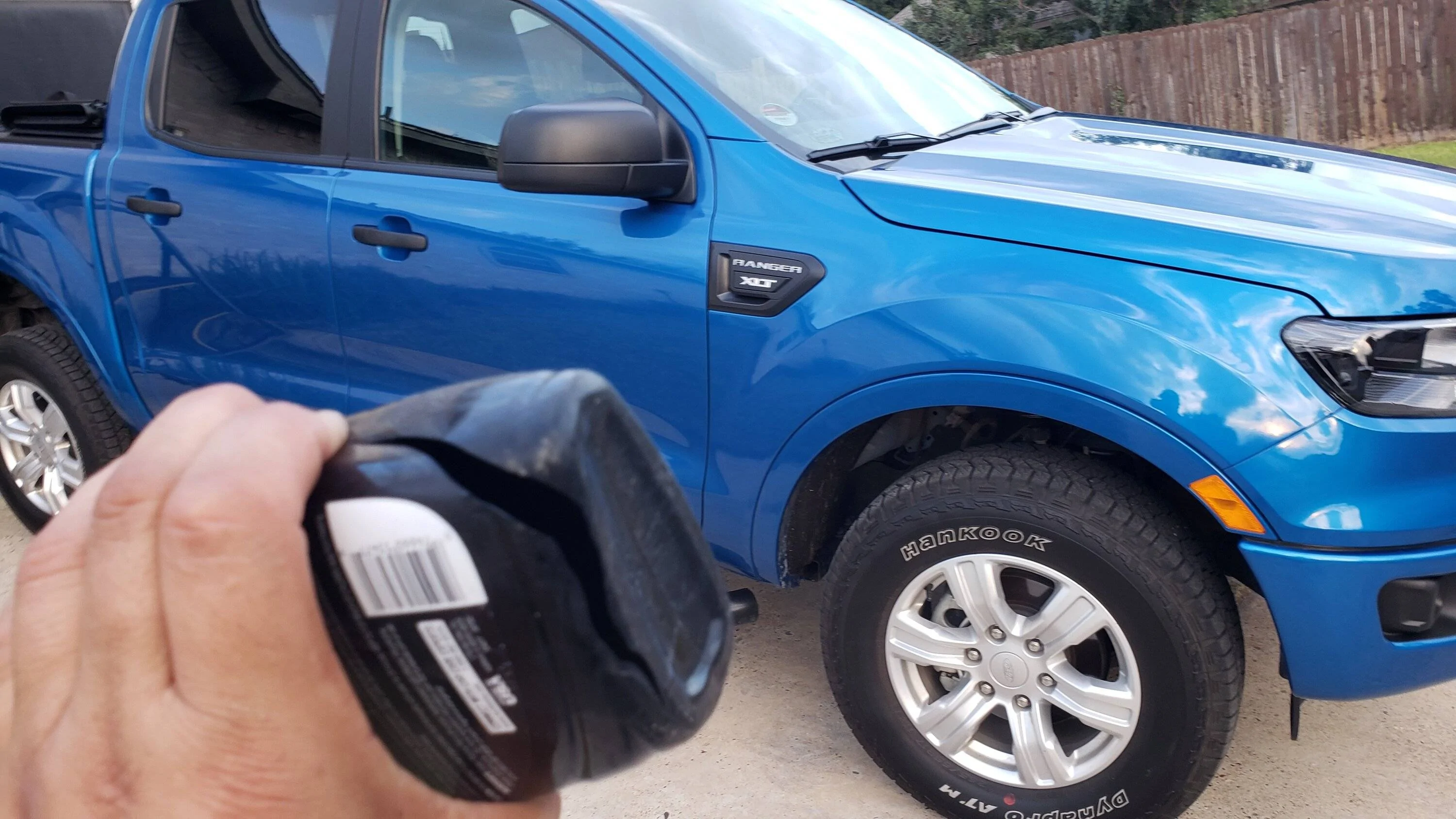

The most i will detail it for the next 6 months. Or year. Stupid turtle wax graphene bottle broke! I dropped it. F@$%, F%&* S@#( is expensive. Did not use the 2 or 3 or 4 bucket method just a car washing sponge thing, with 2 sides 1 bucket and soap, and did not wash all the mud from the bottom, will just get myddy again this weekend or full of sand from beach, just too much work. Did save about 12 ounces of the graphene.

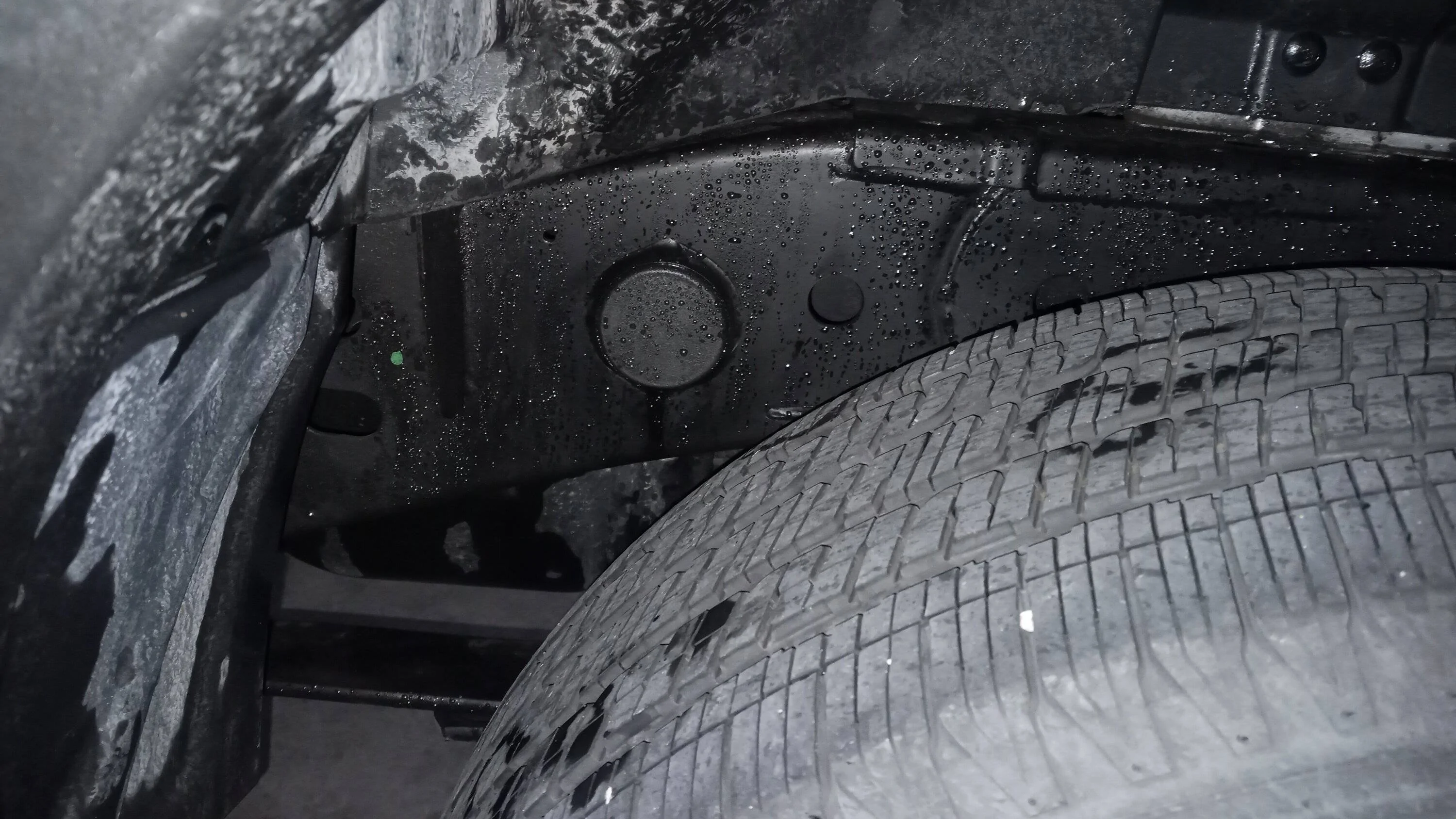

Installed cap plugs to the frame holes ahead of the axle, and washed it before the temps plummet.
Horrible pic, garage lighting could use an upgrade for sure...

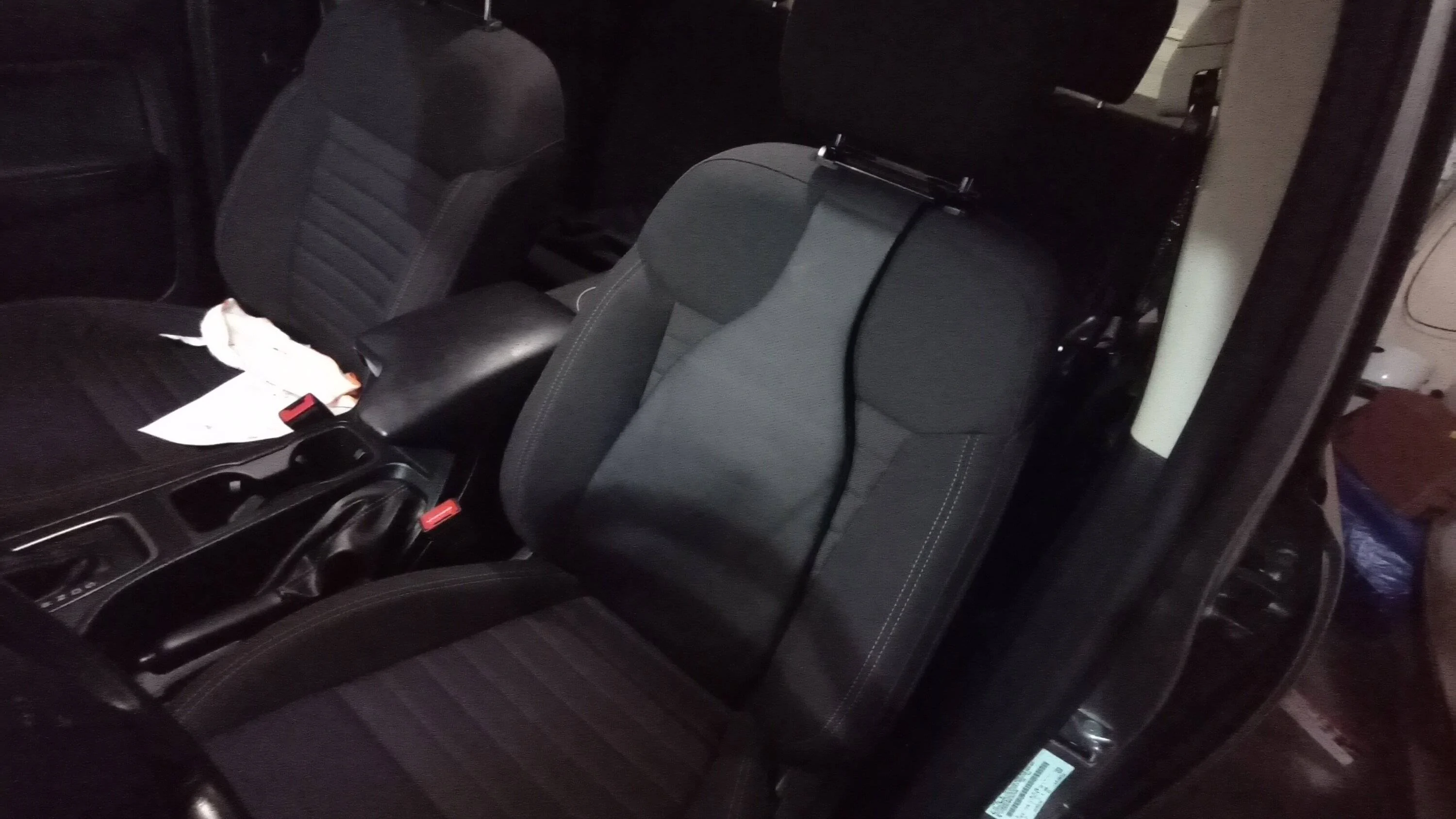

Oh and a new back cushion. Seems to work okay.

Where did you get the plugs?
That cross tube is always full of salt and sand in the winter on my Ranger.

https://www.amazon.com/gp/product/B07NLXP8BH/
On a personal note, I noticed one was somewhat loose, I had large o-rings I had laying around to keep a tighter fit; https://www.amazon.com/gp/product/B000FMWQI2/
(Completely optional)
Keep in mind, there's a hole on the passenger side tube(Look inside, you'll see it) at the bottom. These caps are mostly for appearance, so I recommend you shoot some fluid film inside before installing.
