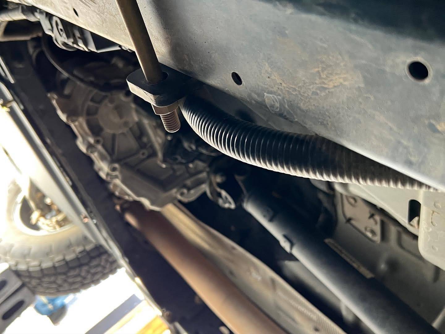

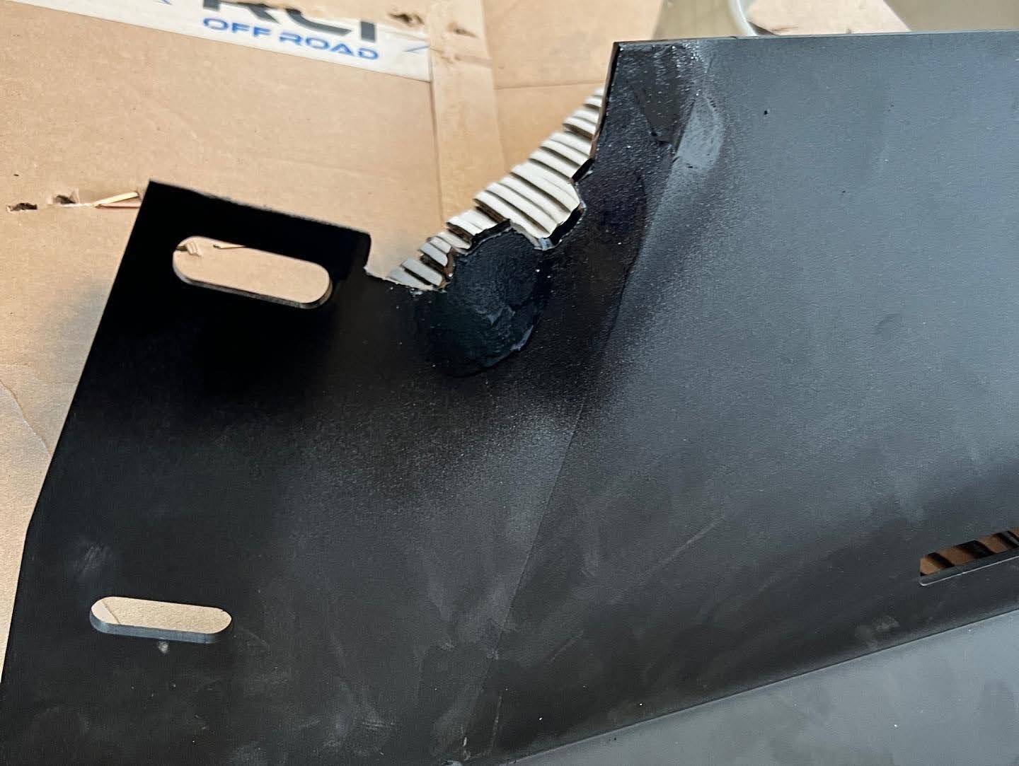

I pulled the ARB skid plates and installed the RCI skids. They are 4mm instead of the ARB 3mm, and allows the oil to be changed without pulling the skids (there is a small hole for the drain plug).
I had to make some modifications to the transfer case skid to clear my White Knuckle sliders.

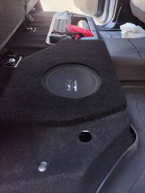

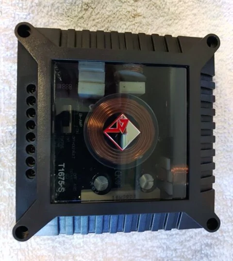

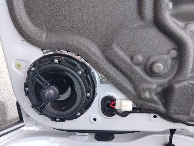

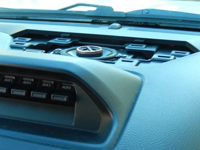

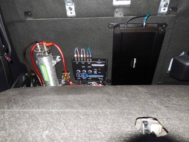

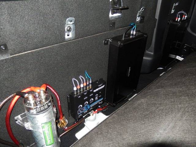

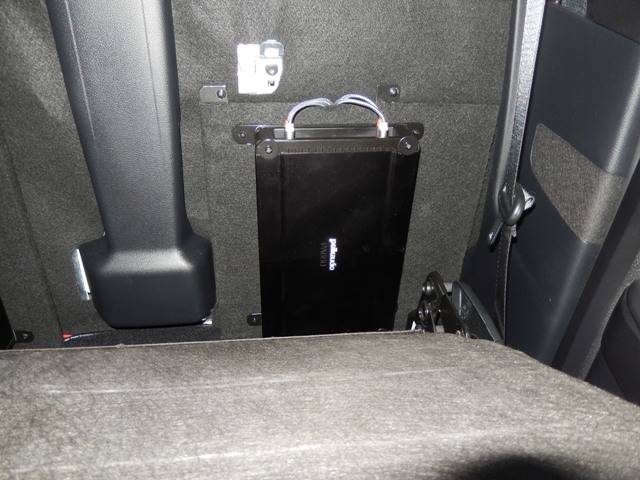

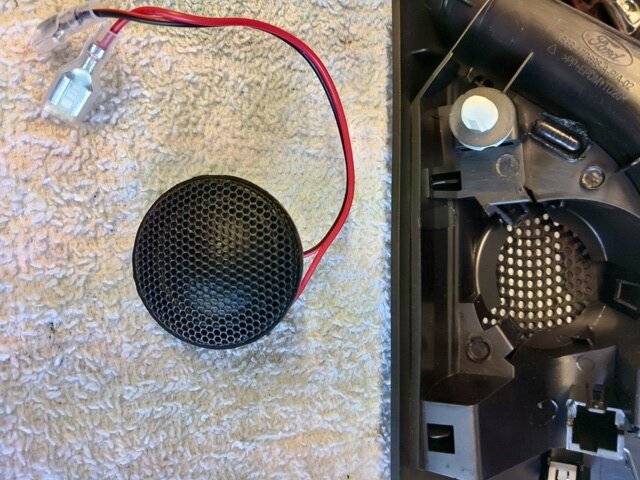

Finally finished my stereo system upgrade, added the center channel today and ordered the speaker cover for the B&O system to replace the stock non-B&O panel.
Took a while putting this all together - some existing equipment and some new.
System Equipment:
Plug N Play Harness (Kit 41) – plugnplaykits.com
Audio Control LC7i Active Line Converter
The Install Bay 1 Farad Capacitor with Digital Meter
Main Amp – Polk Audio PA660
Sub Amp – Polk Audio PA880
Front Speakers – Rockford Fosgate T1675-S
Center Speaker – Infinity Reference REF-3022CFX
Rear Speakers – Rockford Fosgate T1675
Sub-Woofer – Polk Audio AA3085-A MM840 DVC 8
Speaker Cover - Ford (KB3Z-2104374-AB)

I am far from an audiofile. Does the center channel really make that much of a difference?
Absolutely. The right way to do this would be to have a processor to create a true center that only contains the unique elements of left/right. I did a tri-mode configuration bridging the front left/right and creating the cross-over and resistor network. The key is to have this speaker raise the sound stage but not be too prominent, so the left/right speakers still provide separation. Really helps for clarity and intelligibility.
