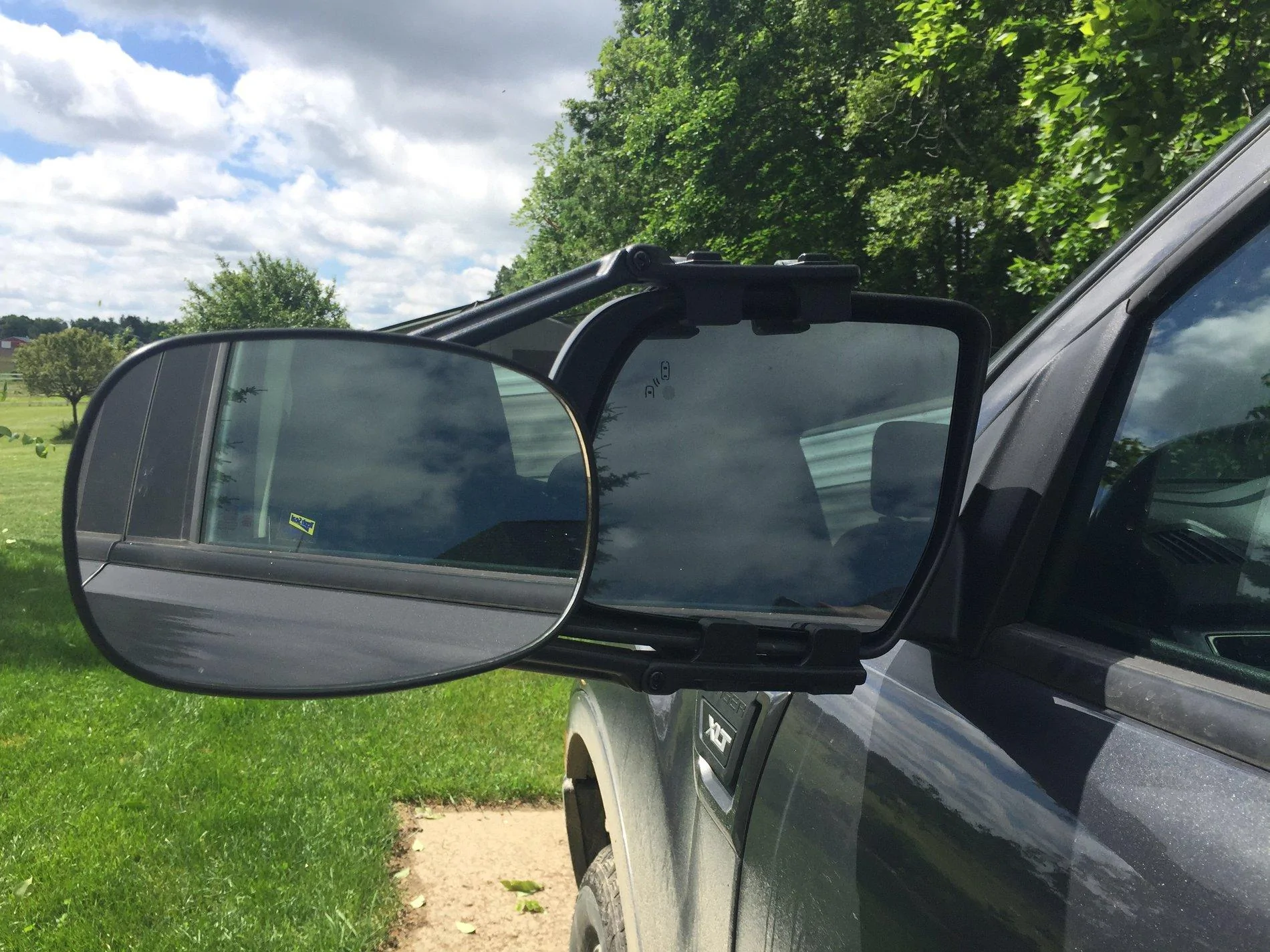

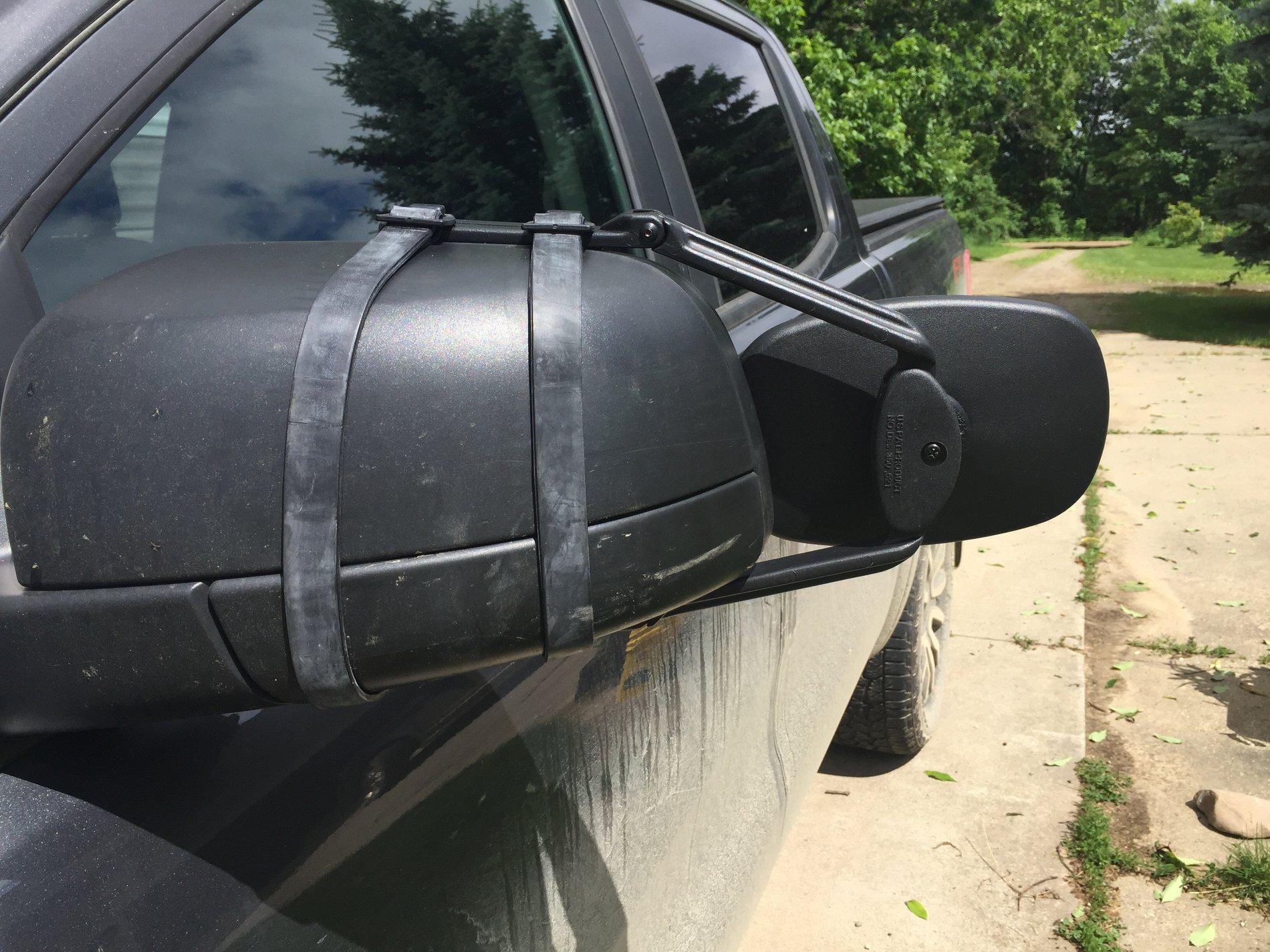

I have these ones. Not sure if they will stay on or not.

When I use these I cross the straps and it seems to work well. Lariat has a signal on the mirror so that helps too, but crossing them worked on my frontiers plain mirrors as well

As an update to my post above, I've left the drivers side on for two days now, and it's been stuck there with no issues. 75-80mph it gets a little wiggly, but I never intend to tow the trailer that fast. It hasn't moved at all from the position in the pictures above.

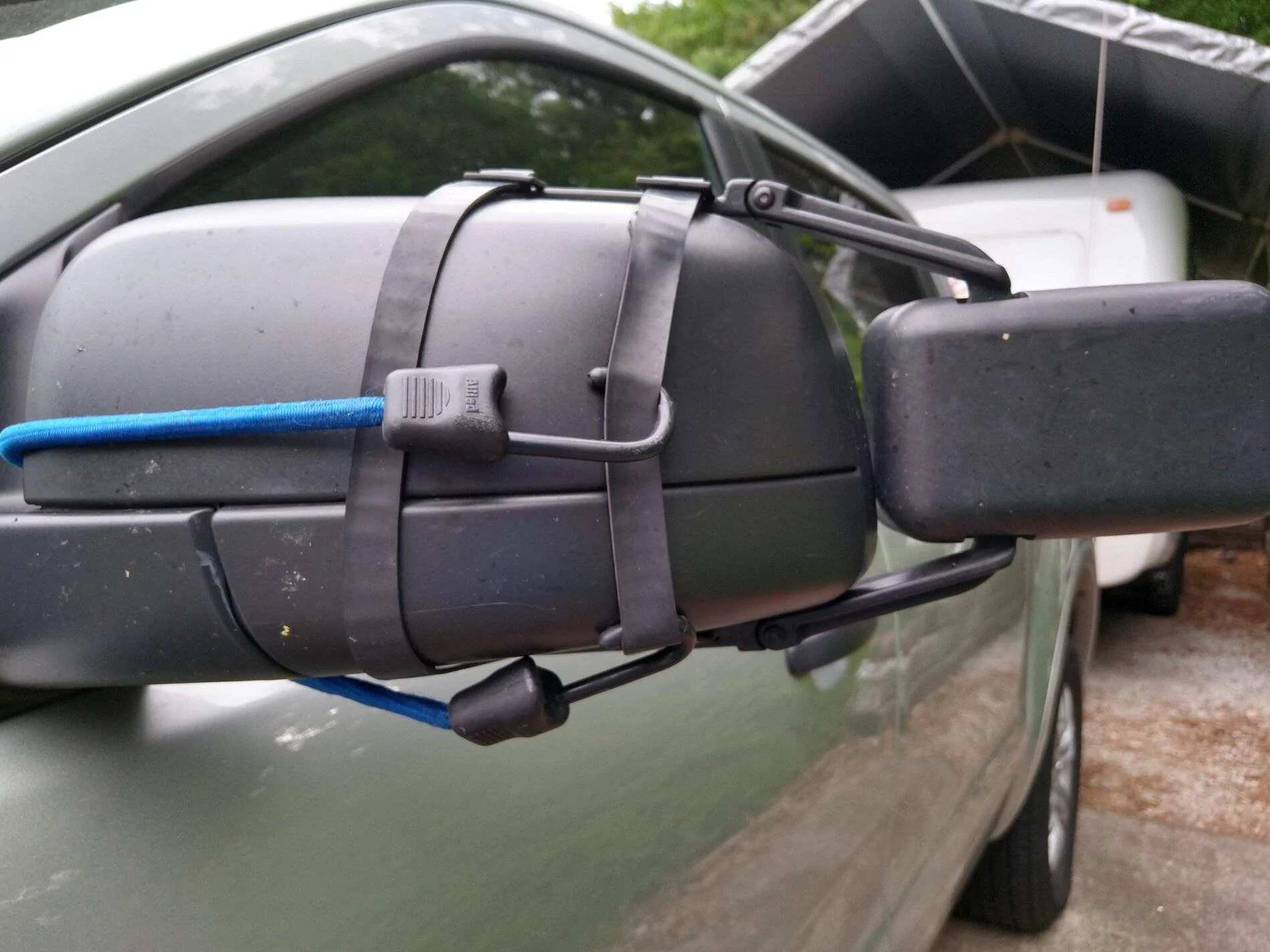

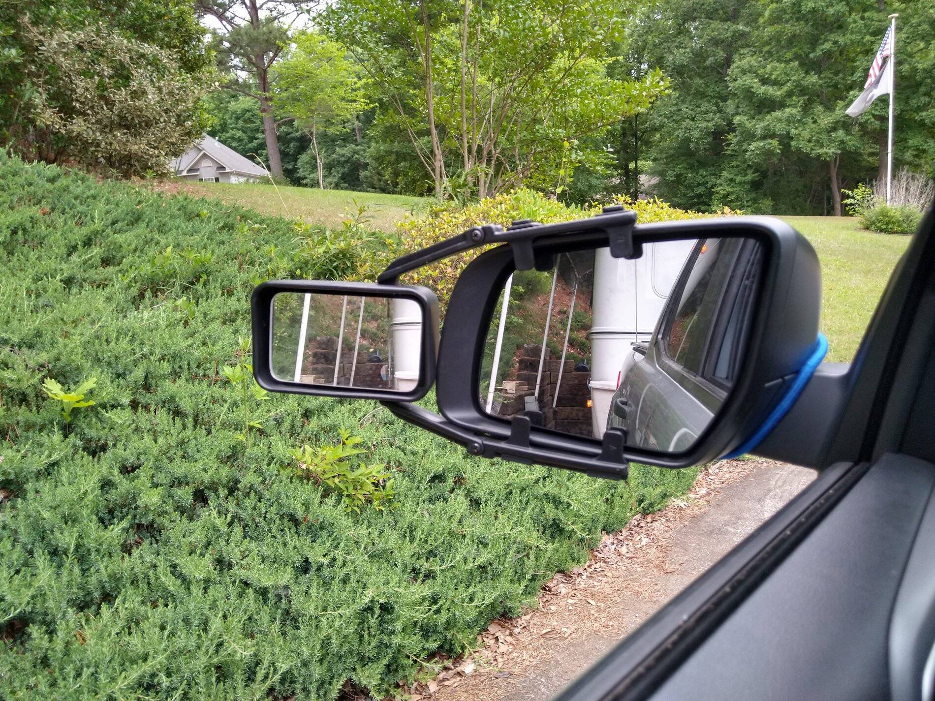

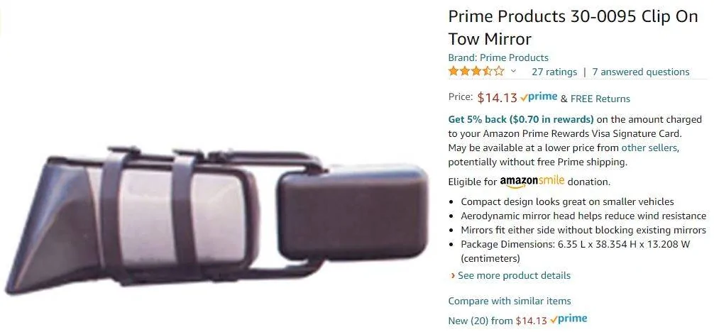

I ordered this mirror about 8 years ago and have used it on two other tow vehicles before getting the Ranger. The Ranger mirror gets narrower toward the end, so I was worried this mirror might loosen as I drove.
Simple solution was to use one of my bungee cords on the outer strap to help it stay in place. Works fine this way and the mirror helps me see more of what's directly behind our camper.
