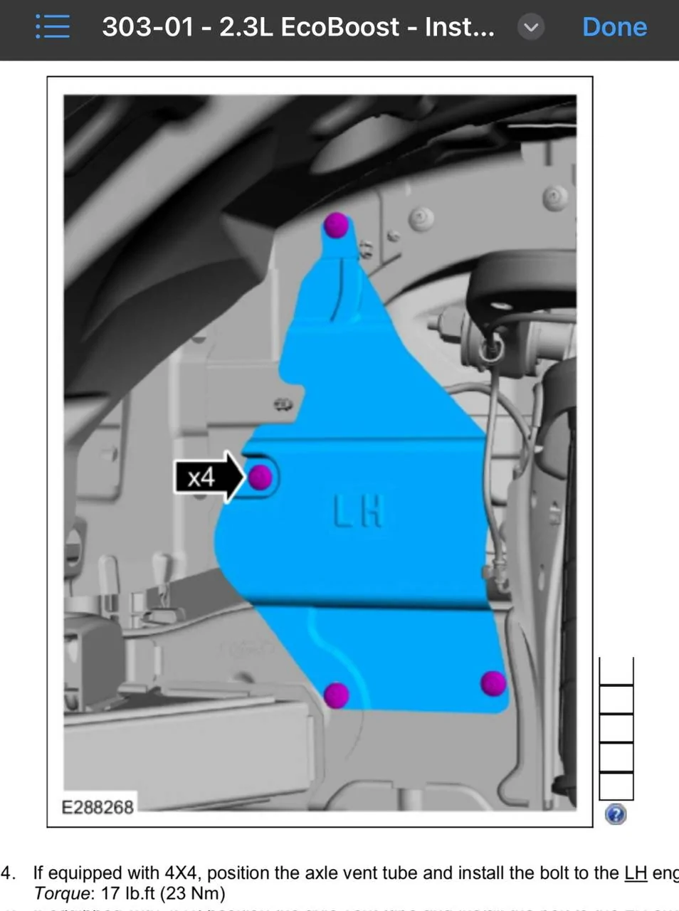

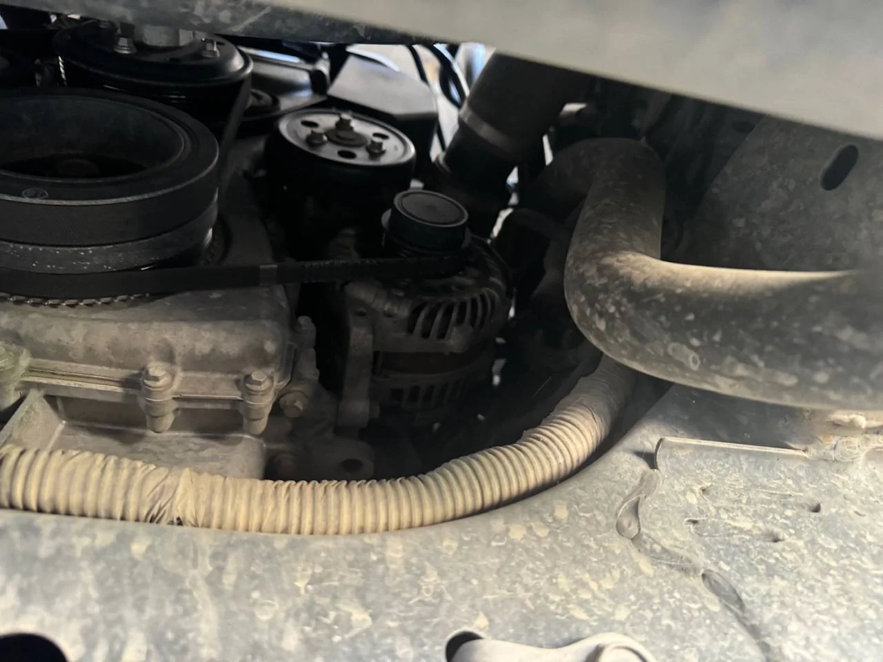

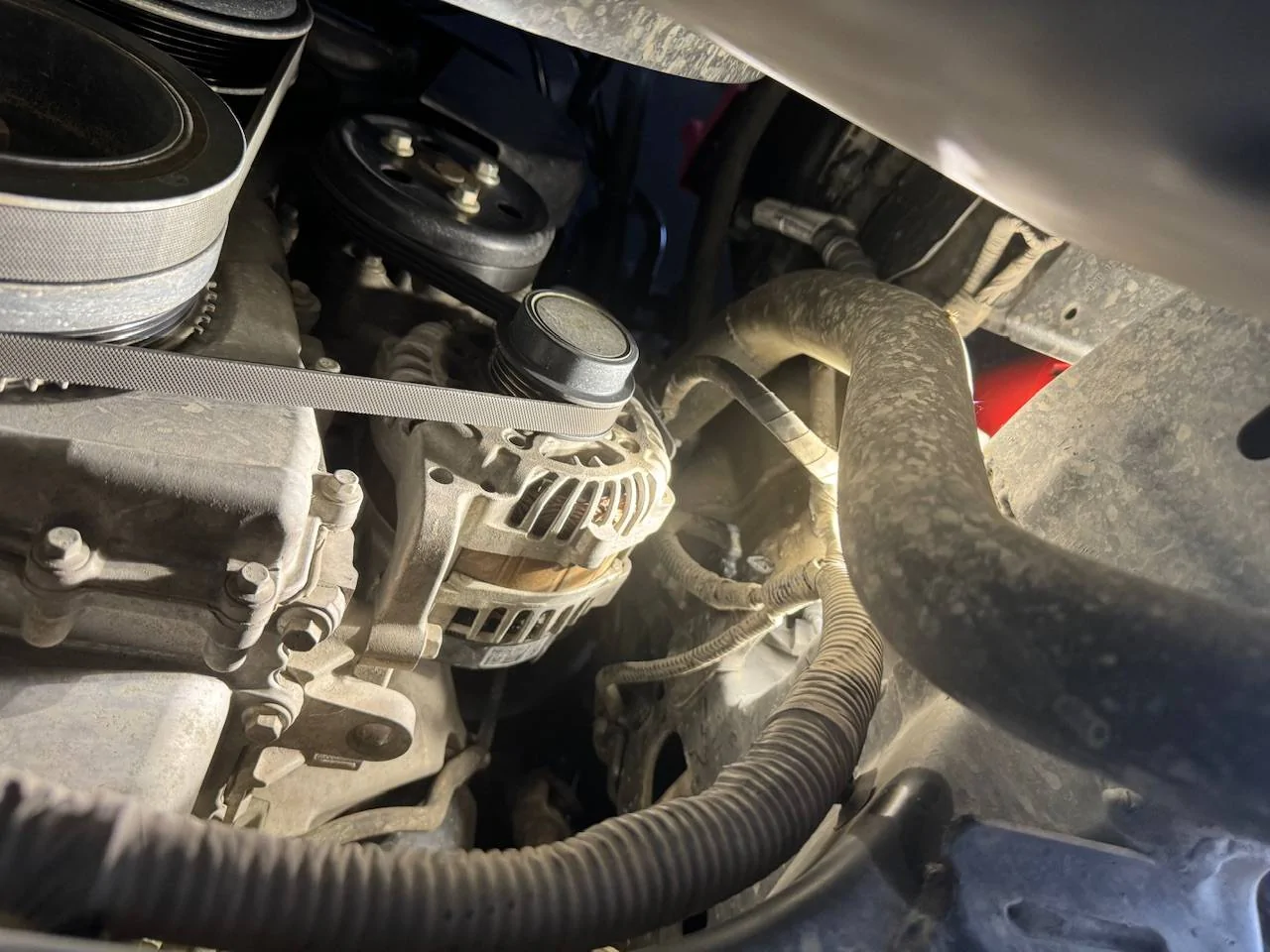

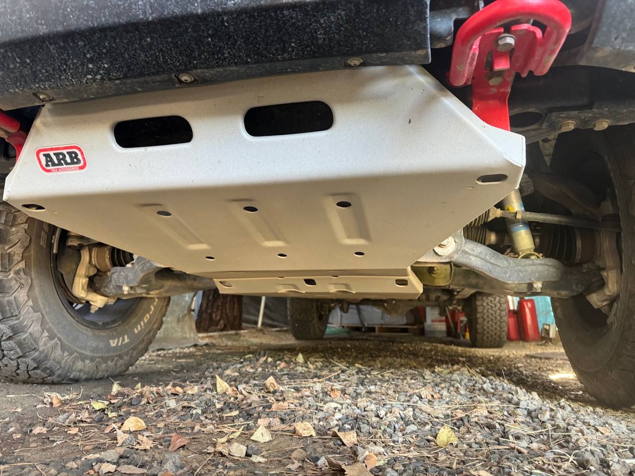

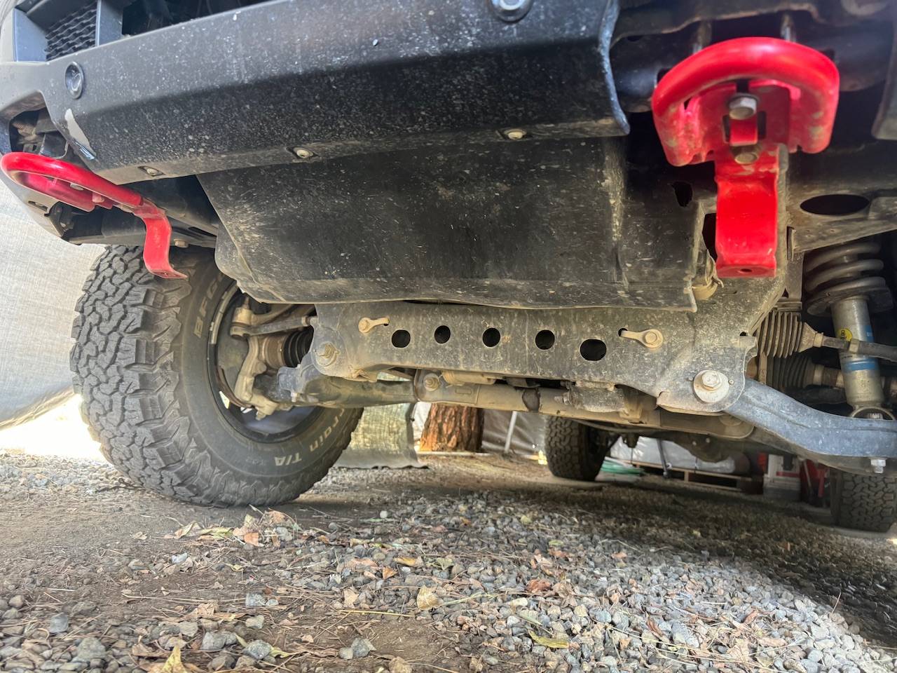

Started the project had to remove all skids
Had to anyway going to install new PPE pan and new trans fluid soon just waiting on filter seal.

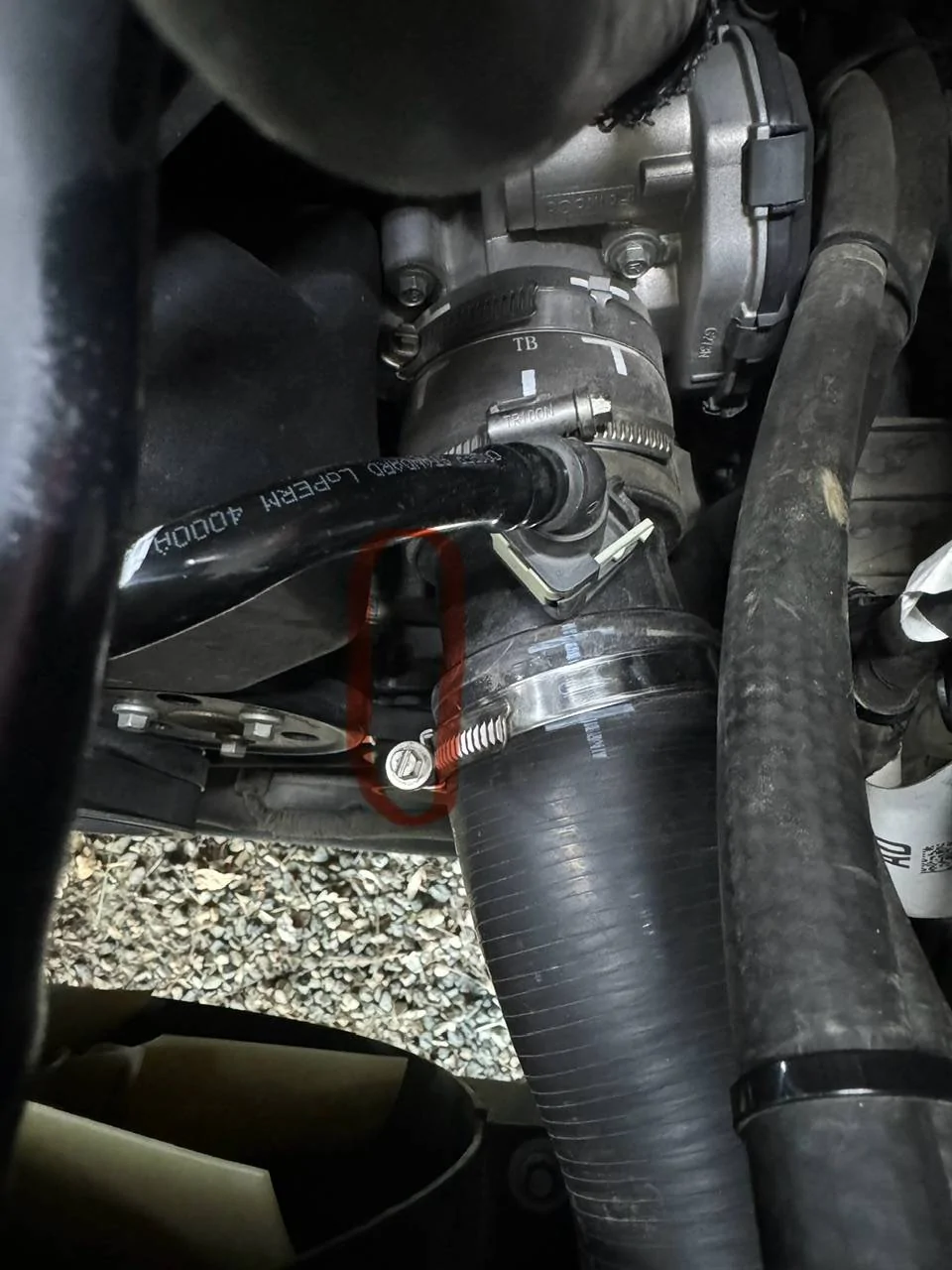

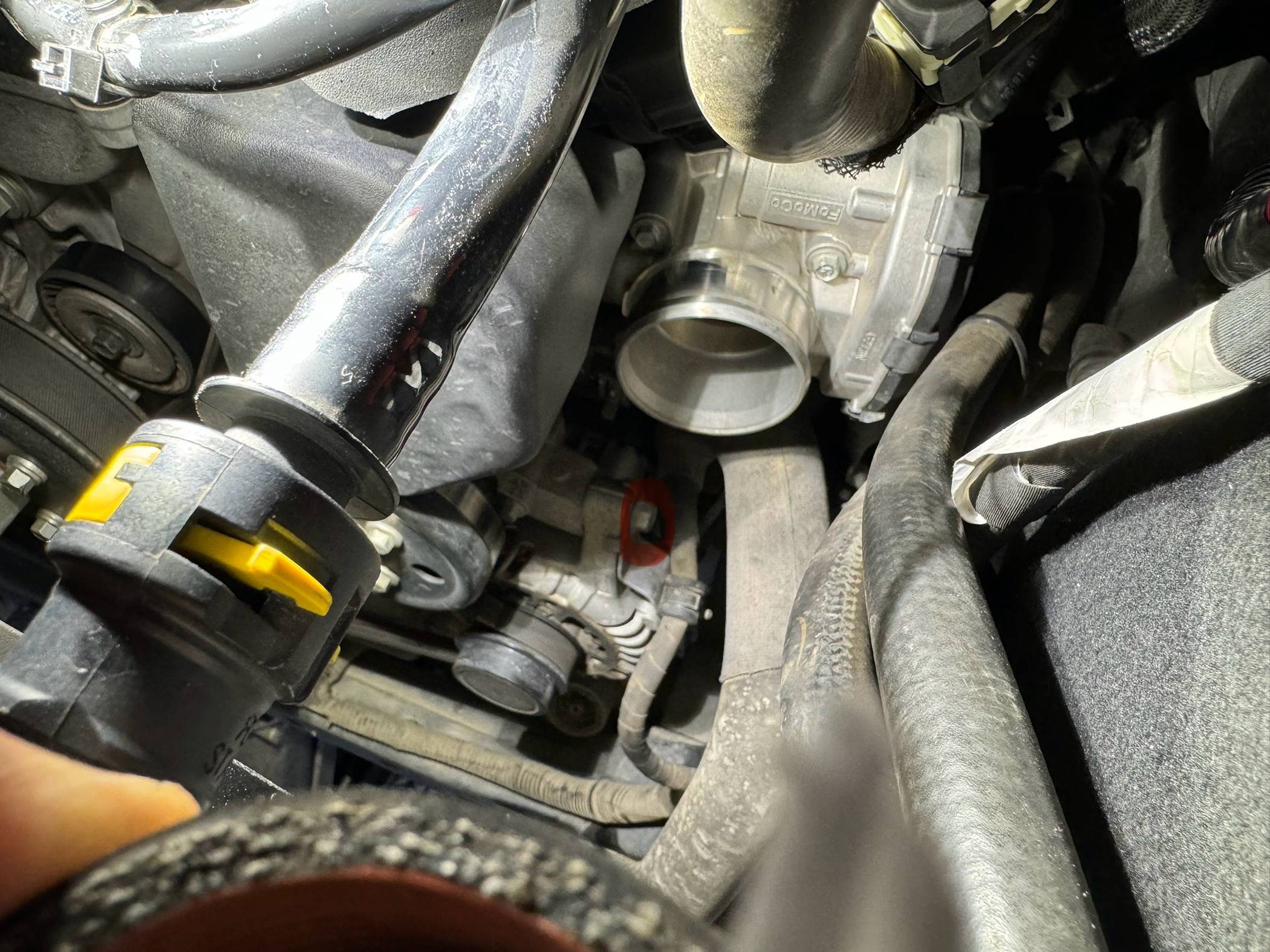

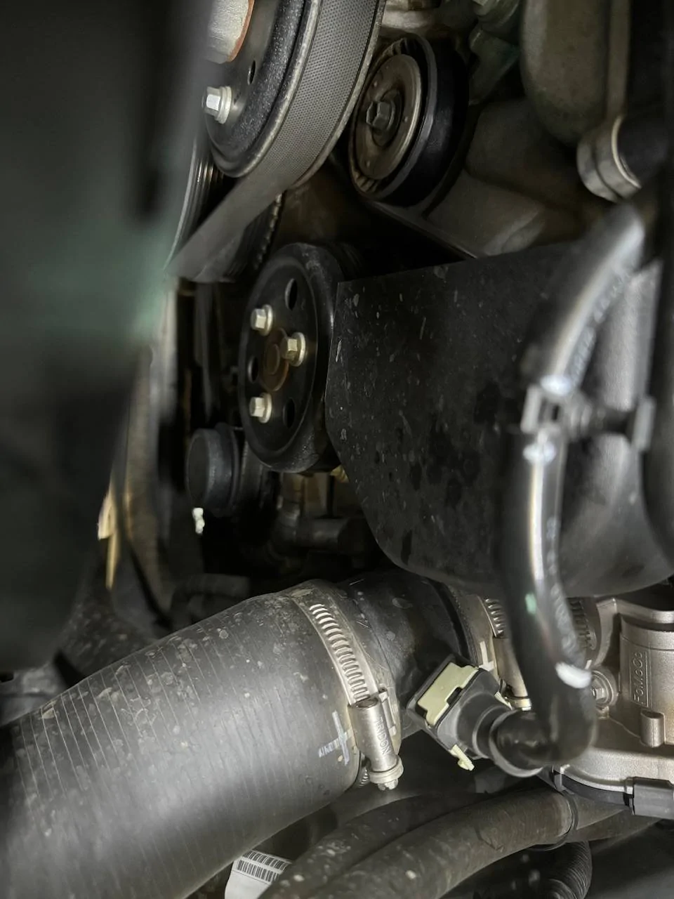

But the problem with the shield from what I can figure out is it attaches behind the alternator and it’s extremely tight.
It’s under this sensor and pipe. For easier installation might have to remove sensor
You can barely see the alternator from the top and it doesn’t help I have mishimoto catch can and hoses are also in the area

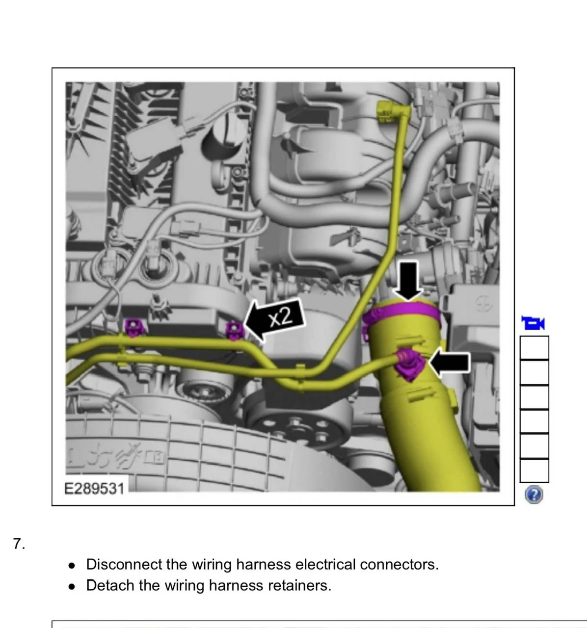

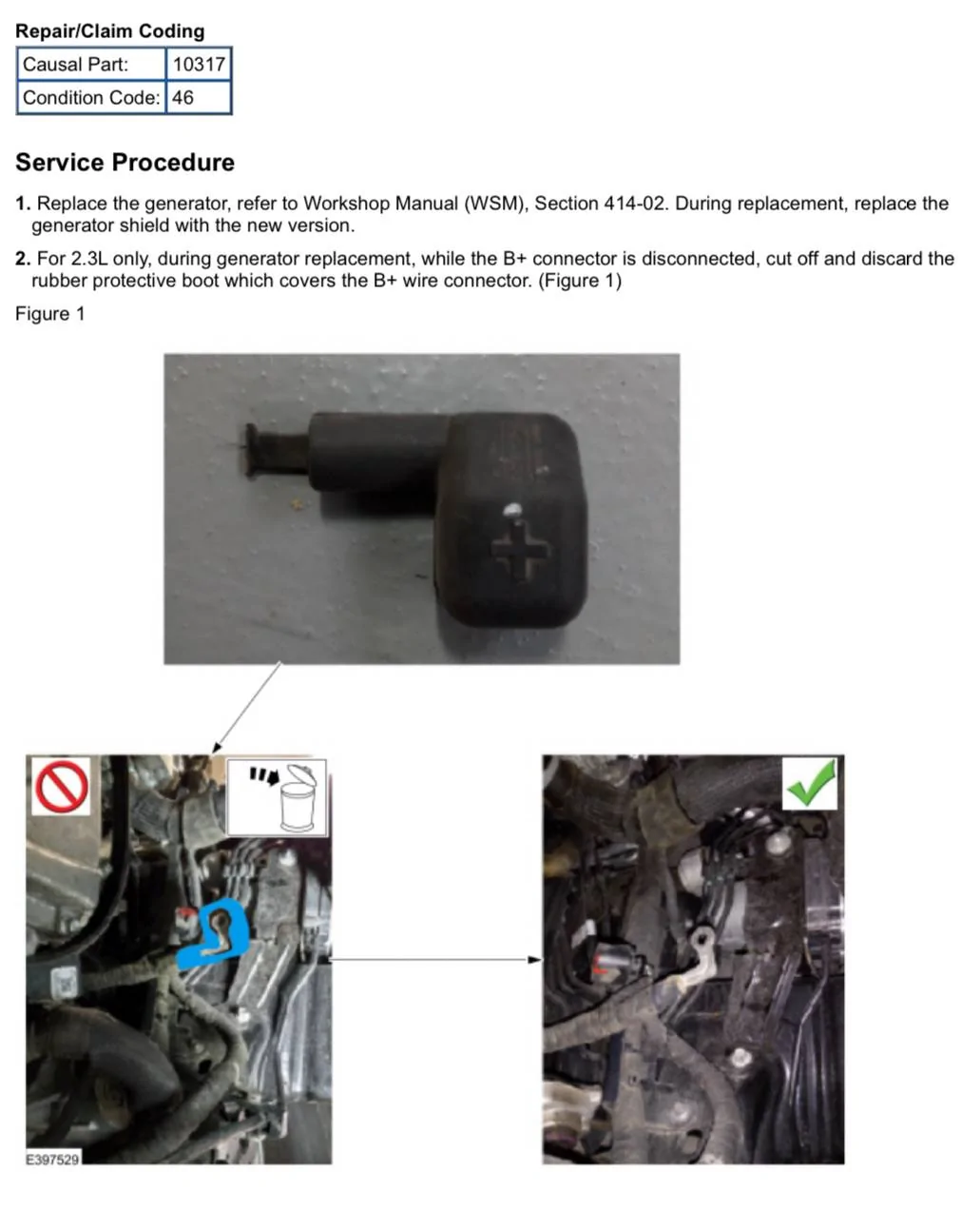

From what I can find online you have to disconnect and remove the rubber boot on the positive terminal.
This procedure is for the Bronco 2.3L.

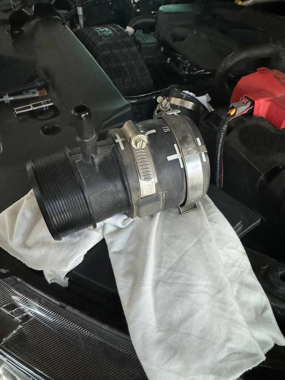

Don’t know what I was thinking. It attaches to the CAC outlet pipe I think it’s part of the EVAP system. But it needs to be removed for I can see behind alternator.

Also this is the part I was referring to it’s called EVAP canister tube.

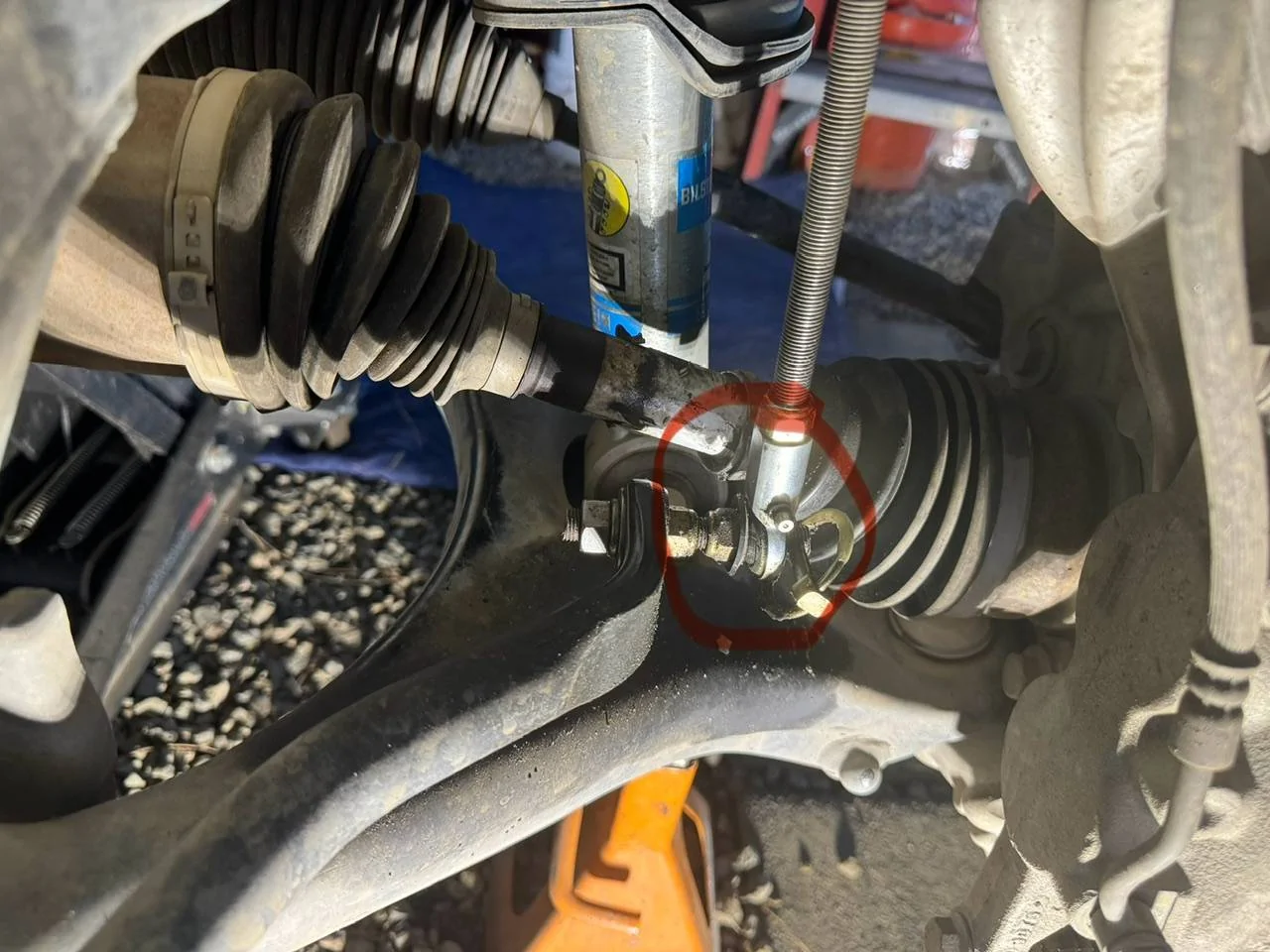

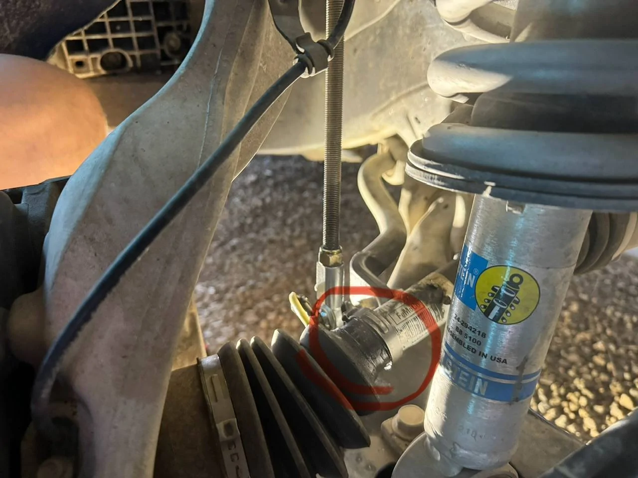

A little delay now though found some grease on front pass. axel
I have sway bar disconnect and I think the bottom pin hit the hose clamp. Should be easy fix ??

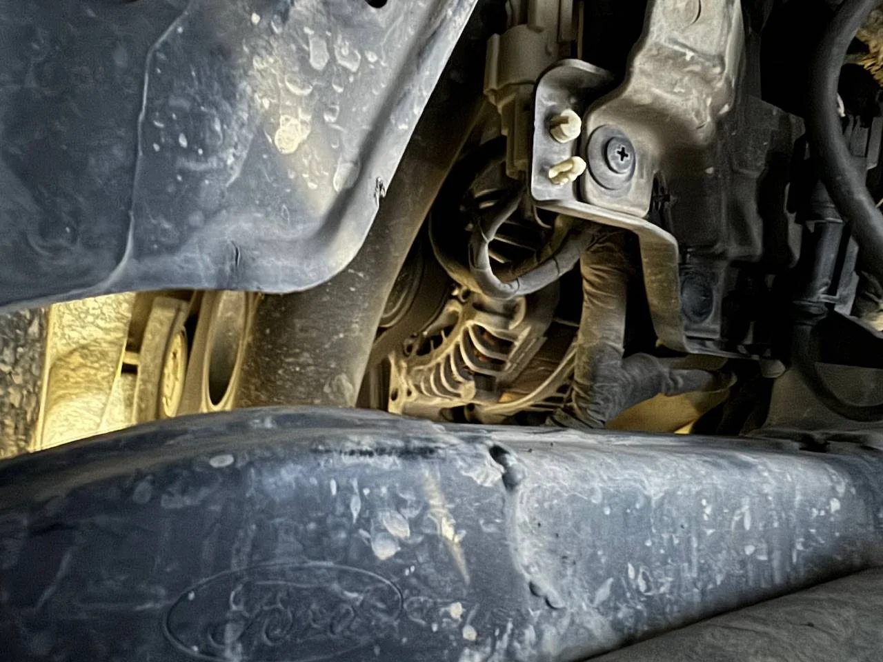

Removed the flap no help except to let light in.
From the bottom is the way to go
just not sure if this part will actually work on Rangers without some modifications.The part is originally for Broncos. Or remove alternator and put it together at same time.

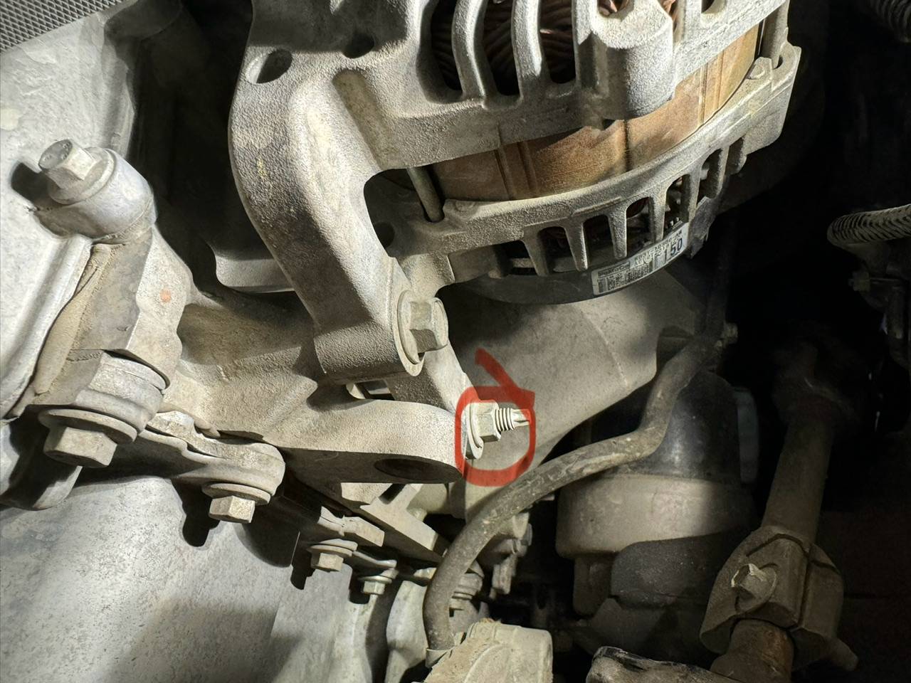

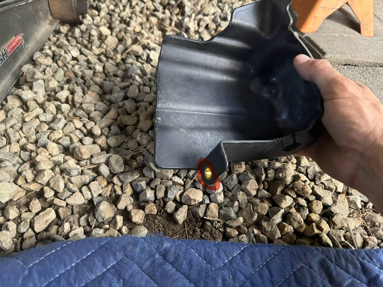

I think this brass spacer on shield
Goes on this stud on bottom of alternator
And other attachment point in here on top of alternator
Here’s a video to see how tight it is might have to trim some off the back to make it easier to install or wait until it goes out and install during replacement.
