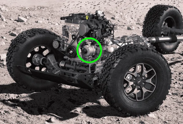

I'm really crossing my fingers for the following:
  • That the 2.3 Bronco does indeed have a sealed alternator.
  • That the 2.3 Bronco's alternator works on our motor.
  • That the 2.3 Bronco's alternator is not impossible to buy.
  • That the 2.3 Bronco's alternator isn't $1 Billion.

Did we ever find out if the Bronco's alternator was better enclosed? If so can we swap it out for the Broncos?

It's not sealed, lots of the Bronco guys having the same issue after mudding / water crossings.
