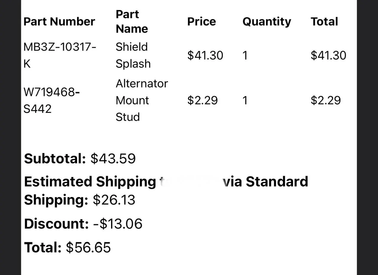

So yeah mine is still sitting in my tool box, I have had so much stuff going on I have not had time to mess with it

My local Ford dealer is installing mine next week on my 2023 XLT just in time for the rainy season here in Texas. The parts and service department got together comparing the Bronco to the Ranger schematics and came to the conclusion there was no difference between the Bronco and Ranger 2.3 in the aspect of the alternator. They said it'll take them about 15 minutes to install (as that's how long it takes them to install on the Bronco).
Awesome, let us know how it goes.
Did you take the new bolts and nuts to them as well?
Does anyone know what the new bolt and nut part numbers are?
