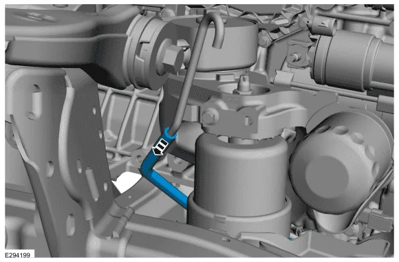

Front Diff: Breather
Cannot find one for the rear, except for the housing connection, does not show other end (vent port)

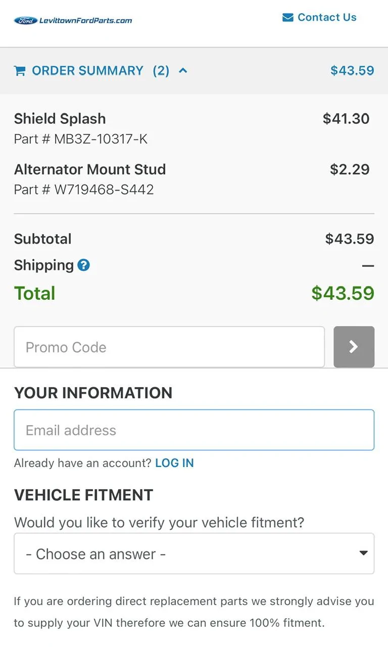

so on this alternator shield thing... maybe we should just order them and see how it goes lol.
