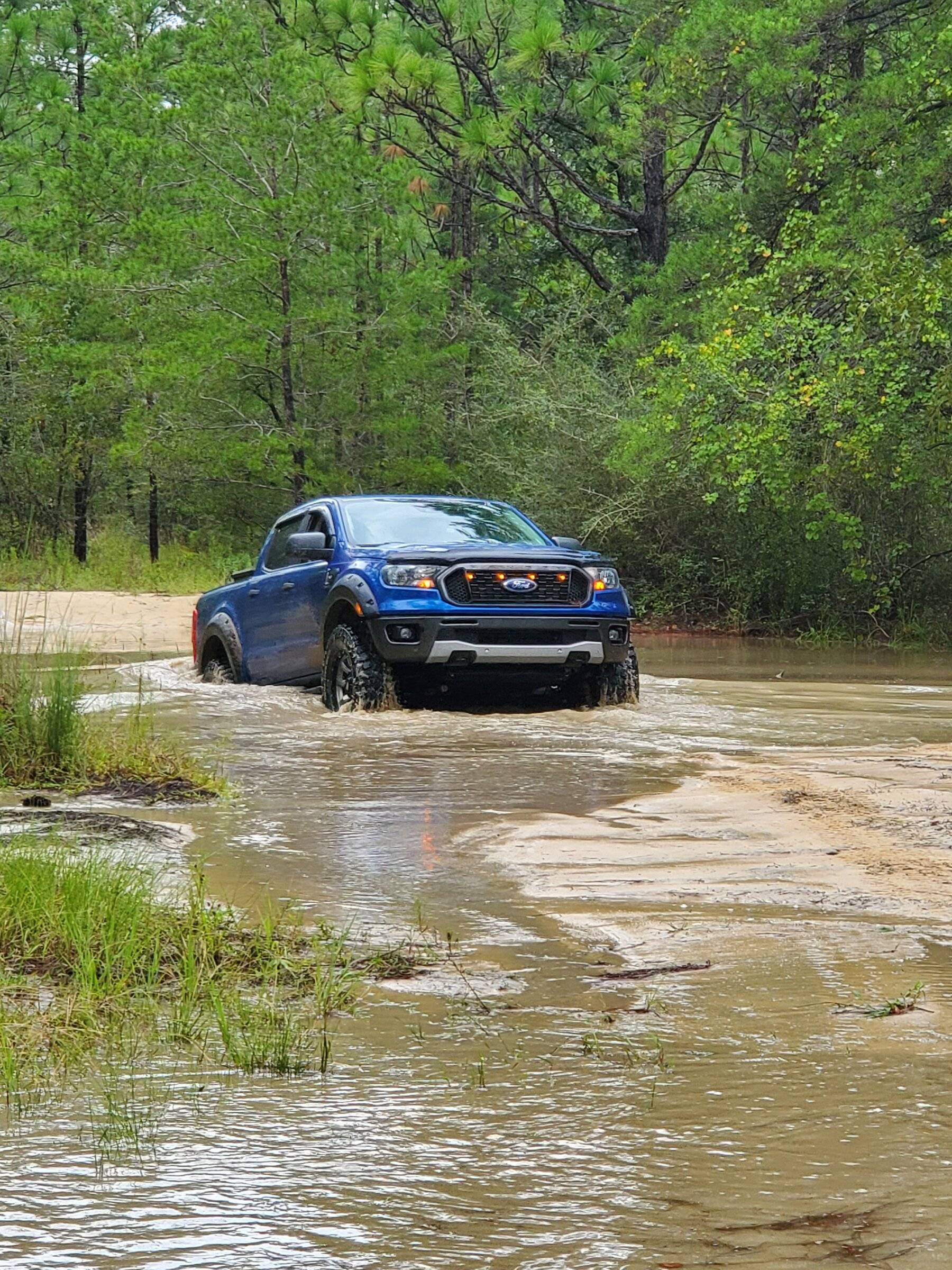

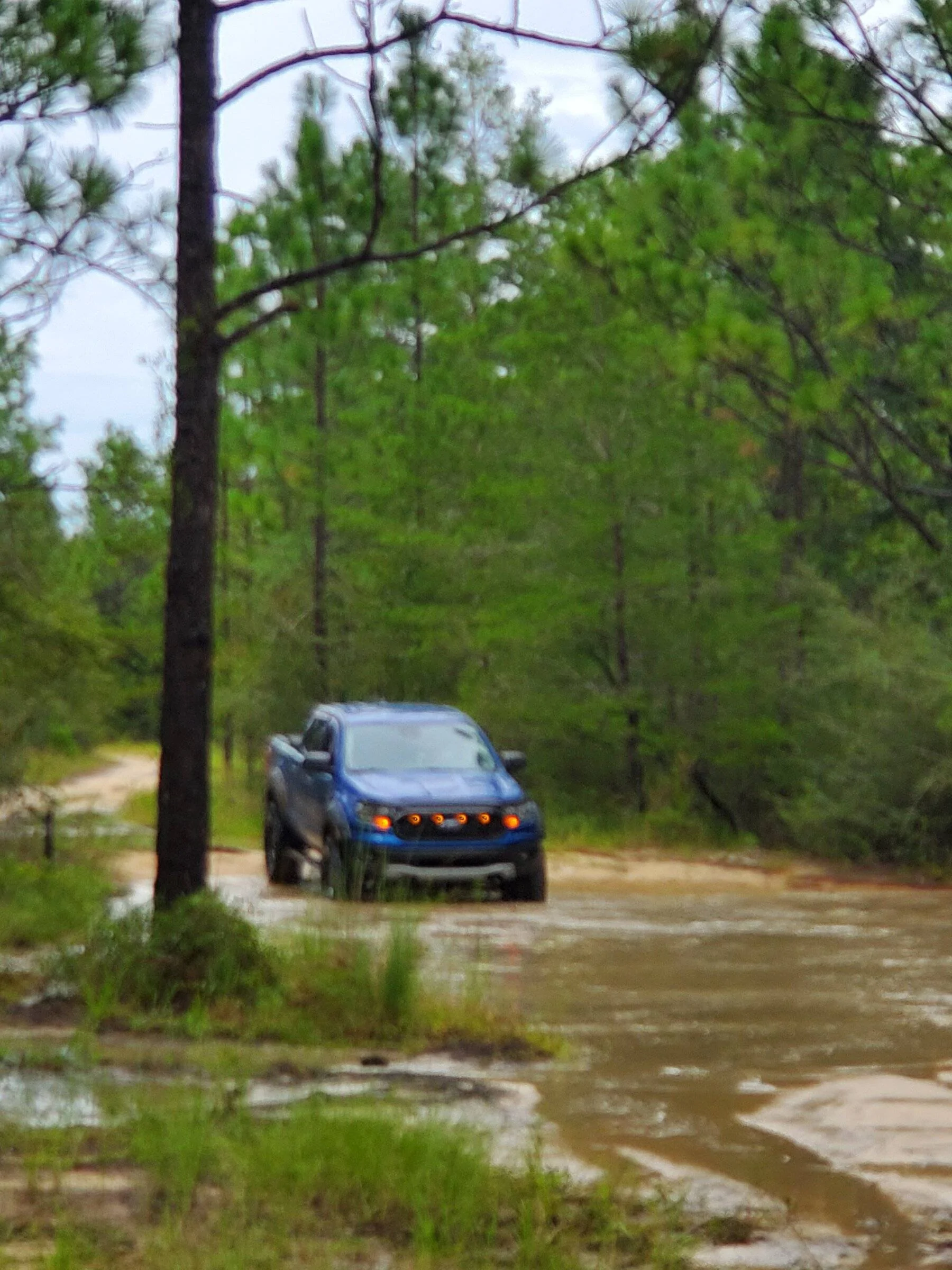

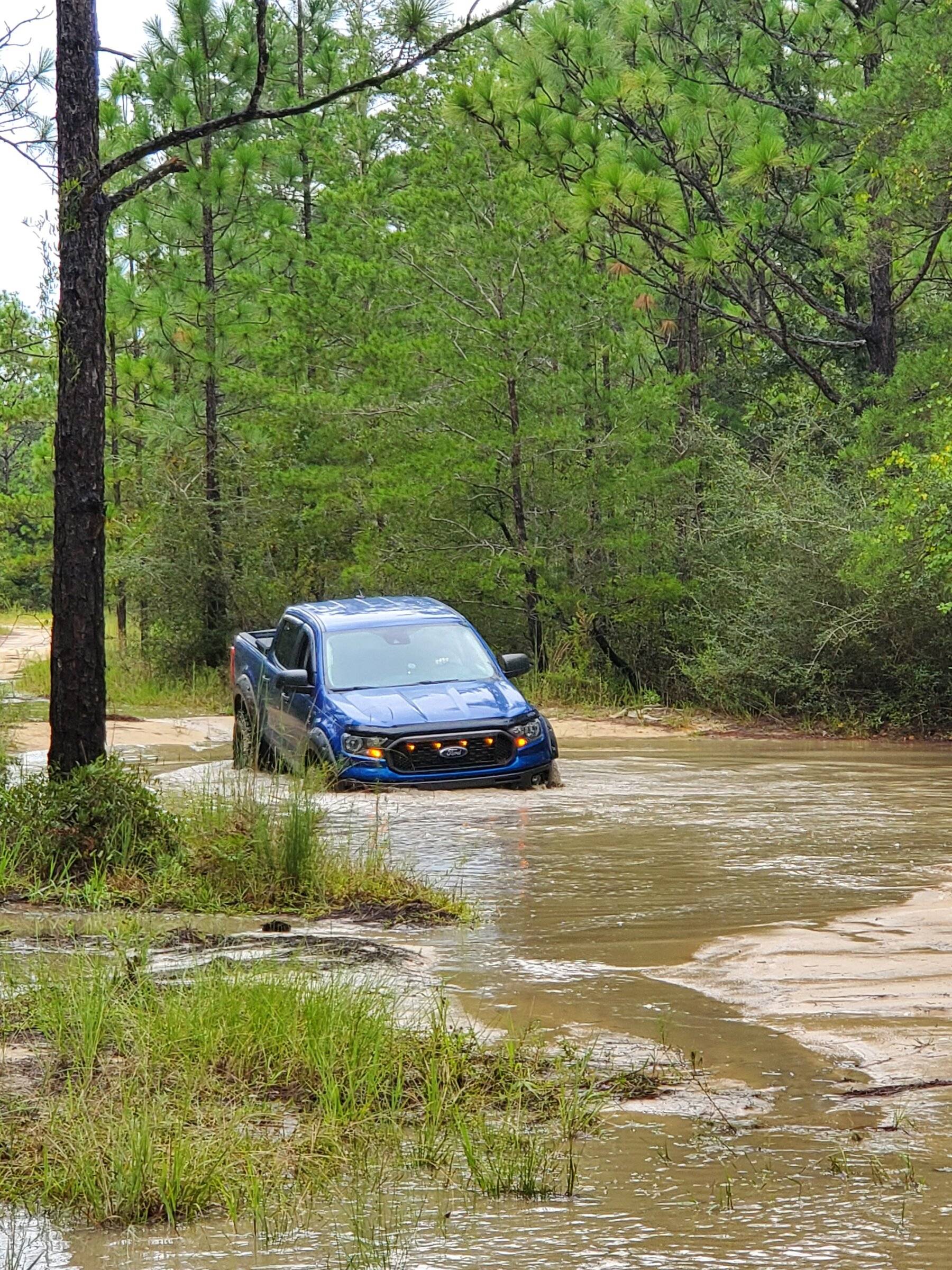

I offroad in Mud, water, and dirt frequently from week one when I first bought the Ranger back on May of '19. Not one single problem with the alternator, currently sitting at 42k miles on the ticker.
The key is each and every time you off road is a proper flush and hose down and get all of the mud and dirt out. If I end up back at home at 3am, welp just too bad. I take the time and not allow the mud and debris time to dry. Works for me. Trust me, I'm one of a hand full of people on the forums who put the Ranger through the gauntlet consistently.
I drive it like I stole it and I don't baby it. When it breaks I fix it, simple as that. I don't run to the stealership and whine and complain that I broke it while I'm off road. That's the price of fun. Gotta pay to play. Follow me on the ole ticky tokie @fordfreakingranger for all my shenanigans.

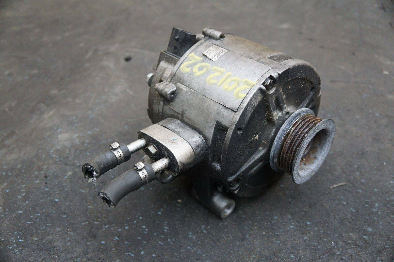

The Cadillac XLR (2004-2009) alternator is sealed and water cooled. Made by Hitachi.
It's also rated at the same 150 amps as our alternator.
I'm wondering what kind of bracketry could be used to make it fit?
Just look at that beautiful sealed face and the cooling hose connectors :like:
About $100 used/rebuilt and $300 new.
Edit: And HERE is a link to the connector.
Doggone I am seriously thinking about this now.
The parts don't seem too hard to come by.

One problem with that. How is the alternator controlled? Or where is the regulator located?
If its an internal regulator type it wont work.

I'm sure there's more than one problem getting it to work.
I'm sure the pulley is different, mounting is obviously different, and the connector is different.
But it's a sealed alternator and who knows, the entire guts from the Ranger alternator may fit in there.
It's currently just a thought experiment with a reasonably priced and readily available sealed unit.

I would guess the entire ranger electrical/computer system is dependent on variable alternator, and swapping in a standard on/off type would probably cause the computer to throw a fit.

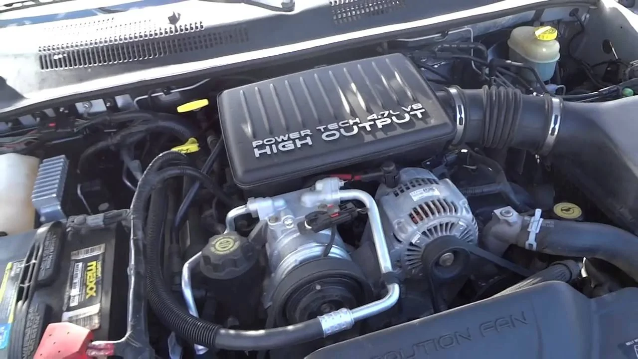

Have any of you looked at the height of the alternator on other comparable 4WDs ? I noticed the other day on a friend's 99 4runner it's at almost the exact same location as my ranger. Also, my 95' Isuzu Trooper it's in a significantly lower position, and I've gone through a ton of super deep water crossings with that.
Just got me wondering where other vehicle's alternators are positioned...
My Jeep alternator is where an off road oriented 4x4 alternator should be.
