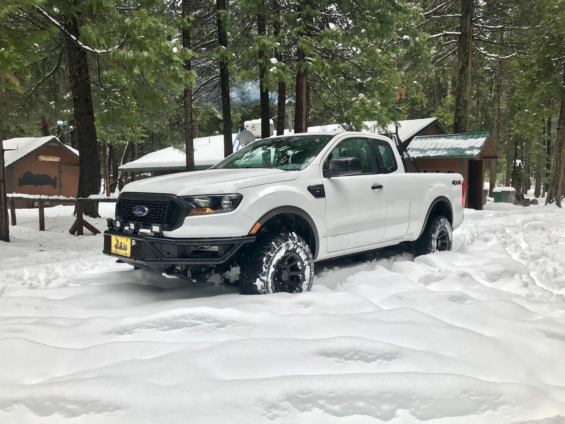

I haven’t done much mudding but a lot of deep snow 4 wheeling and no problems. Correct me if I’m wrong but if you just carried a small car charger and a generator that could limp you along in case of emergency of no alternator.

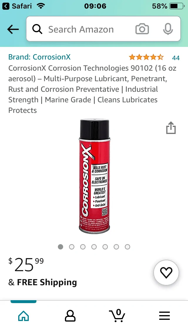

Wondering if dielectric spray cleaner after water rinse would help ?
We use to spray this stuff called Corrosion X on all of our electronic parts on RC airplanes that we flew off water in case they did get wet. It worked really well to “waterproof” them. Wonder if that might help? I know it’s not necessarily meant for that but we sprayed and let it dry right on sensitive electrical boards and it worked very well

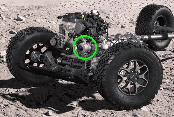

I just posted this in a different thread about the same issue...
I'm really crossing my fingers for the following:
  • That the 2.3 Bronco does indeed have a sealed alternator.
  • That the 2.3 Bronco's alternator works on our motor.
  • That the 2.3 Bronco's alternator is not impossible to buy.
  • That the 2.3 Bronco's alternator isn't $1 Billion.
