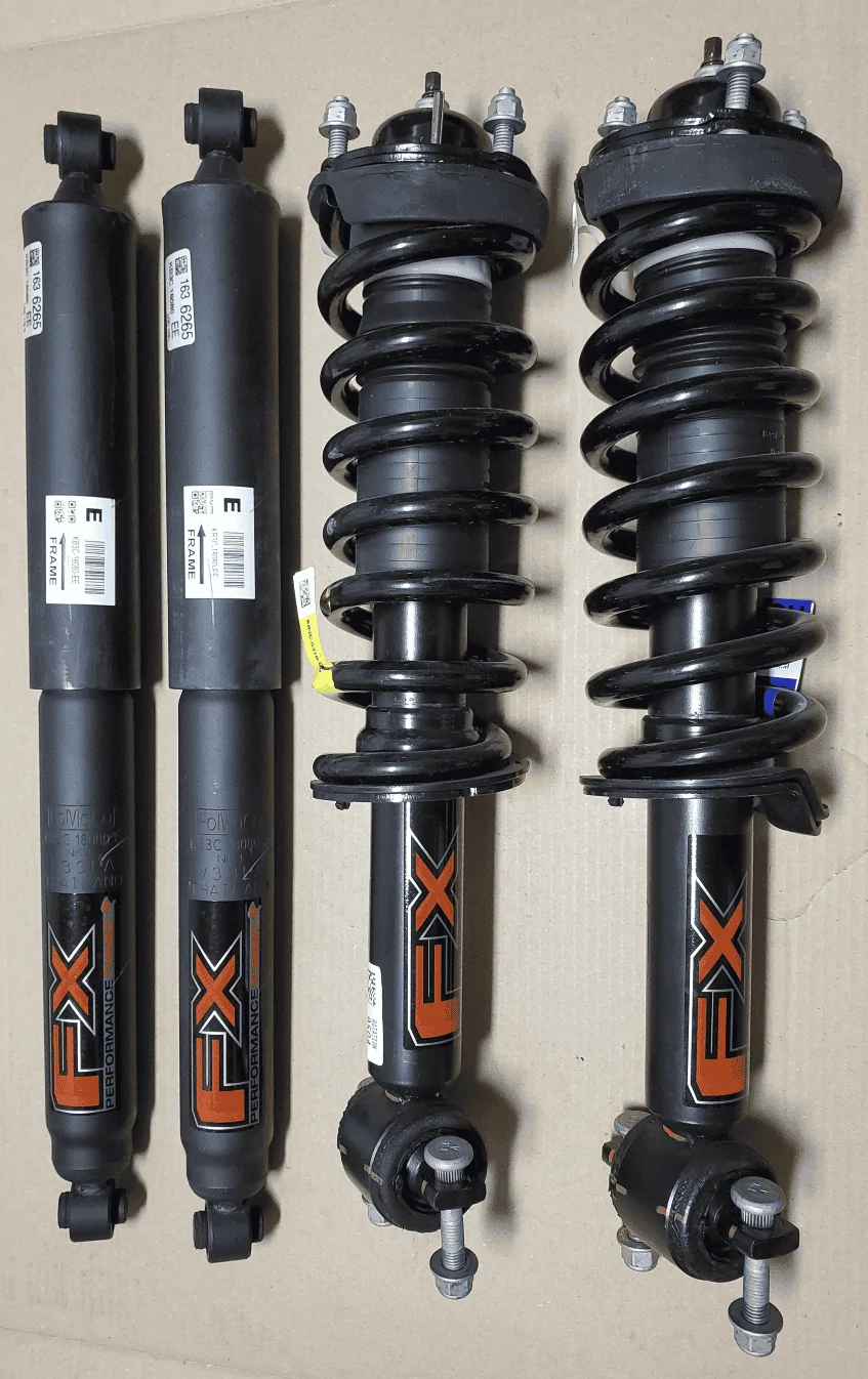

The best thing I ever did was change out my Fx4 shocks on my 2019. It was a night and day difference going to the Eibach. They were so bad I couldn't even give them away for free on here. lol
I went Fox and it was the same, I also couldn't give them away and threw them in the garbage.

These are off my 2020 FX2 extended cab with only 17,000 miles. Truck only sees summer time duty. Half those miles have been pulling a 1,000 pound pop up camper. Replaced them with Bilstein 4600 series. After seeing what crap the rears are, I now want to do the fronts…
You could hear fluid in the driver side also
Crazy the price they charged us for that junk. I hated my ride quality so I swapped out for Bilstein 5100s, when I took the Fx4 shocks off the front they had oil leaking out of the tops
Had less than 9k on them!
