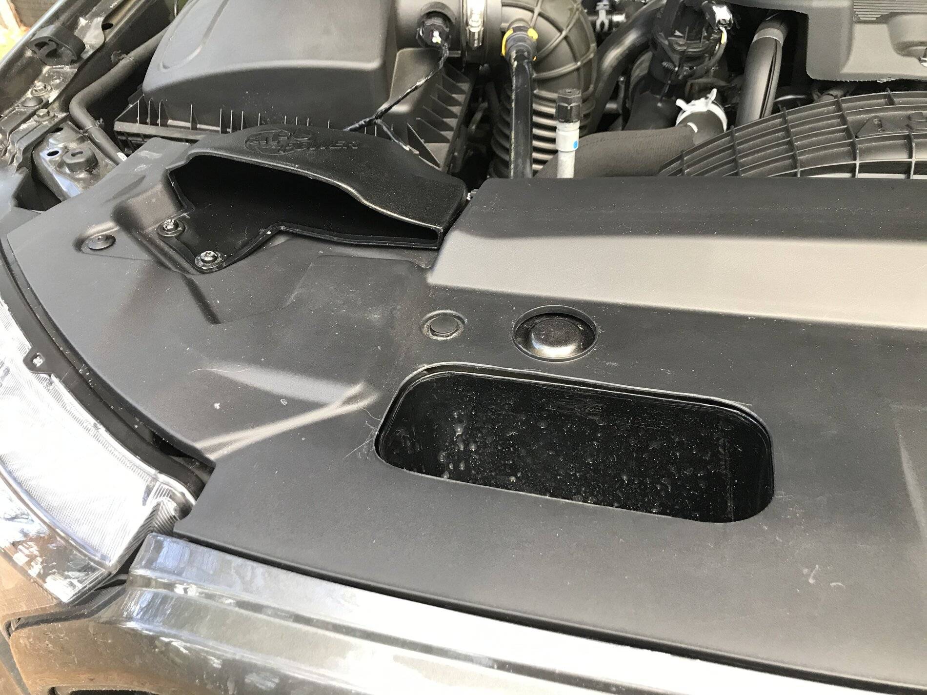

I’ve had one on since Feb along with the Afe scoop. I have seen about 1.5 mpg gain and response at over 40 mph is definitely better. I also opened up my apron hole to the exit side of Vellossa. Quite a bit of restriction there.
Over time you can see air flow pattern from the dirt when you open the hood. It is a crude ram air setup really.

Thanks for the insight Rick! How did you open the apron hole? I was considering it… just saw off the three lines?

Brandon. I used a sawzall and cut the cross members out. Then a circular drum sanding disk on my drill press. That plastic is nasty. It smears and loads up the sanding drum.
That’s the end result in the picture. I used a trace scribe line to know where to open it to.

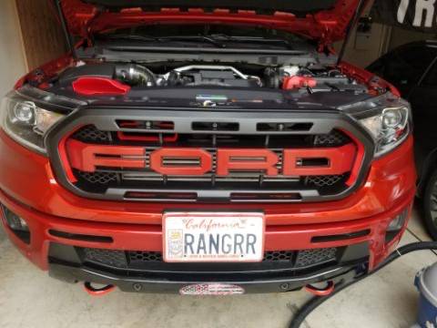

Eh, I forgot I put my raptor lights in a specific spot, not sure how the raptor lights would fit any way else. Maybe I bought the wrong lights at the time. Either way, half of the opening is open and I removed the flare. Lol. Oopsie, probably wasted a good amount of money here but heres to hoping I get something out of it!
