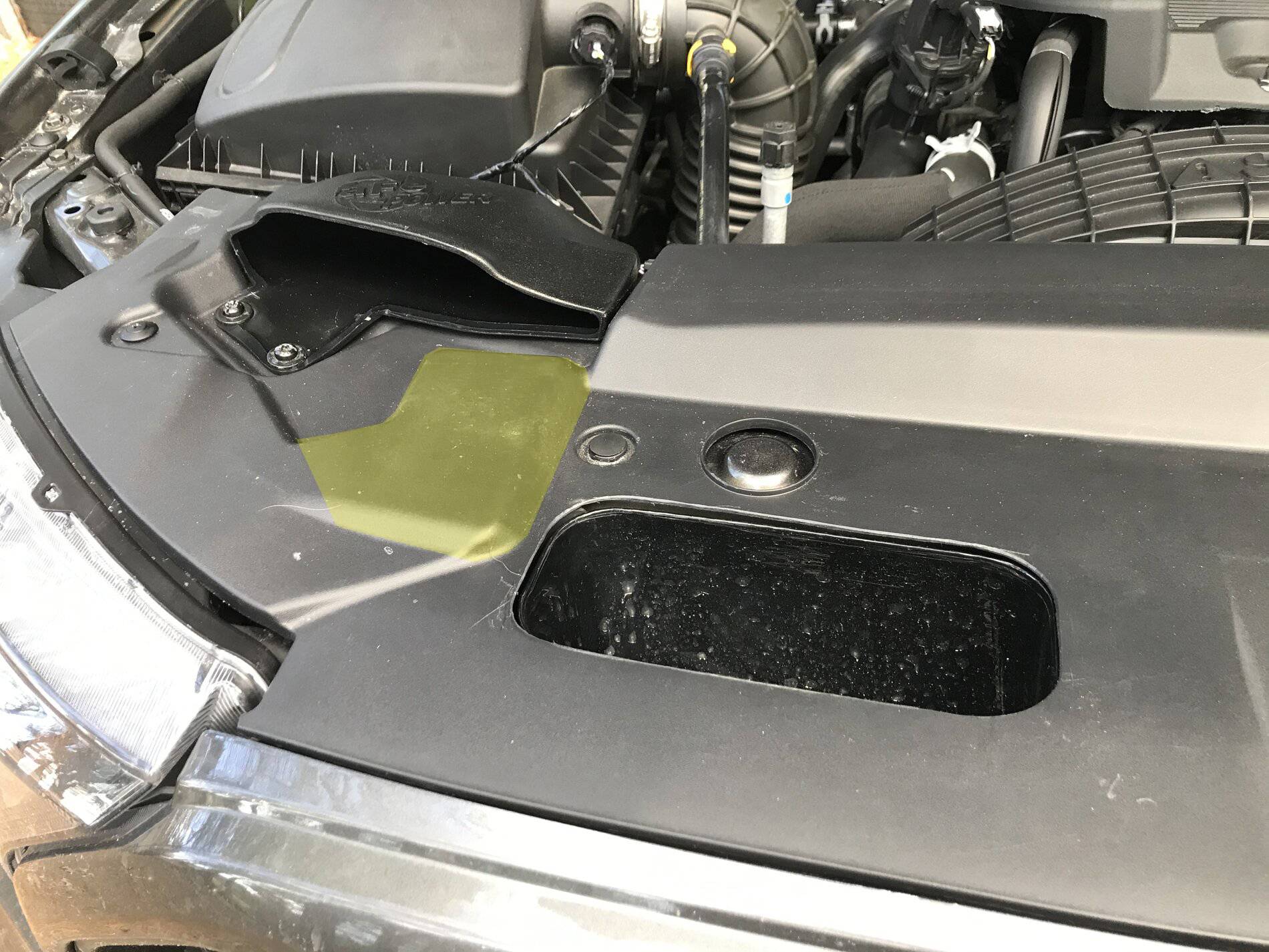

Also makes no sense why the 1/2in hump between the cowl air hole and the snorkel which narrows the airflow space between the hood and the cowl down to a measly 1/2in slit. It’s there to keep any intake noise down, same as other manufacturers building resonators into the airflow path. Ford just build it into the design of the cowl vs making it flat. So I remedied that with some kydex.
What is underneath that section of kydex? Do you think it would be possible with a heat gun to massage the OEM plastic down rather than cutting?
There is some structural metal and airspace. Given the thick nature of the OEM plastic, I don’t think heat gun will make it malleable like kydex vs just burning / melting it. Also given the bulbous nature of the hump I don’t know how well it would flatten.
