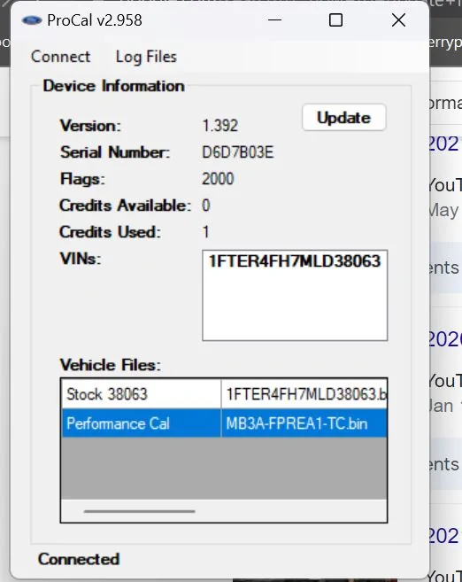

2023-02-03 12_55_17-how to update ford performance tune 2021 ford ranger - Google Search.webp
This is from today, it did update again. This time, I actually reflashed the truck.
FWIW, day before yesterday I plugged in my ProCal to see if anything had changed. The ProCal software on my PC updated, then it updated the firmware on the ProCal device but no update to the actual tune file.
I have been running an Unleashed tune for almost a year and have not touched the ProCal, so there has been no updates to the tune file in almost a year.
