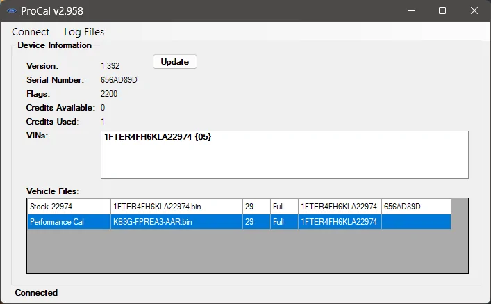

I was inable to get new version and gave up after numerous back and forth with FP techs. I did reload the original v1.388 FP tune tho after going back to stock when gad prices spiked. I'm still enjoying the tune just not the 93 octane prices. Commuting 80 miles each day I average 25.6 mpg so overall not bad. No hills mostly highway speeds flatlander.
The 1.388 you see listed next to Version in the ProCal software window is the firmware version on the ProCal device, it has nothing to do with the version of the tune file you load onto the Ranger.

Funny story. So I just plugged in the ProCal again, and it updated AGAIN from a few weeks back, and I decide yeah whatever and try and flash the truck anyway. Turns out it loads the tune like a new one. I'm wondering if by chance my first FP tune was AR and the new one for 2019 is AAR and I didn't notice. LOL! So anyway different MY clearly have different tunes because mine is 100% sure up to date.

Isn’t the version listed in that screen?
What you see as version 1.392 is the firmware on the hand held ProCal device. The v2.958 in the header is the version of the ProCal software on your PC.
If there was a revision to the tune you would see it in a change to the tune file name.
I originally installed the FP tune in August 2021 shortly after getting my Ranger. Any time I have checked since then there has been updates to the PC software and to the hand held device firmware but no changes to the actual tune file.

So I just plugged in my ProCal since late march 2022, and I didn't see any change in the file name, KB3G-FPREA3-AAR. My Ranger is a 2019.
