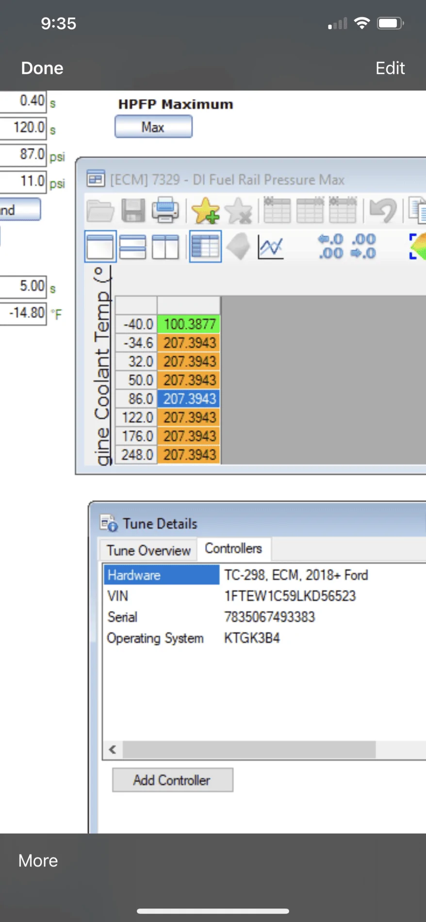

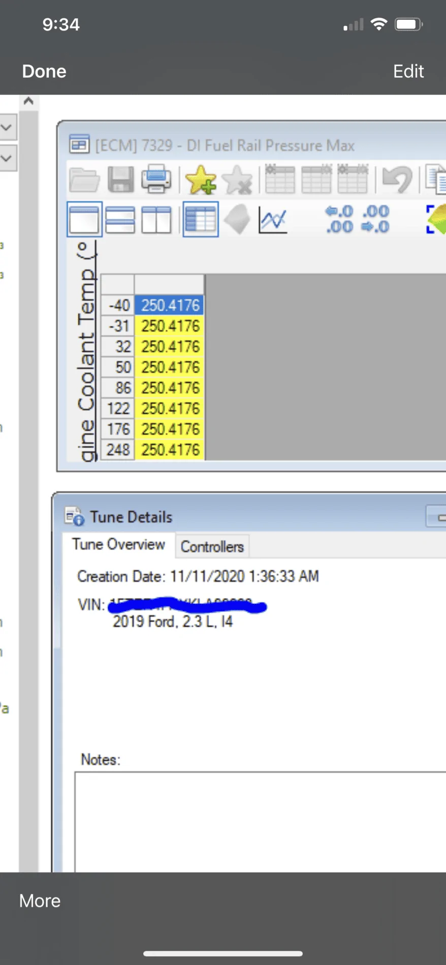

Ranger hpfp is a better option than f150 flex fuel hpfp. F150 can handle e85. Ranger hpfp can handle e85. Note in the pictures the stock hpfp at 250 bar on the ranger and 207 bar on the flex fuel f150.
stock injectors pretty much get maxed out from tune and e85. Want bigger injectors? You’ll need the upgraded hpfp.
