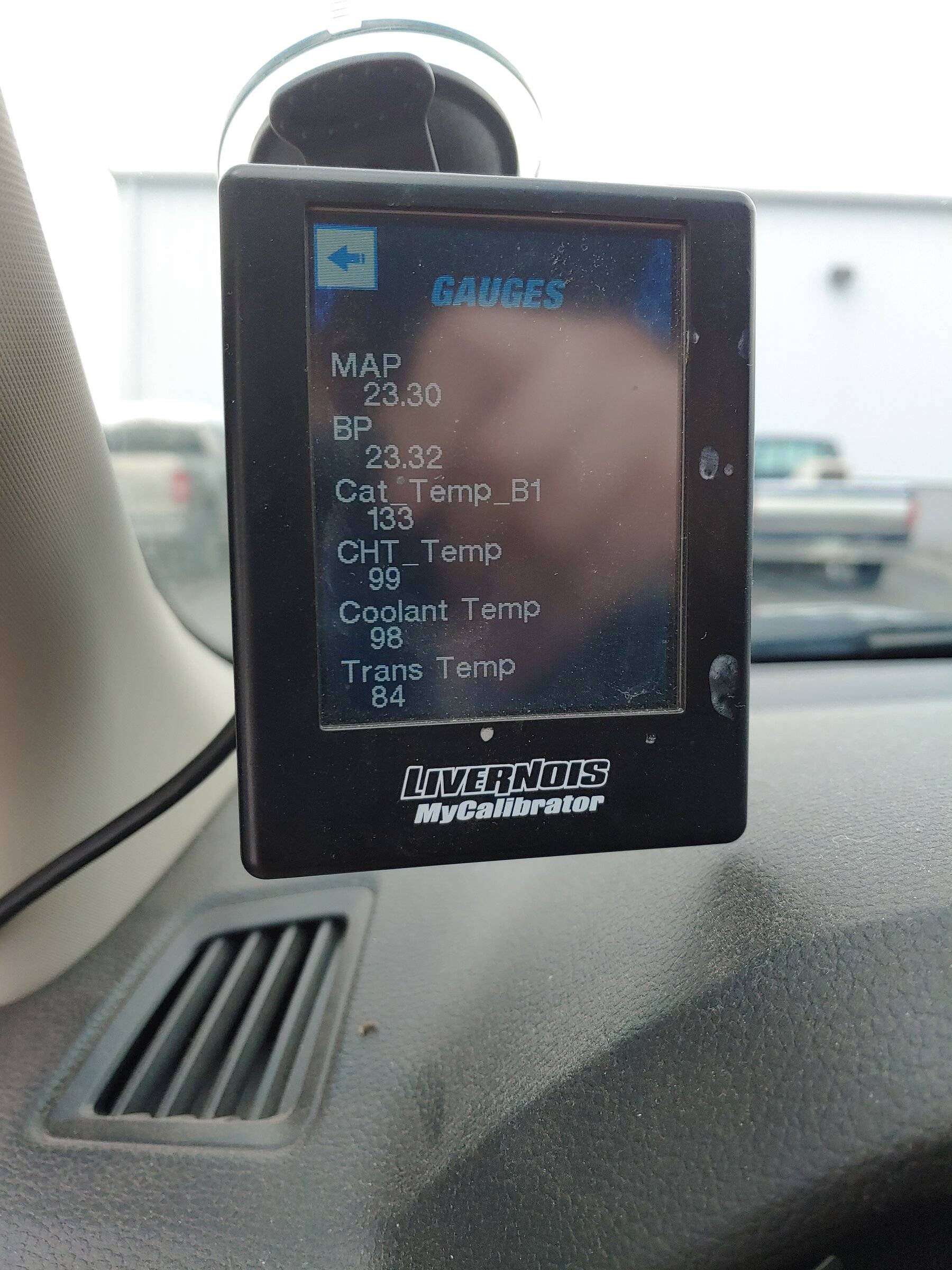

I wouldn't be suprised if it gives what you want. I myself went with Livernois and really liked the data I was able to get(even though I wish I saw the PSI reading for boost).
I myself would monitor Coolant temp, Cylinder Head temp(both are great to see if you have a coolant leak before its too late) Transmission Temp, Catalytic temp(calculated but better then nothing) then manifold pressure with barometric pressure for boost reading.
For me that worked well since I wasn't concerned about other things.
Here is what I would normally see with the my touch calibrator(and yes I understand you are set on Unleashed)
