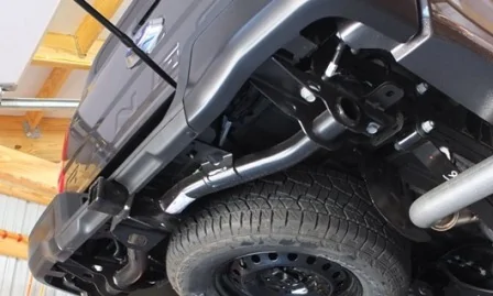

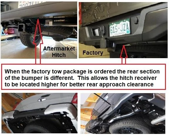

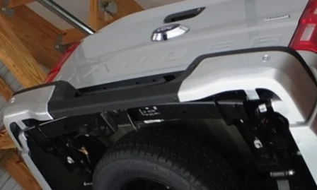

To reiterate what was previously shown earlier on in this thread, the rear bumper center section is different when your truck has the factory tow package.
It's modified to move the hitch receiver up higher, thus giving the truck a better rear approach angle.
I'm surprised they don't make note of this on shop.ford.com?
