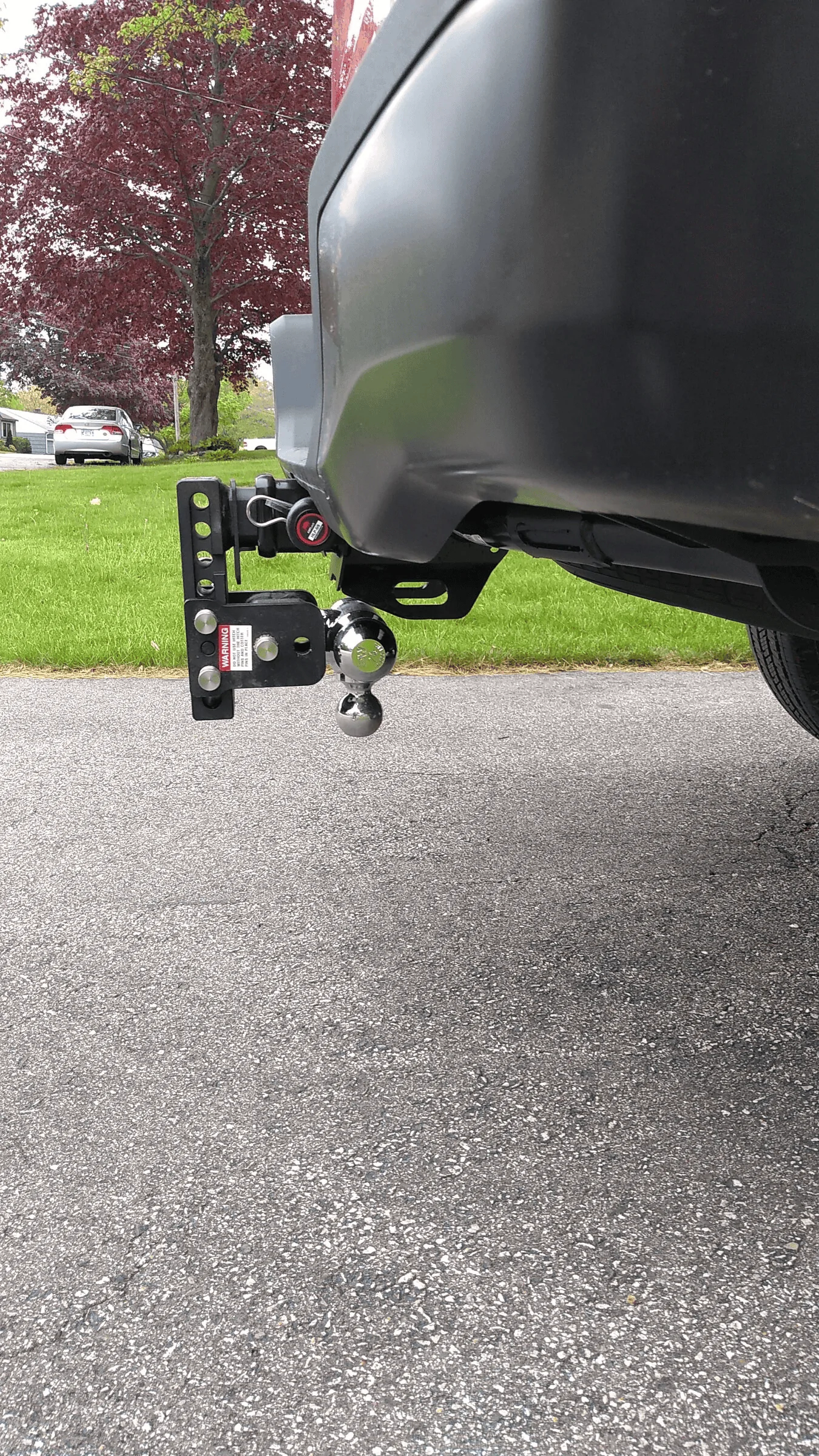

Small utility trailers would look extremely comical pointed at the sky hooked to the stock bumper ball. I had to install a 5" drop to get mine close to level. I'm sure it's for small boats which are usually pretty tall anyways.

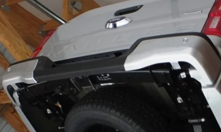

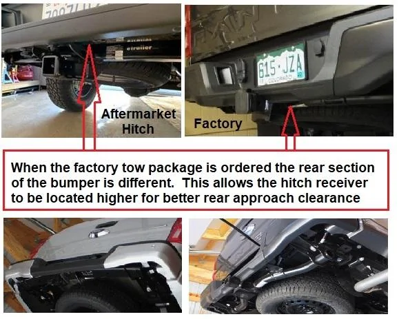

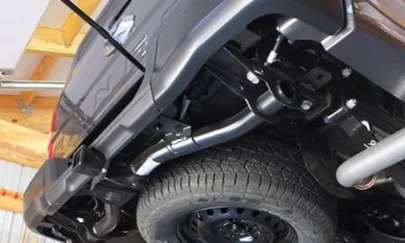

But from what I've read there isnt any difference between a truck with or without it besides the hitch itself and the 4/7 pin connector.
Old thread.. but just to be clear in the event a prospective truck buyer is reading this thread, the rear bumper center section is different when your truck has the factory tow package.
It's modified to move the hitch receiver up higher, thus giving the truck a better rear approach angle.
If you buy the oem hitch that's one of the parts in the box. If you get an aftermarket hitch, they're pretty much always lower than oem (so they don't have to mess with the bumper).
I've got a 5 inch drop too.
