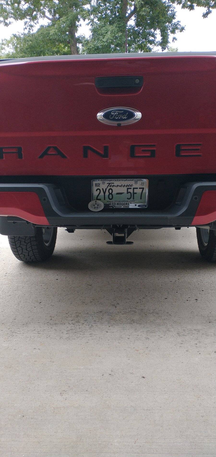

I'm going to go with aftermarket draw tite and install it myself. Too many dealers charging too much for labor. If I DIY it I'm only out $120 for the hitch and $120 for the harness/sleeve. All in still costs less than the factory hitch. From what I can gather there is no real benefit to the factory hitch other than 2-3 inches higher up which only affects approach angle and visual looks. Since I don't plan on doing any off roading I should be just fine with the aftermarket version.
I installed the aftermarket hitch and you barley if at all see hitch except of course the receiver.
IMHO, the factory bar is a waste of money.
FYI, The bar you see on the far left is NOT the Hitch, but part of the bumper frame.

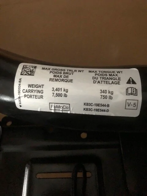

For those looking to add the OEM hitch, I just purchased the Trailer Tow Kit Accessory (KB3Z-19D520-A). This kit includes the parts Simon mentioned above, and the bumper/tow hitch appears to be the same exact rating as the KB3Z-17D826-F. The kit cost ($278.46 from Tasca Parts) was less than the cost of the bumper/hitch alone ($488.01). Below is a photo of the rating label on the hitch.

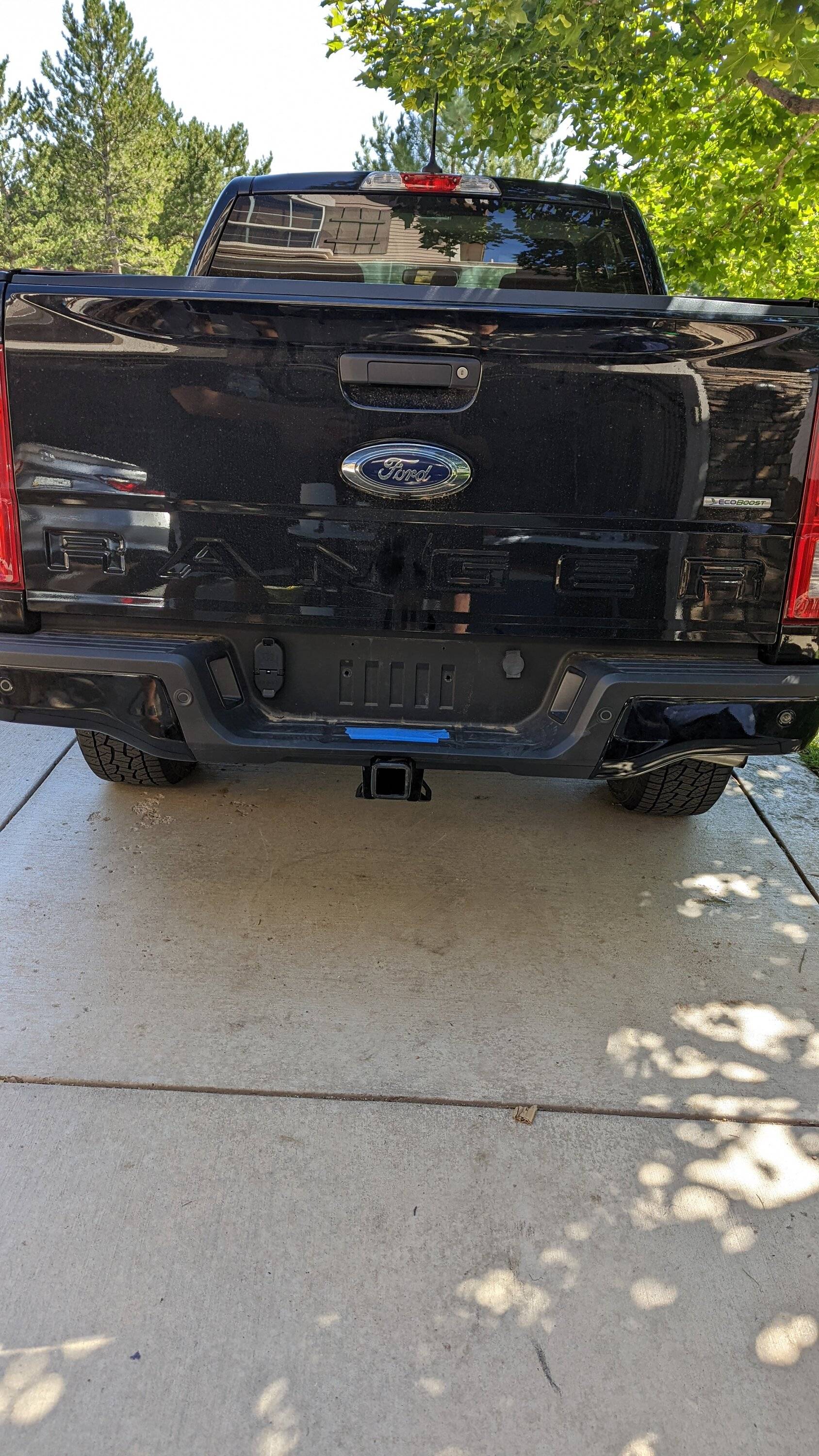

Thanks bro. Installed it today. I broke a ton of clips, just like everybody else. Besides knowing it's imperfect, it doesn't seem to matter too much.
I also had to bend some things to get bolts to line up. Not sure if anybody else had that problem...
To cut the hole for the 7 pin, I just melted it with an old soldering iron and good ventilation. I had to clean it up a little with a chisel to get the outer surface flat, but it was pretty quick.

Excellent job Kyle! Looks like the factory install. I believe that many are intimidated by the number of steps in the instructions, but it’s really easier than the instructions make it look. Glad it worked out for you.
