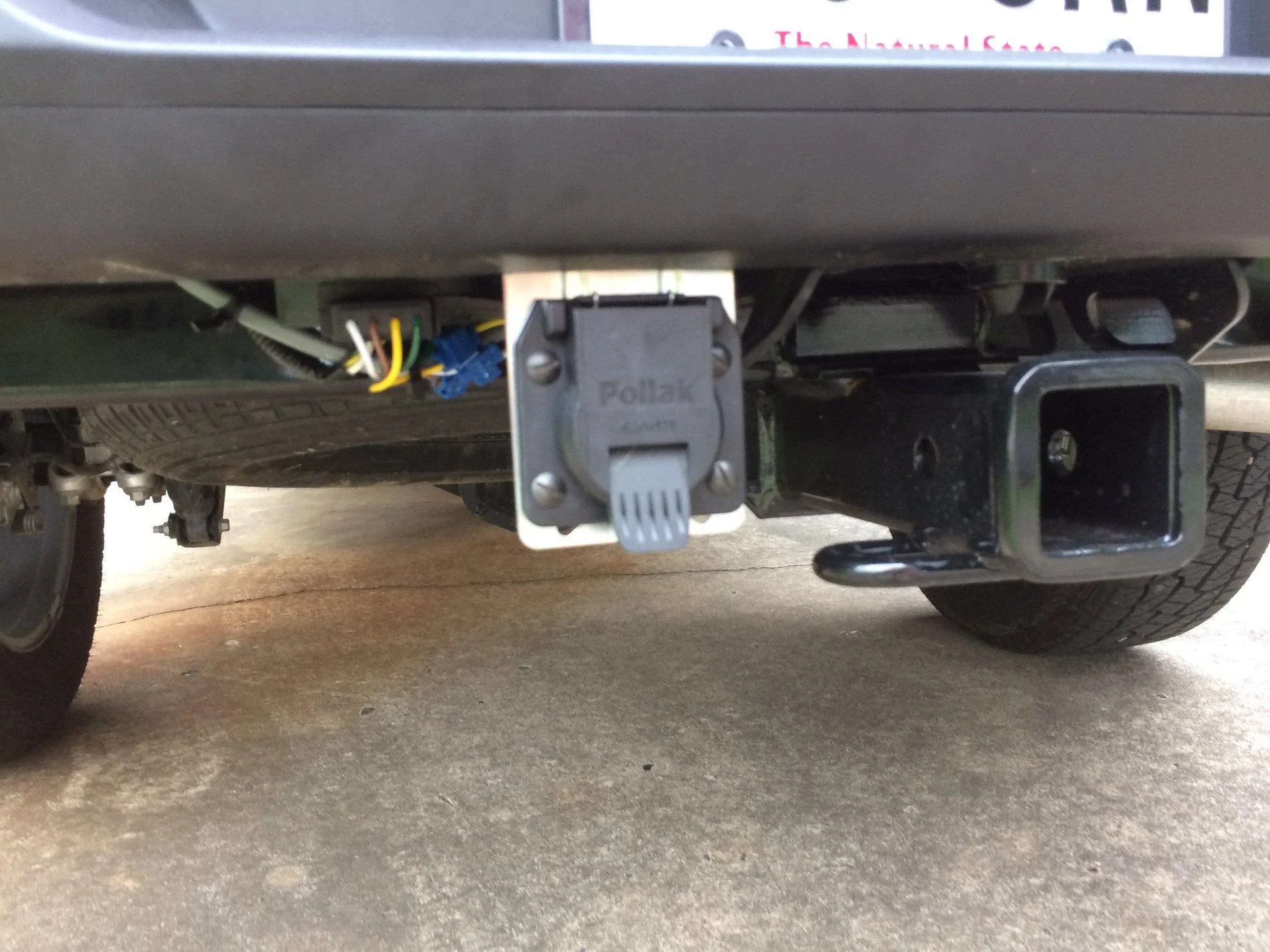

Just ordered Curt hitch 13417 for my Ranger. Got it through Amazon and my wife had points I used $131.79 free shipping now the wait begins.
Vandave
Jan 13, 2019
30
Vancouver
2019 Magnetic Ranger FX4 Lariat
Bought the Curt hitch from CarID. Install was pretty easy

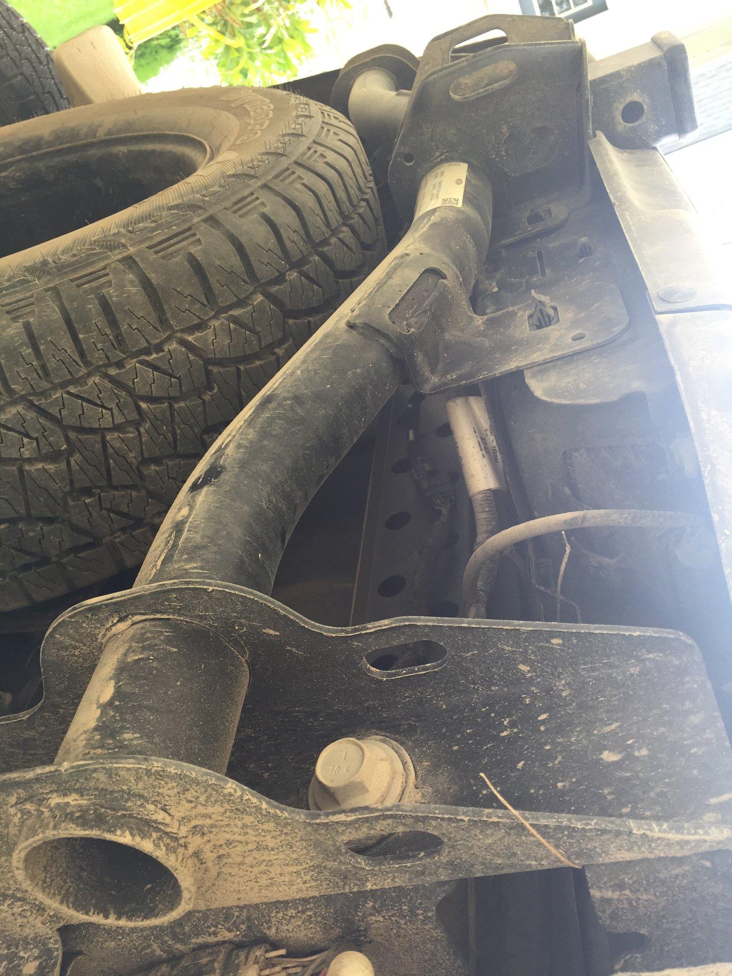

For anyone that installed the factory hitch, is it possible to install it without taking the bumper off like the directions say? I don't see why you couldn't unbolt the existing trailer hooks that are on the trucks without the tow package and then just bolt the new trailer hitch to the frame.
Jason L
Jan 28, 2019
111
71
Mount Pleasant, SC
2019 Ranger XLT 302A
For the factory hitch, it is the bumper. It is a solid metal piece that connects to the lower frame, and is all of the metal in the bumper, in one piece. You remove the old bumper, swap all the plastic pieces, sensors and lights from the old to the new bumper, then put the bumper back on. So you don't just take the bumper off, you replace it.
t4thfavor
Chance
Feb 5, 2019
2,607
2,358
Nope.
Nope sortof... It's definitely affixed to the bumper. but not welded in any way. Just bolts all over the place that hook to the back of the bumper.
Pluto
Zach
May 25, 2019
Oklahoma
2019 Ranger XLT
Nope.
What hitch is this? Do you have a link? I like the tubular construction.
